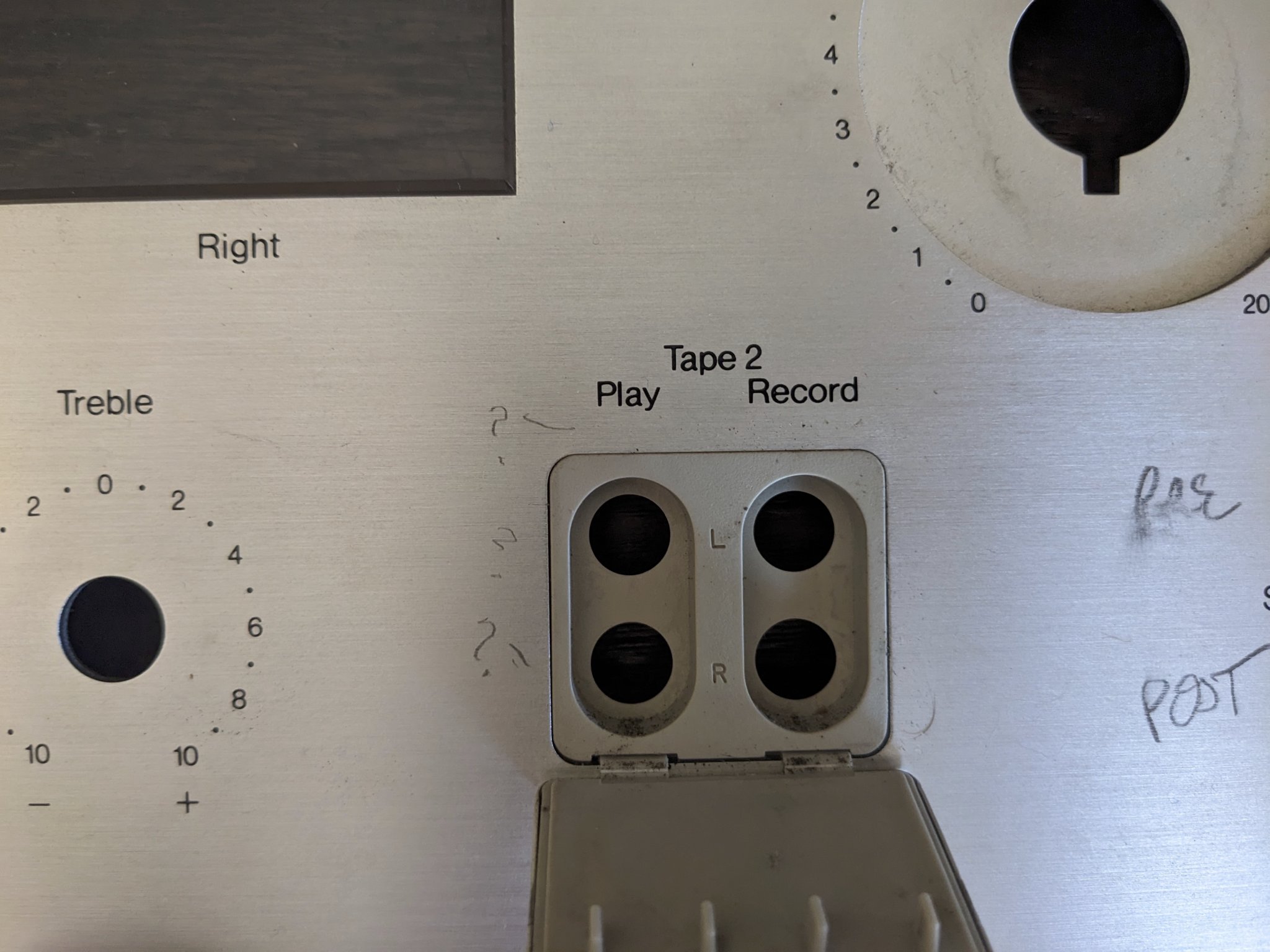

i thought about that. My plan was to repurpose the front av2 input/output (~36mm square). I think this could provide a window for the antenna.
scratches not mine....but they appear to come out quite well with one of those magic eraser sponges. however...i am thinking about if it is a good idea to sand down the front so as to be able to relabel.

Hi ICG,
I am not sure what the physics concern you have would be? Can you please elaborate?
It is abosolutely true that the cheap, off the shelf options (https://www.data-alliance.net/antenna-2-4ghz-2dbi-directional-patch-adhesive-mount-w-rp-sma/) are a couple of mm too wide. But can't I enlarge the cutout in my faceplate?
Or, are you implying that I am incapable of soldering a ceramic chip antenna? (not a bad bet). But, while I haven't looked, these certainly fall within the 36x36 existing cutout (for example: https://www.taoglas.com/product/wlp-2450-25-4-a-02-2-4ghz-bluetooth-wlan-zigbee-patch-antenna-25mm/).
I don't see why either of these options would not work hidden behind a smoked polycarbonate window or other such facing material.
Am I missing something?

Sure. A metal enclosure blocks high frequency interference. That's good. However, BlueTooth is dependent on having communication on the 2,4 GHz band. If you have your BT receiver within the enclosure, it will not be able to communicate with any BT device. So that makes the good enclosure for the amp bad for the BT device. And if your amp is the device that's the BT receiver, you can't have any shielding of the amp at all because that's preventing it from its function.

Wouldn't putting the ground plane for the rf behind the window basically keep the seal "rf tight?"
Your concern is noted, but I don't see the same challenge as you. I feel that my metal work is at the level of creating effective chokes around any gaps I create.
However, I still think the look of the black "glass" acting as a receiver on my 70s face will make it look positively modern, indeed. Also like it came with an IR remote!
And I know I am not the first one down the path of moderinizing these old faces. If you are correct in that his is a physical impossibility, then I will feel very good when I have a solution to post.

Of course a closed metal casing will make the BT stuff not functioning right. Faradays cage. Simple stuff.
What I see is some brands cut out a piece at the front and replace it for plastic. Or they use a display with enlarged window and place the BT modules antennas behind it. Or they simply use an external antenna (most effective and simplest!). Or they have the module at the back of the device covered by a plastic cover which I think is worse as then one can be sure that dreaded RF straying in on mains cables, interconnects etc. In short: there is a need for an opening in the metal casing for BT antennas signals when using an internal BT module with PCB antenna.

I think your idea, putting the BT antenna behind the door for the tape connectors is worth a try. Just fix the door and put the antenna behind it, using some thin tape. If it works you can permanently glue it all up. Maybe try to do that with a complete BT module and put a shield behind it. I have some small, 10$ things that work remarkable well. Just got to find the antenna side by experimenting or opening it up.
