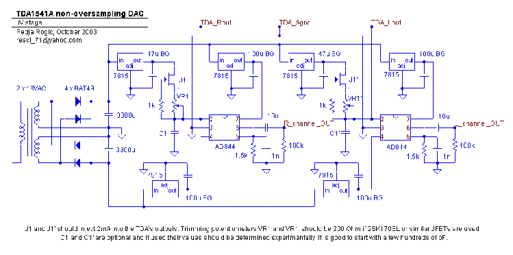

I just finished building a TDA1541A based DAC using Guido Tent's clock and Pedja's AD844 IV conversion (schematic below). However, upon start-up, I noticed that there is a crackling sound in the right channel during loud passages in the music.
After about 20 minutes of playing, the crackling disappears.
I found a thread that described a similar problem and the problem was traced to a leaky output cap. So, I changed my output caps and still, there is a problem.
Any ideas?
Here's a link (the pic is not so good).
http://www.geocities.com/react_71/audio/tda1541a_dac/tda1541a_dac.htm
