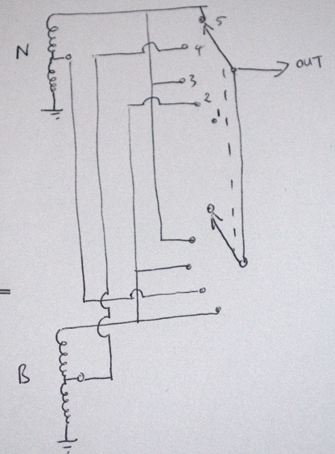

Yamaha say of their 5 way switching on the new Revstar guitars “Positions 2 and 4 slightly delay the opposite pickup for a subtle phase shift“, which made me wonder how they do it.
Here’s my guess, posn1 Bridge; 2 – Bridge + ½ of Neck PU; 3- N+B; 4 Neck + ½ of Bridge, 5 – Neck.
If you want extra herbs & spices, you could add caps in the connections between the centre ‘taps’ and the switch.
