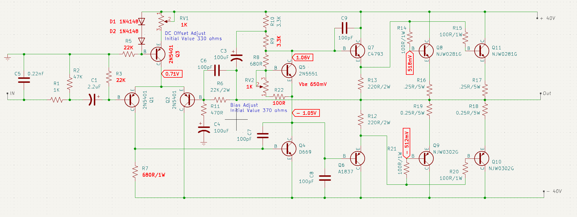

Hello, My tweeter and mid-range distortion sound like a speaker cone that has cracked. That happens when the vocals or bass are loud. The high frequencies is dominating the amplifier. Should I change the C7 100pf to 47/22pf? by the way I don't have pre-amp I'm using TDA7439 audio processor. but I have also tried with direct audio input to amplifier, still got cracker sound. but it produce more crack sound when it goes by the audio processor because it enhance more.

C5 is in the wrong position. It should be in parallel with R2.
It may be that actual build is different but if like on schematics, there is a question how well TDA7439 tolerates capacitive load.
C5 should go. Even // R2 it would short most of the audio.
And R2 isn't needed anyway.
RV1 is a disaster waiting to happen.

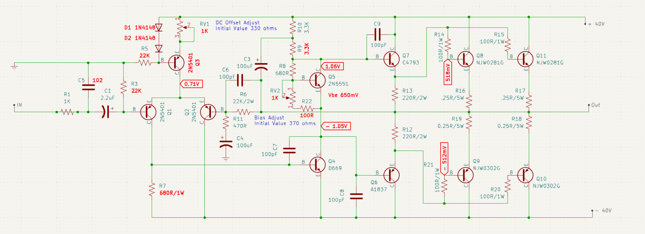

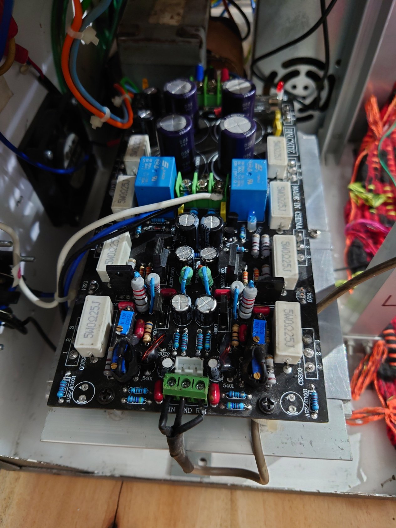

hi, I am also suspected that C5 in the wrong position but it is in the circuit board. the diagram I have drawn from the board and I made some changes which indicated in Red color. it had zener diod , changed it to LTP.

Whats wrong with the VR1?

If C5 is in the board it is likely there's an error in re-drawing it.
As drawn, it shorts the incoming signal.
If VR1 is turned to one side the transistor(s) will release the magic smoke.

I was hoping he would have thought about it, especially since it was applied at RV2.
Come this summer, offset will drift and then what?

If offset drifts it drifts. It would still drift if you used fixed resistors instead of actually using a pot.
Besides, it’s not really an “offset adjust” pot. It actually fine tunes the differential balance which is set by the ratio of the resistors in the CCS emitter and the collector load if all the vbe’s are the same. The problem is they are not, which requires some way of trimming if you are trying to enforce differential balance without resorting to current mirrors. Strict balance is not required to get it to “work”, but it sounds better when it IS balanced. If you used a matched input pair, when the DC output is minimized the two currents should be balanced - which assumes there are no other sources of offset. A true offset adjust pot would apply a DC correction to one of the two inputs. And would be used to trim out even smaller errors than this was intended to.
