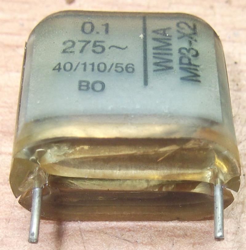

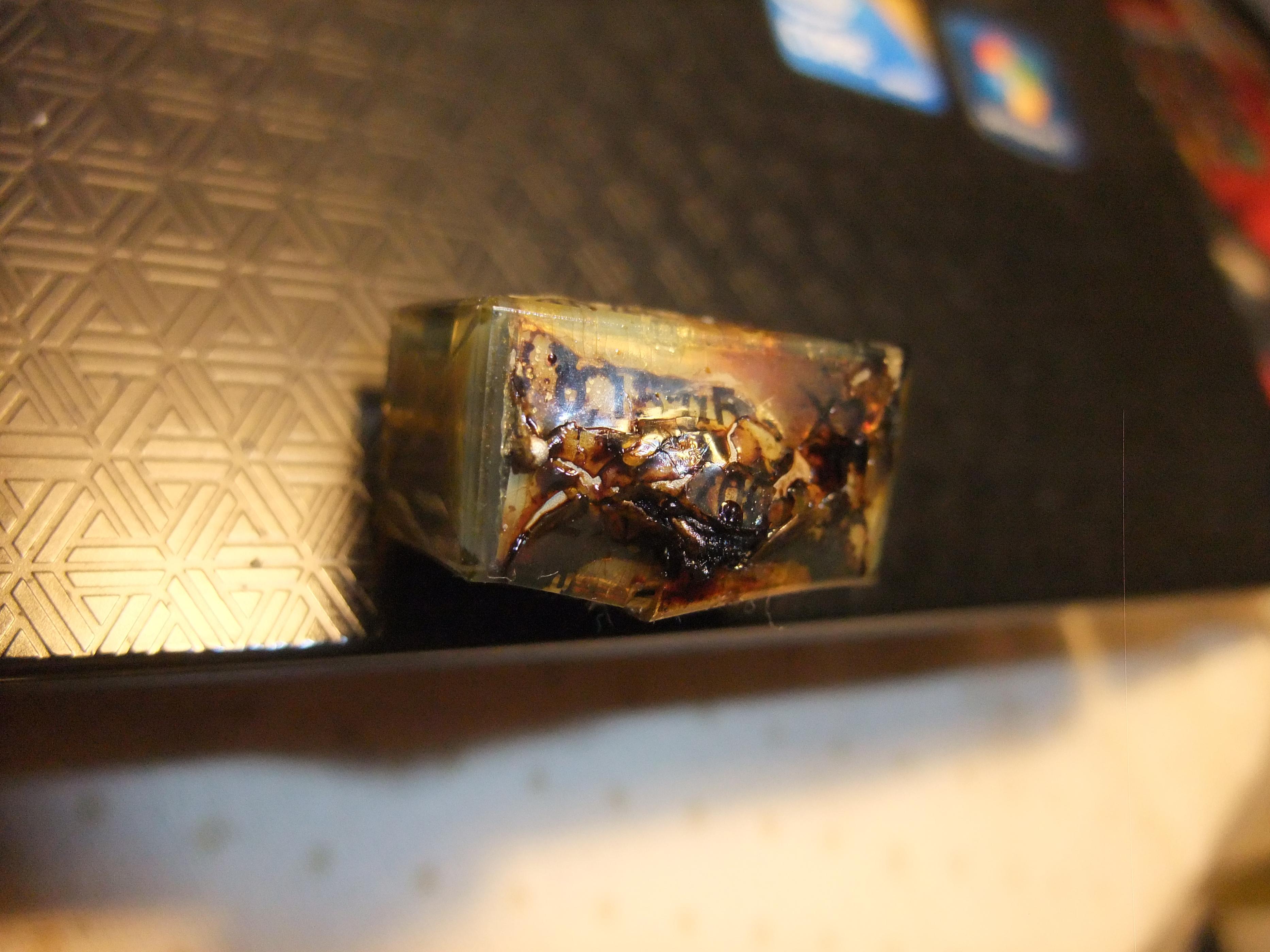

In the sixties a series of epoxy dipped capacitors made by WIMA were notorious for cracks and following isolation leakage. You could find them in all tube electronic stuff like radios, taperecorders etc. Used as coupling/-decoupling caps most of the time the were not exposed to direct ac-line and so failed to show these entertaining fireworks the Rifas were famous for later on.😉. It should be noted that WIMA nowadays do not produce any dipped caps anymore, all their caps are canned now.
Hahahahahah

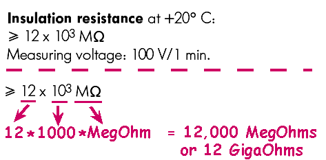

Check the insulation resistance measurement spec....
12 MegOhm Insulation resistance, measured at 100V does not seem to be very good, at all.

Before laughing you should read what you are laughing about. Then you could discover that 10^3 MegOhm = 10 GigaOhms.Hahahahahah

Yes, the datasheet is unnecessarily confounding.

Before laughing?
Excuse me Bugs Bunny, this is my area of expertise at work...
No professional company will mix exponents and units in such a way.
But yes I misread the incredibly poorly executed datasheet.
And, well, in my working experience, such items usually pass a far higher IR value, more like 50G.

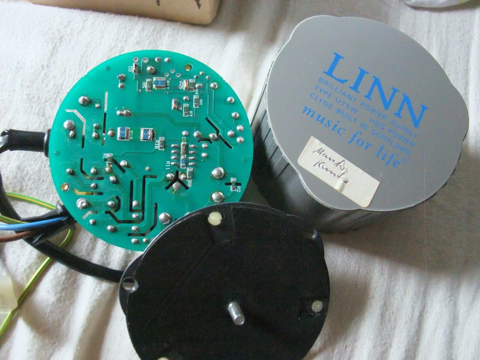

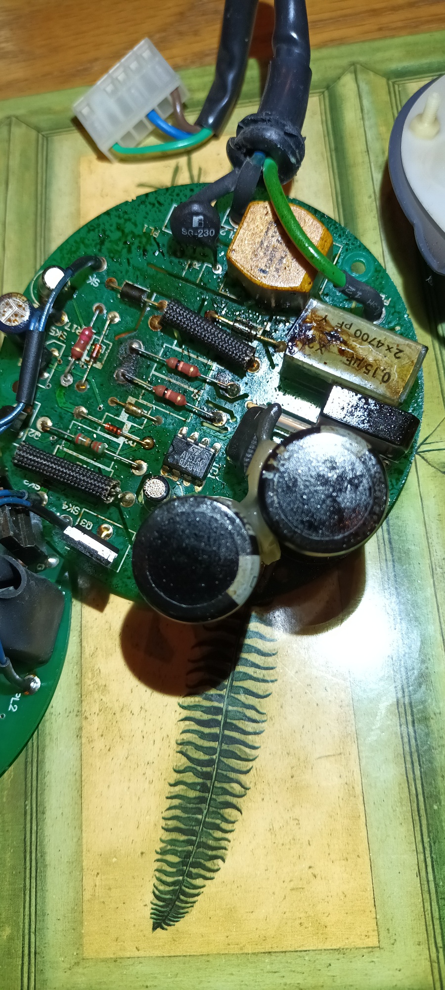

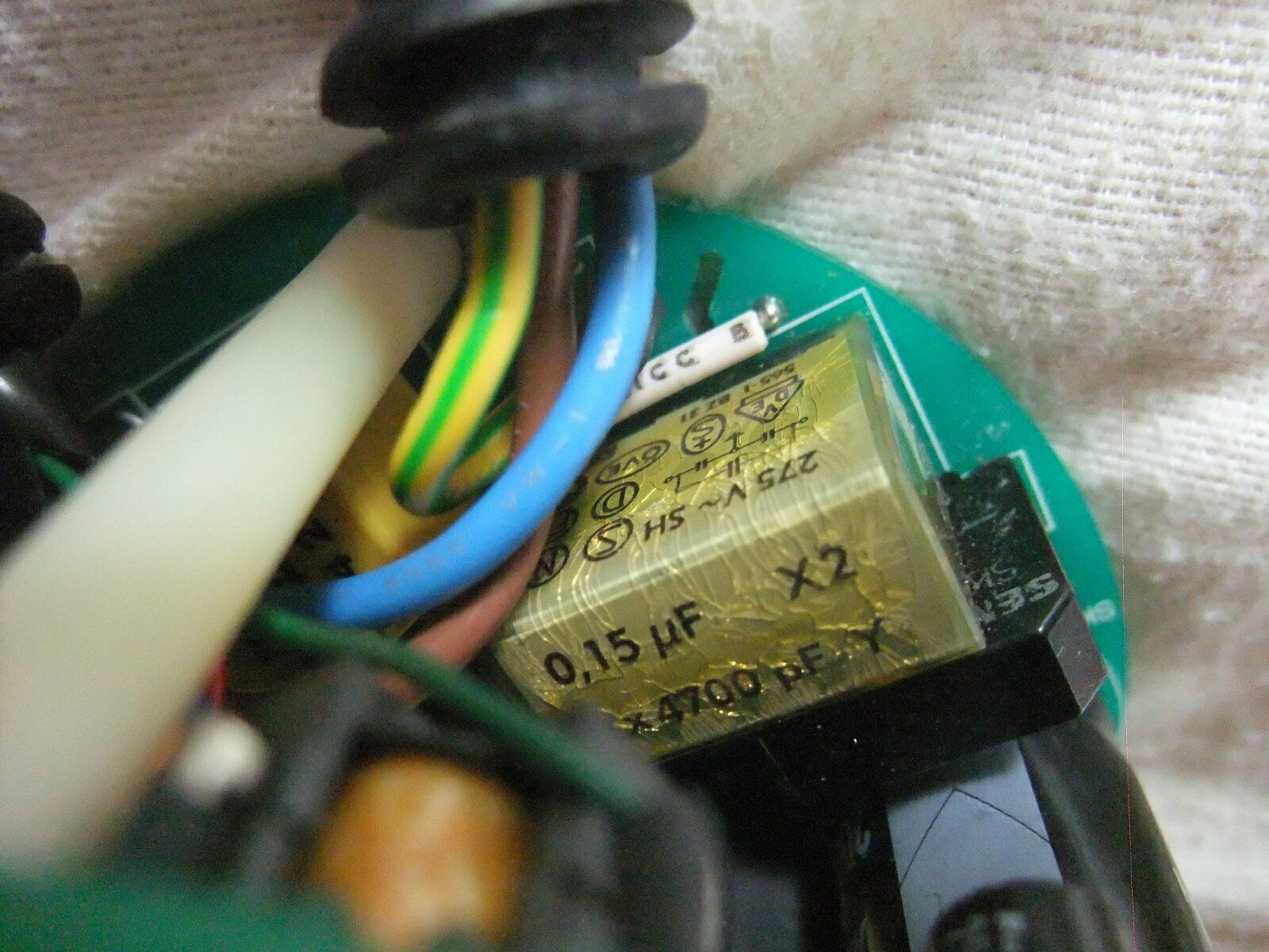

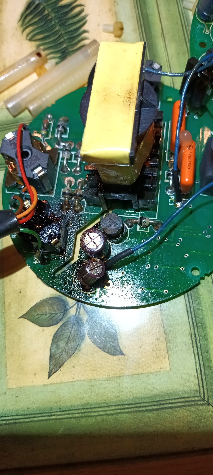

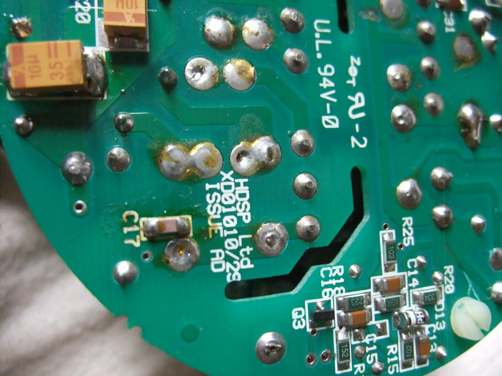

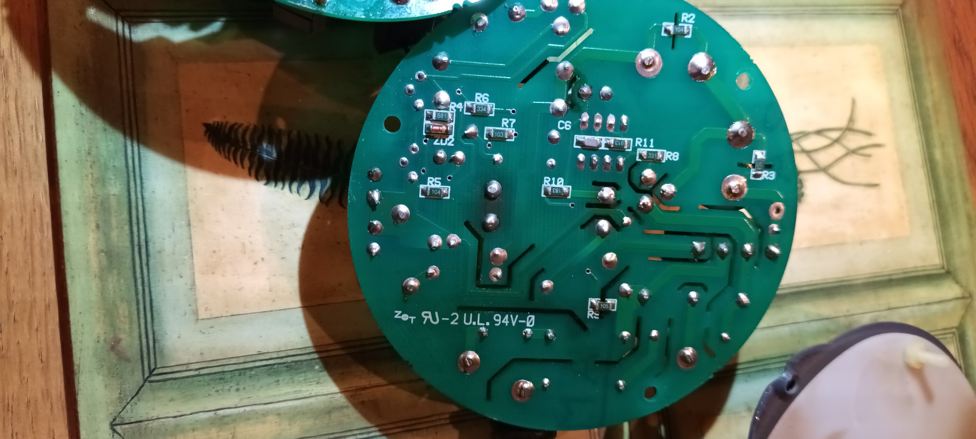

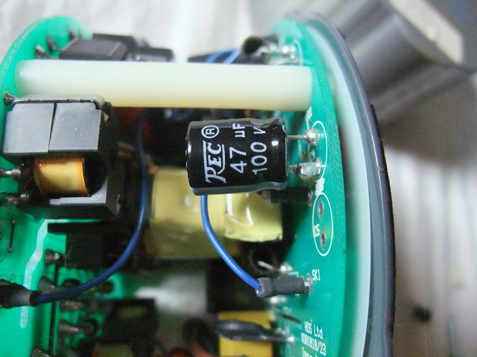

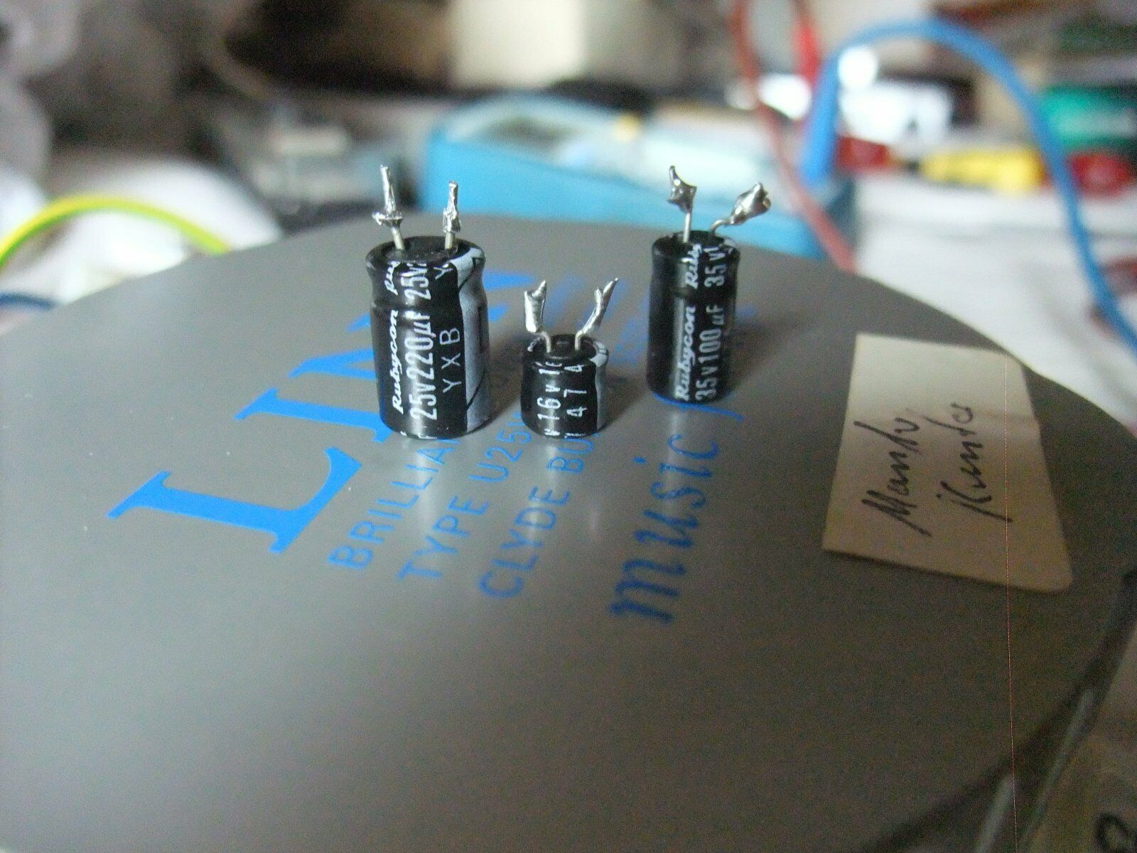

Several weeks ago I brokered a Linn pre-amplifier (KAIRN) with Brilliant SMPS for a friend. As a precaution I replaced the electrolytic capacitors, but not the RIFA X2, because I don't know about the bad reliability in general for this version at that time.
The consequence was a dissatisfied user and a lot of complaint work regarding cleaning of the two SMPS assemblies including the PCB's. Extremely annoying. The seventh image shows the same RIFA X2 capacitor than those from the last three images.

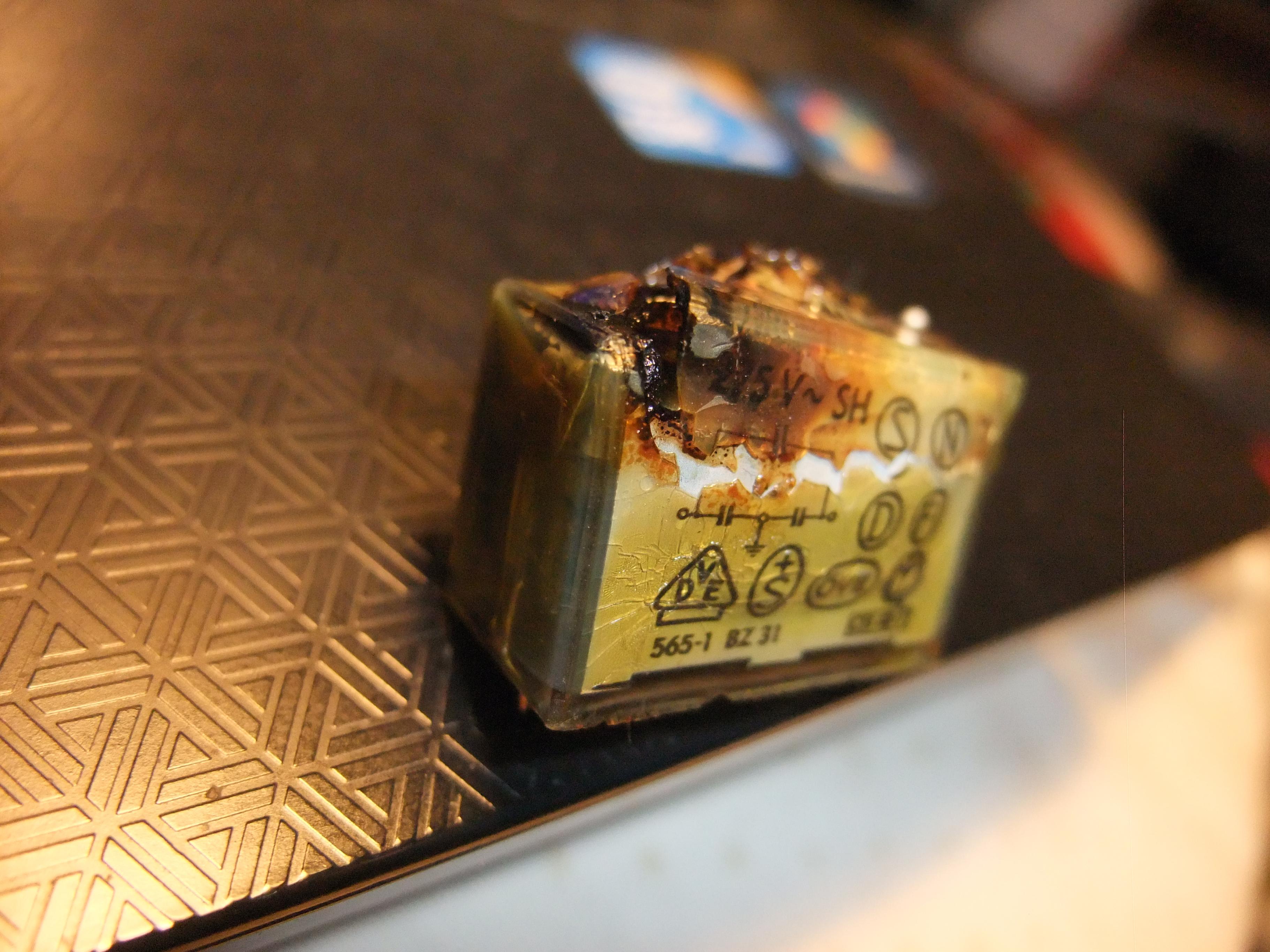

More worrying than any material damage is the fact that the X cap is part of a combo including Y caps;
A lethal combination: even if the Y caps are more robust (or less fragile) than the X cap, they could fail by proxy, if the Xcap burns and explode

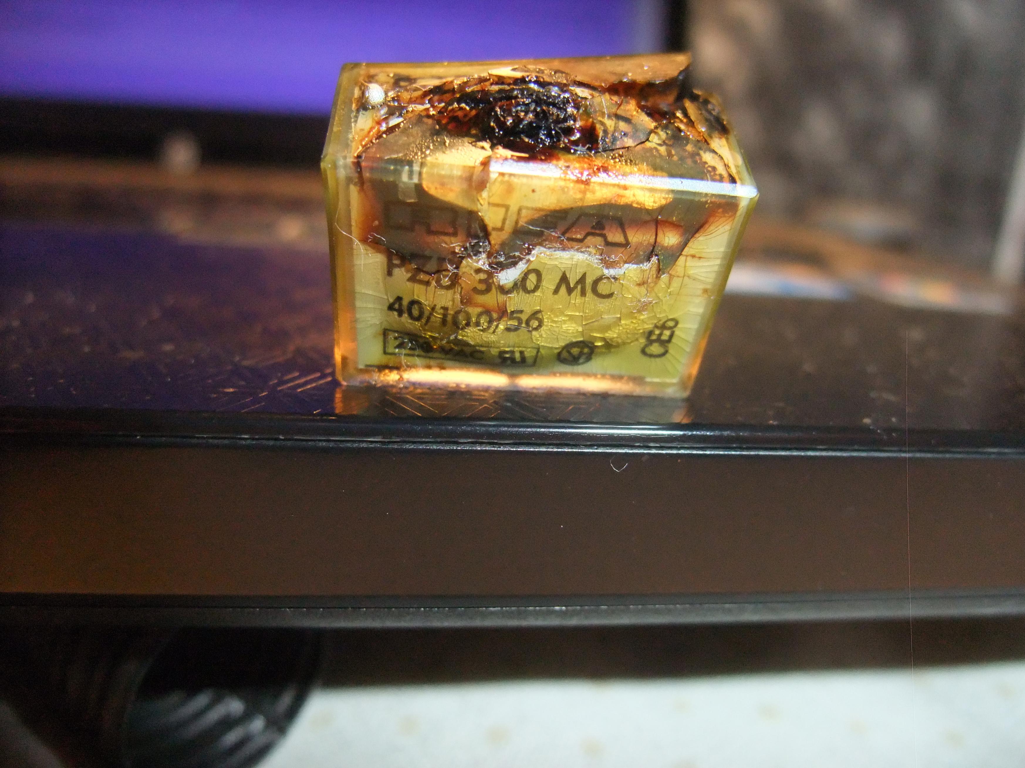

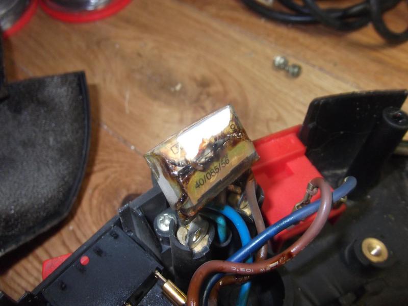

You have never experienced one go off in a vacuum cleaner.
The last photo is one that blew up without any smoke as no power was applied and it had never even been soldered into a board.
They definitely time out like ticking time bombs.

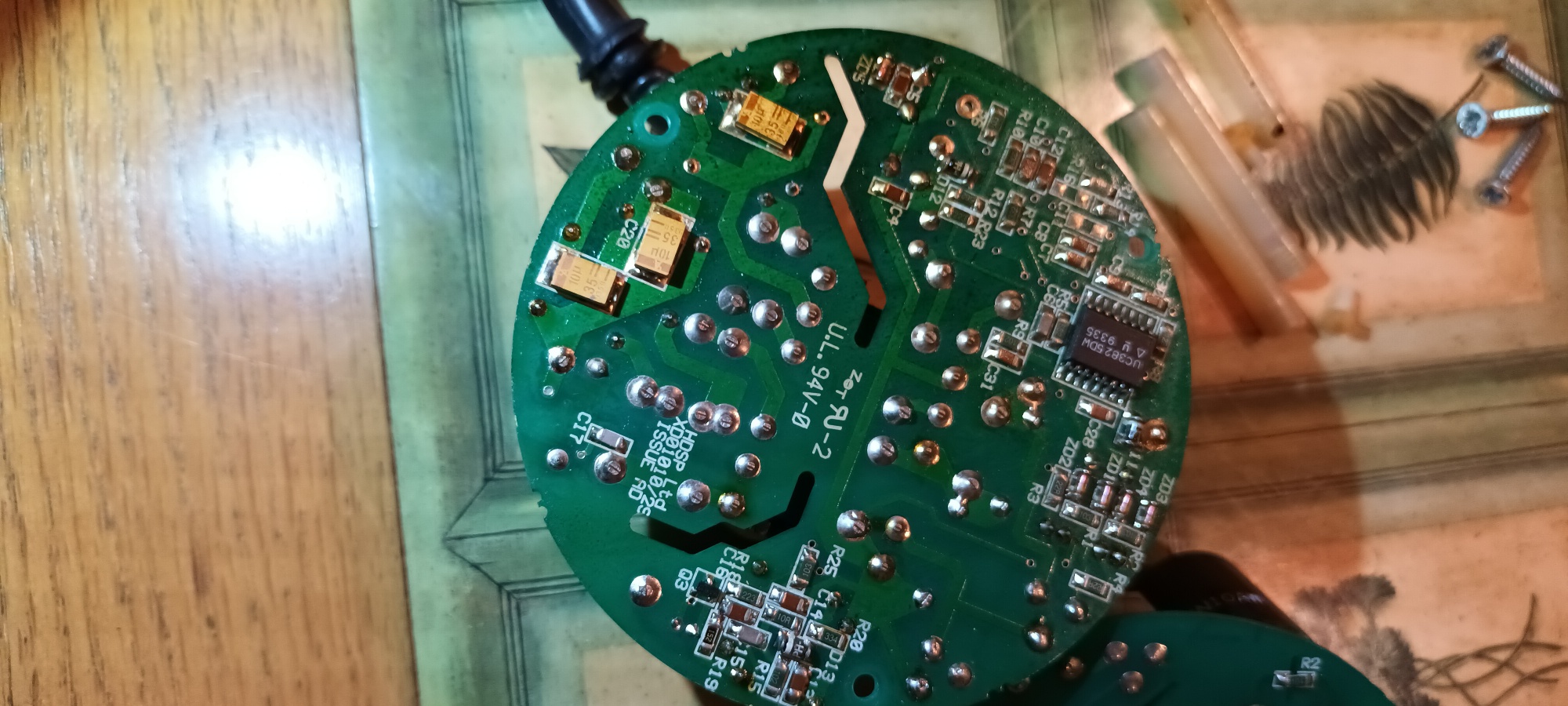

Can it be repaired
Hello all the units I have seen look quite clean. Has mine gone too far
same problem as mentioned in post #28. Desolder big parts and cables, clean the PCB's carefully, and replace also additional all electrolytic caps (small voltages by 63V versions).

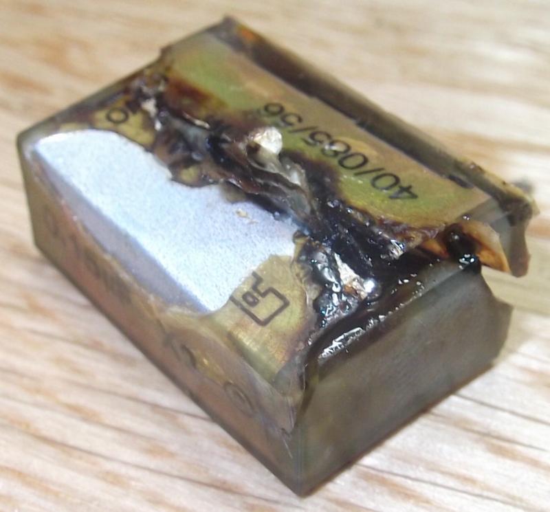

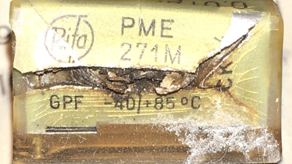

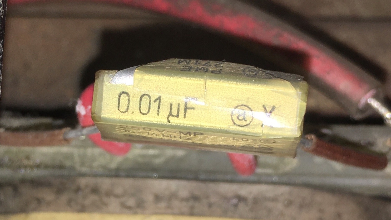

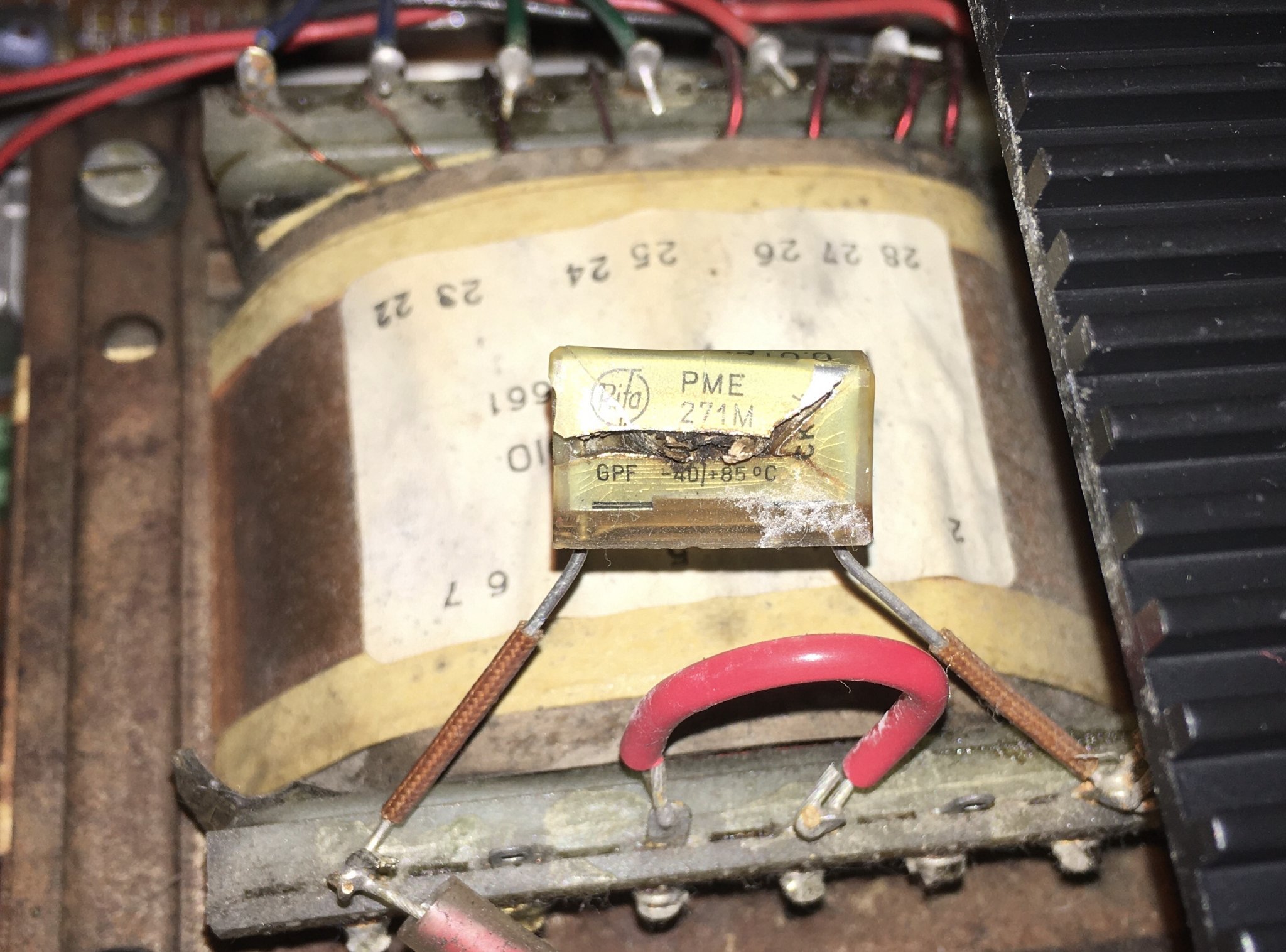

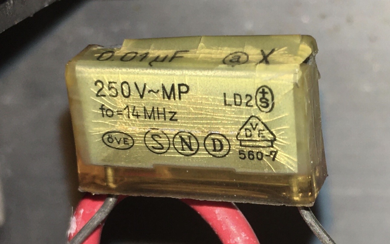

Recently bought this Tandberg TR2060 off eBay.
When I've got it it made popping sounds and then the protection relay would kick in. Removed the lid and noticed loads of rust on the push buttons springs (previous owner lived by the sea) so I thought it must be the rust inside the tape / speaker slector button contacts. I've proceeded to removing them but then I've noticed this Rifa PME271M 0.01uf fo-14MHz 250V on the power adaptor that was blown off. Now I'm thinking this might be the reason the protection relay would kick in.
Had a look online and was not able to find the exact same specs.
https://www.ebay.co.uk/itm/134072668614?var=433515813863
This one seems to be ideal but it's PME 271Y and not "M". Does it matter?
https://www.ebay.co.uk/itm/302811692750?hash=item4680fbbece:g:hoYAAOSwzq...
This one is the correct number model but the voltage rating is 275v instead of 250v
https://www.ebay.co.uk/itm/371162677948?hash=item566b0502bc:g:e78AAOSwev...
https://www.ebay.co.uk/itm/165494642493?hash=item26883fd73d:g:bRkAAOSwcs...
This again "suppression class Y"
Does Y or M matter? Does the MHz rating matter?
As I understand from this thread Rifa capacitors are not that reliable.
I would be really grateful if someone could drop me a link for a suitable replacement for this cap.
It looks fine but shows as out of stock for me. These caps are not critical apart from having to be safety rated.
You can just snip the old one out for now, it doesn't need it to work. M can mean 20% tolerance (not critical here) and MP could be Metalized Polyester (the type).
https://cpc.farnell.com/vishay/bfc233620103/capacitor-class-x2-0-01uf/dp/CA07137
These infamous Rifa caps have a long lasting bad reputation for exploding. Replace it with any other brand, do not stuck to the originals.
