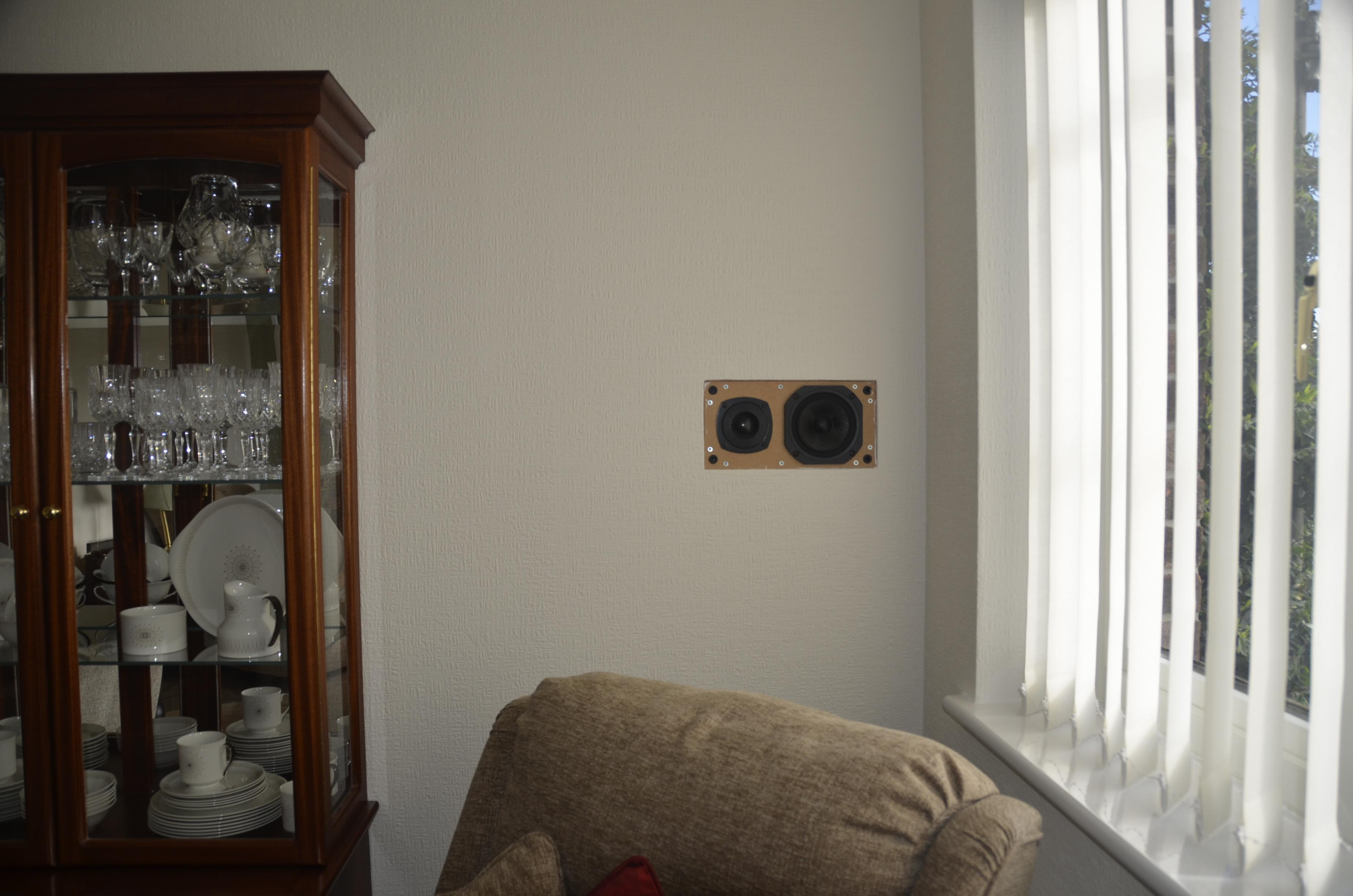

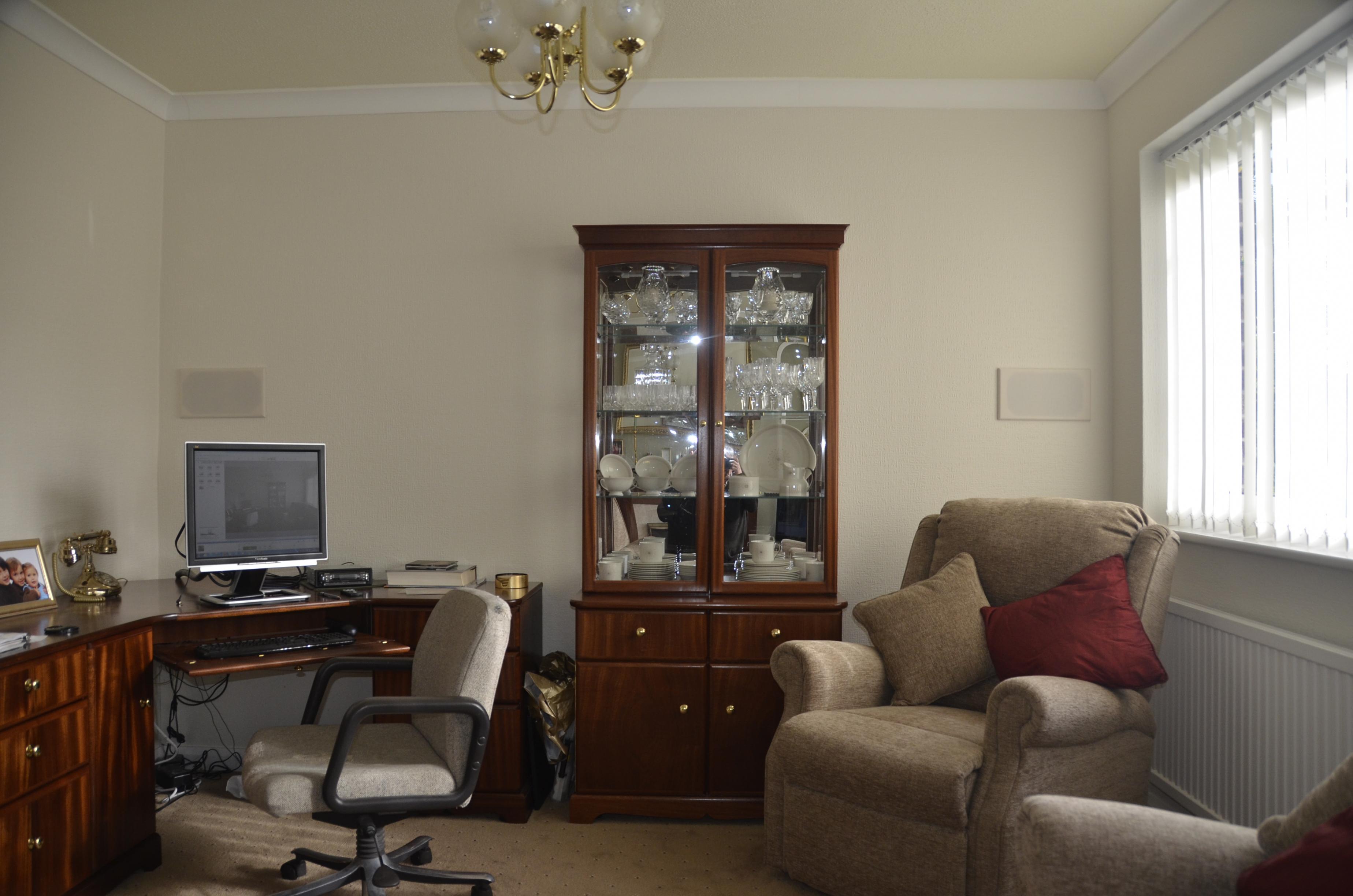

I believe that horns are very worth the inconvenience of their outrageous size - but sadly it isn't my opinion that counts. So, employing a degree of subterfuge, I hid mine up the end of the lounge where no one would notice. To achieve this I first designed them to be very thin (150 mm or so) and then decorated them to look like the wall. As the 1st picture shows, apart from the drive covers, the finished horn is pretty much 'invisible'.

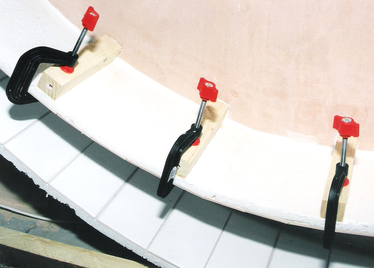

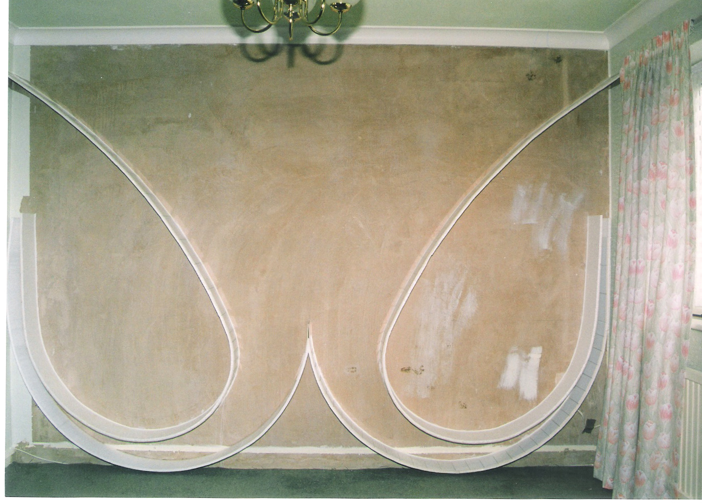

The 2nd picture shows it under construction, 'fences' of 150 mm ceramic tiles, fixed edge on to the prepared wall, define the horn profile (mine is bifurcated). The tiles are backed by an 'armature' of expanded polystyrene for rigidity as shown. Sheets of plasterboard the width and height of the room covers the front with a full width 150 mm deep slot, 100 mm down from the ceiling forming the mouth. Small throat boxes of HDMDF house the Audax 130 carbon speakers. Finally the plasterboard is completely wallpapered including the mouth and finished to match the décor.

Neat stealth install- the compression chamber seems very big though. Do you notice any noise from the wallpaper over the mouth?
No issues with the wallpaper, badman, it was a bit of a risk I know but it does work well. I think the mouth pressures are much too low to excite it – you don't see the slightest vibration or movement of any sort at all.

The speakers, Pano, are in compression chambers attached to the throat ends. Made from tiles BTW not MDF as I said earlier – only the baffles are MDF. I don't have a construction picture of them but you can see the left speaker minus its grille in the pic below. The throat enters the chamber behind the lower right grille popper.
What made you decide on tiles as a material for this purpose - aside from convenience ?

You can produce a very accurate profile with tiles plus they come in a wide range of sizes, are readily available, easily worked, acoustically dead - and they're cheap. I think I first saw them used on Kappelmeister transmission lines.What made you decide on tiles as a material for this purpose - aside from convenience ?

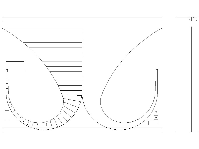

I don't get it - is the mouth a large wide rectangular opening at the wall ceiling interface and wall paper physically covers the mouth and vibrates like a passive radiator for the mouth?
Nearly. Attached to the ceiling is a full width 100mm plasterboard 'wall' that supports the polystyrene coving. It also provides a fixing for top of the wallpaper. The mouth is the gap between this 'wall' and the main front plasterboard - at times like this I wish I'd taken more pics.
It does perform like a passive radiator, yes, but its very much larger so its excursions are tiny - you can't see or feel any 'vibration' at the mouth.
I still don't quite get it - a sketch of the side profile would be useful. I think you are saying that a 100 mm tall panel hangs from the ceiling down and this panel is at the same plane as the main baffle wall which extends up from the floor to a gap between the top suspended panel. What is the width of this mouth gap? The gap is covered with polyethylene plastic over which you attach wall paper. This membrane is the passive radiator for the horn mouth and because it is so large the vibration displacement is very small. Indeed it must vibrate and you should be able to feel the vibrations otherwise no sound would get through. However you did it - it is completely invisible to the eye - especially with the addition of the crown molding in the 100 mm tall piece that is suspended from the ceiling. Have you ever measured the response? I am curious what SPL levels you can achieve, how deep the bass extension is, and how much distortion is there at the sub 50 Hz frequencies.

You describe it well xrk971. The picture is one of my working drawings. The upper right detail should clarify things. The mouth is the full room width (about 11ft) by 100mm (sorry mixed dimensions). I've omitted the wallpaper for clarity, it covers the front plasterboard from floor to ceiling .I still don't quite get it - a sketch of the side profile would be useful.
Sadly no. I'm not equipped to do such testing. I simply offer my effort to anyone intrigued enough to follow a similar path.
