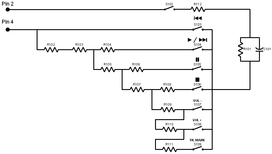

I'am wondering how control signals are coupled into audio lines. For example like some walkman/MD player's remotes do.
Does someone have any idea?

The portable audio device remote controls don't inject a control signal, per se...
The remote's plug and unit's socket have an extra pair of contacts to carry the remote signals.
There is a different value resistor in series with each switch in the remote control, and the IC for the controls in the unit that measures the resistance across those two pins, compares them to an internal lookup table, and then acts accordingly.
See the attached image to clarify.
