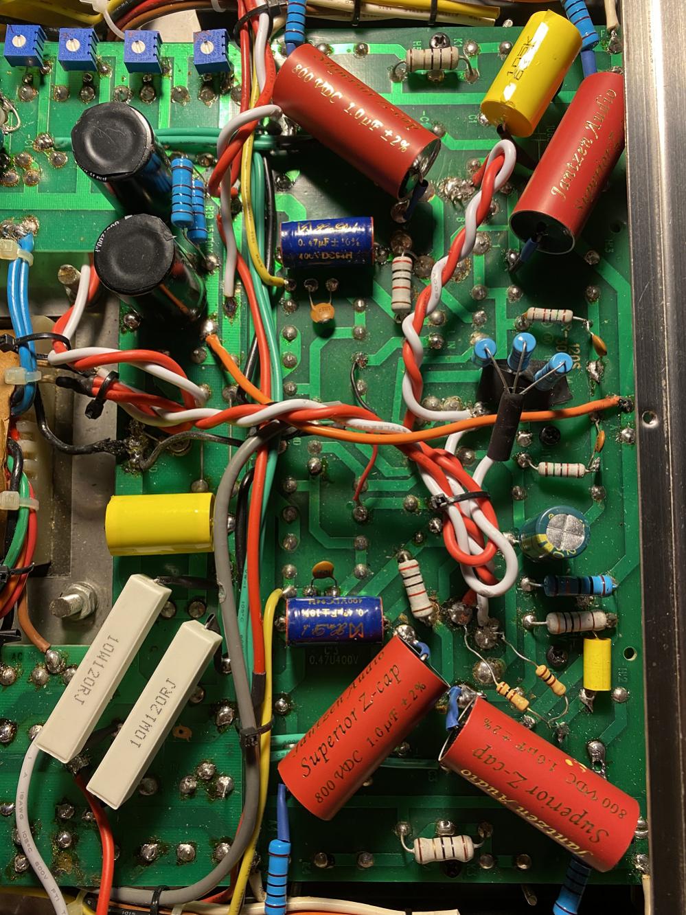

Couldn't get enough bass compare to SS amp so I decided to upgrade from 0.47uF to 1uF, the original design was 0.1uF. It's so good now, can get both mid/bass perfect well. The mid is so clear and i don't want to miss out of the bass, that's why I went ahead to upgrade.
By the way, one of my new coupling cap can spin both legs around 360 degree at the same time. Is it bad? I check the measurement where it shows correct 1uF. I am afraid to use it. I don't know if it's just the cover outside has nothing to do with it.

I bought it's 2 years ago so probably they won't take back. I think the leads soldered well together since I turned the lead on one end, then the lead other end turn as well. What would be a problem if the coupling cap fails or dies in the circuit? As long as it doesn't burn or explode, then I can try. I am afraid it blows up.
