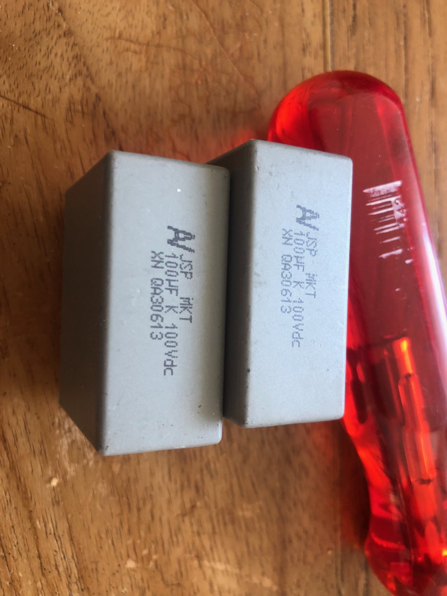

Hi, im building a DDDac1543. Its going to a preamp with 50k input impedanc. What is the smalest output cap I can use on the dac and not loose any bass? Im looking at Solen film/foil teflon to use in dac, Im a fan of V-cap ODAM but have them as output cap in preamp and in crossover so think that is good for now. I also before have bypassed caps in signal way but dont do that anymore, dont like “smearing” of the sound, but that is just my experiance. Frank
Don't think of "smallest possible" but take some margins into account. Your preamp could be 42 kOhm in reality... Please add at least 20% margin for correct dimensioning/design. In your case I would calculate with 25 kOhm as there very likely is some stuff in parallel to that volume controller. If you have a schematic you could calculate input impedance in the various volume settings (just in case) like 9 o'clock, 12 o' clock. Wrong is to assume matters and ending up with easily avoidable errors. So calculate "worst case". If the cap is somewhat too large in reality there will be no detrimental effect. In real life one changes preamps and preamp B might be 25 kOhm and not the 50 kOhm preamp A was.
That is 1/(2 x pi x R x C) for the -3 dB point which I suggest to be 10 Herz. Don't worry about fancy brand names and dielectric types but first get the value right as that is correct engineering. You are better served with the right value Wima MKS than with a too small chosen Duelund Obbligato Gold Silver sprinkled teflon foil hand made capacitor.

Hi again, after the dac I have Pass B1 Buffer with 10uf input capacitor, 50k atteunator and 2.2 uf output capacitor ( : The B1 stays in the system. So with that information can you guide me withh the output cap for the dac? I look at the formula but can not wrap my minde around it ( I will get it one day ). Frank
Nothing changes. Use the formula and calculate worst case. The Japanese online filter calculator always works OK but I will tell you the value if it is too much. What would be a good choice is to use the DCB1/Mezmerize/Pass B1 R2 that all have no coupling caps at all. Saves 2 caps per channel* with better sound as a bonus.
The standard B1 has asymmetric PSU so it needs input and output caps which are 1 µF input caps and 10 µF output caps. In your case you indeed have a few caps too many (wonderful) in the wrong values (WHY?) but that is unavoidable with a device that has an asymmetric PSU. This is called "system choice" and could be better. Normally one tries to avoid too much caps in the signal path as they are not the most ideal of components and they're large and expensive. It it "stays in the system" with aforementioned plain wrong value input and output caps you have a self created/chosen built in defect and you are a respected customer at the local boutique cap dealer 🙂 A technical suggestion is to correct the mistake and swap input and output caps. Small change, high gains and 100% free.
Both B1 and DCB1 have an optimal potentiometer value of 25 kOhm. So the suggestion is to use a 1 µF 50V (minimum) film cap of boutique choice as minimum value. A 2.2 µF won't hurt.

Make it simpler then. If you use 25 kOhm as load then Fc = 1(2 x pi x R x C) can be written as 1/(157050 x C). You want the outcome to be around 10 Hz. Now there is only 1 variable and that is the cap.... A V-cap ODAM of course 🙂 -> with a 2.2 µF cap this is 1/(157050 x 0.0000022). Fc = 1/0.34551 = 3 Hz. The formula uses resistance in Ohms and capacitance in Farad not µF. This makes the - 3dB point around 3 Hz. That is fine with modern source devices. However in some cap loving circles the mantra is that large caps are worse sounding than small caps (never say the terrible words that the best cap is no cap!). There is some truth in that at the extreme side of things like 100 µF film caps but even if it would be slightly suboptimal it still is way better than randomly chosen too small caps that indeed lead to low roll off.
If you are worried that a 2.2 µF V-cap ODAM sounds worse than a 1 µF version then recalculate the - 3 dB point with 1 µF. Simple. If it is still below/around 10 Hz it is also fine.

Frank, could you do me a favor and calculate if I have around 10 Hz cutoff frequency when using the caps on the picture with a worst case 100 Ohm load? And what about the normal load of 220 Ohm?
May I kindly suggest to write electrical stuff correctly? So Hz, Ohm, µF, V, A etc.
No that is a wrong answer as 1/0.0625 = 16 Hz. The online calculator is your friend. Make sure you write "100" and later on "220" for the Ohms and "100u" for the cap. The app otherwise does not work correctly. It needs exactly the right names for correct calculation. When using larger value resistance that will be "25k" and with smaller capacitance values for instance "100p".

NO. The app tells you the Fc as an outcome among other things that are over your head for sure. The Fc is the results of the load resistance and the coupling cap. If it is not clear yet... the larger the cap AND/OR the higher the load resistance -> the lower the Fc....
