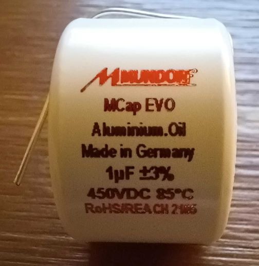

Hello! I just installed a pair of Mundorf MCap EVO Al.Oil caps as couplers in an Adcom GFA-535.
I can hear a small improvement, but only when switching between the modified '535 and another one on which I haven't yet replaced the coupling caps. I don't trust my perception when I know which amp has the Mundorf caps, so I did a single-blind test with my wife. Among other qualities, she has a background in amateur choir music and a very good ear, but like most people does not care much about sound quality and is brutally honest. I faced away from her for the test.
I asked her two questions, "is there a difference between 'upper' and 'lower' amp?" and "do you like the sound of one more than the other?"
Listening to Rachmaninov Vespers, Robert Shaw Festival Singers, tracks 1 & 2 on Telarc, she heard a definite difference and preferred the Mundorf amp.
Listening to Loreena McKennitt, "The Gates of Istanbul," a noisy tune with lots of metal percussion she again heard a difference but liked the stock capacitor amp better.
I'm happy there is any difference at all. I was fully prepared to consider the extra 10 dollars the same as setting a 10-dollar bill on fire and offering it to the gods of audio. It's not all synesthesia.

I like these caps too and honestly, spending $20 extra on an amp build over using generic caps is not something I will lose sleep over. I have zero interest in trying $600 coupling caps but I do like the way these alu/oil EVO caps sound over other coupling caps I have tried and knowing I like these, that's what I use in stuff that I build now. They do sound better to me after a few hours of use.Hello! I just installed a pair of Mundorf MCap EVO Al.Oil caps as couplers in an Adcom GFA-535.
