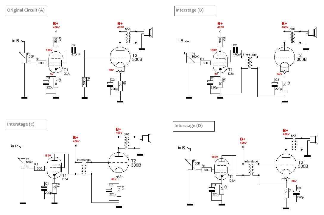

Ok , If someone could help me to understand?
Iam doing a 300B amplifier and I have that doubt.
For 300B? Of course, interstage transformer is better than just a naked cap driving a grid with non-linear impedance.
Another option is, cathode or source follower that drives the grid directly, and can be safely coupled by a cap.
EL34 in pentode mode? A cap is fine, just don't drive it up to hard clipping.
