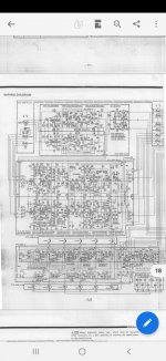

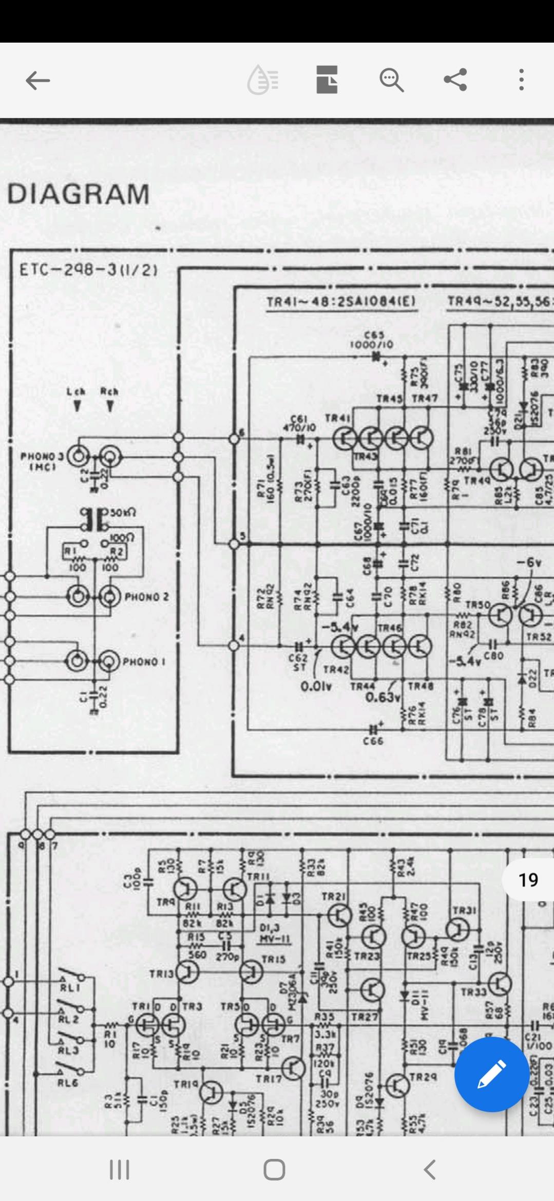

A AnthonyA Member Joined 2017 2021-02-10 9:23 pm #1 2021-02-10 9:23 pm #1 I got a question I have a Mc headamp but it got a pair of coupling cap input can it be removed? And why yes why no? enclosed pics. so the loading is 160 ohm correct? Thanks in advanced Zen Mod Official Court Jester Joined 2003 zenmod.in.rs/ Paid Member 2021-02-10 10:02 pm #2 2021-02-10 10:02 pm #2 just take DC measurement on "inside" side of cap and you'll know for sure my quick glance of circuit sez - nope, it must stay A AnthonyA Member Joined 2017 2021-02-10 11:25 pm #3 2021-02-10 11:25 pm #3 thanks zm You must log in or register to reply here. Share: Facebook X (Twitter) LinkedIn Reddit Pinterest Tumblr WhatsApp Email Link
