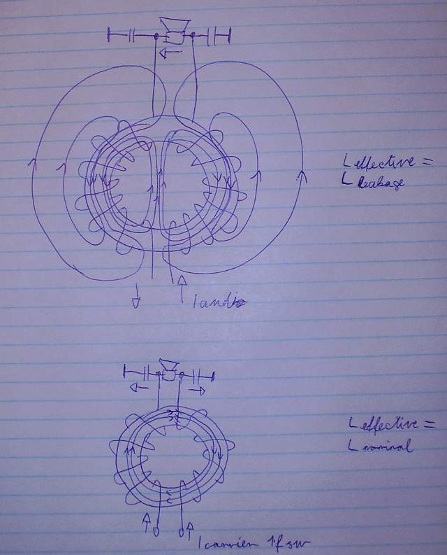

Sooo... No definite conclusion yet?![]()
I would say, you have to use separate cores for all 4 inductors! 🙂
I agree with this conclusion.

15uH on T157-2 Micrometals Dual Stack
http://www.diyaudio.com/forums/attachments/class-d/165367d1270281119-6000w-irs2092-image0051.jpg
Differential, that means one winding starts "on top", and the other one "on the bottom" of the core, as viewed from above, right?
- Class D
- Coupled output inductor in BTL?
