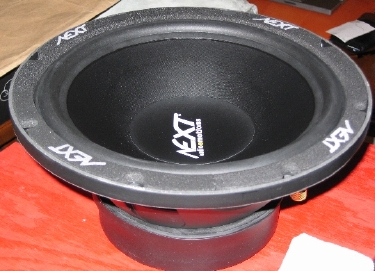

Here's the driver I'm using:
Fs 26.6 hz
Re 3.2 ohm
Qts 0.23
Qes 0.24
Qms 5.7
Vas 2.2 ft3
Sd 346 cm2
Xmax 13 mm (p-p)

No, it's not independent of frequency. The 8-80Hz I mentioned for the 830500 is specific to that driver. Yours will be different (higher in frequency.) You'd need to measure to verify.
The 10" driver you listed with Xmax of 6.5mm will have limited output capability in a dipole configuration relative to some other 10" drivers that have twice that much. You're going to use up that Xmax very quickly when you apply both Q-correction and dipole correction to the system. You SPL capability will be pretty low.
I take it you're aware of this, and this is a get-your-feet-wet project?
Davey.

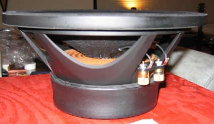

The surround on those drivers looks fairly small to me.
I would hook those up in free-air initially and play a 20-30Hz tone through them at excursions near the rated Xmax to see if they make any aerodynamic noise. Drivers that are acceptable for dipole usage are very quiet with this test.

exipnos, I bought these from an individual, so sorry, I don't have a source for you. They are made by NEXT in germany, which I believe is a company owned by FIAMM. Here's some more details on their products: http://www.fiamm.com/en/3/prod.php/22;224 (too bad the guy didn't have any of the AL woofers. Those frames look nice and open)
Davey, thanks again for all your help. Yeah, you are right, the frames look a bit constricting. Luckily, with only $100 invested in drivers, I'm not worried if I get less than optimal results. I guess I'll just deal with having limited excursion (and consequently levels) due to any aerodynamic noise I might get. Hopefully, I can get some non-ugly sound out of them at 30.87hz.

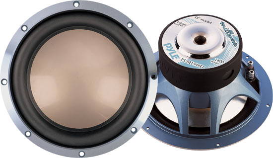

Probably made in China at the same factory that churns out many brands (see pic). The AL drivers do look interesting with the vented gap cooling. Like Davey suggested, run some 20-30hz tones into the driver holding it in your hand (not too loud now🙂 -you don't want to damage it). If it's relatively quiet - you're set.
If you can hear air chuffing from the smallish rear vent, there is a solution. You can drill a small hole (1/2-3/4") in the dust cap, with the driver facing downwards and a vacuum handy to suck out any debri. Glue a small disc (1") of grill cloth or breathable foam to cover the hole. This will allow air in under the cap from the front of the driver and slow the velocity of air being pushed/pulled out the vent. If it's suspension noise, then you could add a light amount of fill into the rear of your H.
You didn't mention how high you need it to go. The lower the XO you need, the deeper you can make the frame to gain a bit of output.

AJinFLA - Those are good looking drivers! Do they sound good? How much? Are they the same as the Pyle drivers you recommended in the most bang for the buck thread?
Exipnos
Exipnos
I have no clue, those are just pictures that I recognized as being similar to the drivers Santui has.
No, these are old model Pyles that have been discontinued. The ones in my max bang thread are still available.
That said, the 12" version (PLM1299) of these Pyle AL drivers were rated as a best buy by a german car mag. If you could find some cheap, they may actually be decent drivers for dipole use - especially the 15's.
AJ
