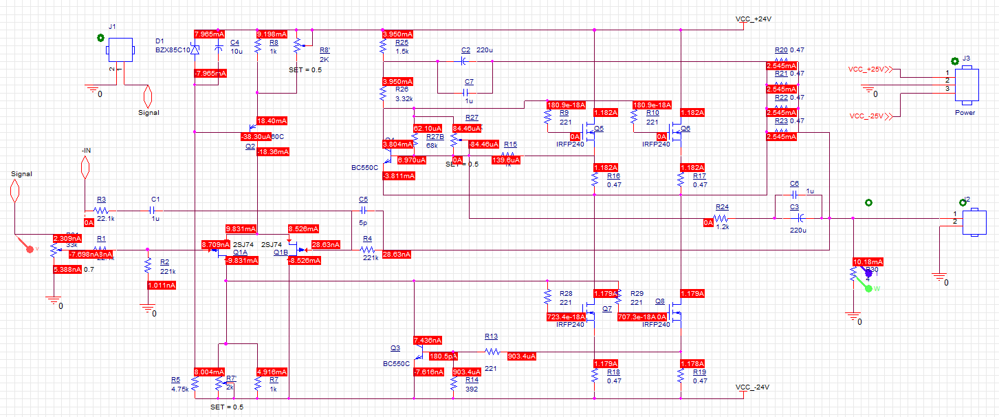

Thank you mr. Pass. I really really appreciate your attention to my research. I’m planing to build either Troel’s tqwrt with approx 95 dB or speakers in a range of 90-95 dB, impedance: 4-6 ohm as major linear value with peaks at 25-30 ohms. I prefer listening to music quietly (similar to normal speech in 20 sq meters room). That is the reason i’m confused at this point-whether given power of 30w (aleph 3, aleph j) will be sufficient to this sensitivity range. Unfortunately i did never see frequency dependance on distortion for speakers unlike your manuals where it is clearly stated -the less power we output the less distortion we will have.
I’ve already done schematics with simulations as well as pcb for aleph 3 and aleph j for studying and building purposes,
but could not quite understand the principle. I’ll study your material in details.

Initial data
Desired SPL (dB) = 75
Distance to listener, l = 3 m
Speaker sensitivity, Е0 = 87 dB
Minimal linear impedance of speakers, R = 4 Ohm
Lets estimate the required amp’s power output
1. SPL = E0 + 10lg(P) - 20lg(l)
2. SPL loss due to specified distance 20*LOG10(3) = 9,5 dB
3. Let’s estimate the output power for the desired SPL. For simplicity instead of RMS lets take the peak output power: P= 3 W-> SPLDB = E0 + 10lg(P) - 20lg(l) = 80,7 dB
4. Output current: P=I^2/R -> I = SQRT (P/R) = SQRT (3/4) = 0,87 А

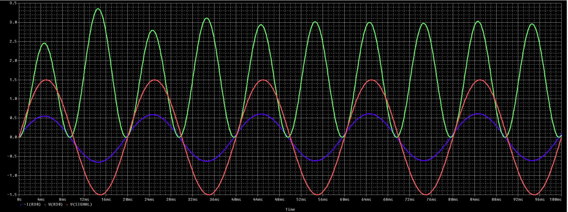

5. Sin input wave simulation results: output current (blue), output power (green) and input voltage wave (red)
Next step-checking node currents for transistors. Seems to be ok.

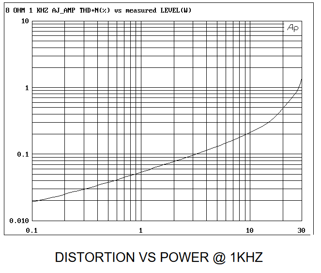

Graph THD on power for Aleph j tells us that we are in 0.1% of THD with 3W of output power.
So, to conclude the amp is capable to perform good with the initial data???
