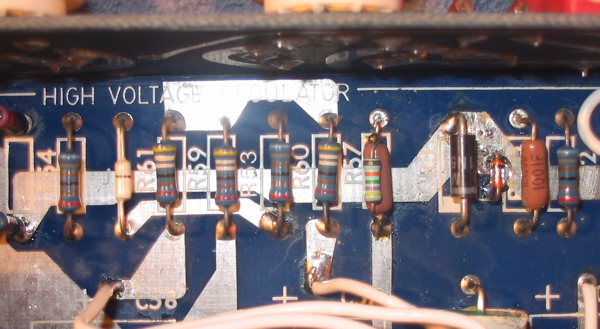

A good resistor for replacing these that isn't too expensive are the Mills MRA-5s. Supposedly 5W non-inductive wirewound. These will fit in place of the Rodersteins without any creative lead bending, etc.

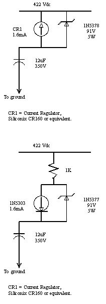

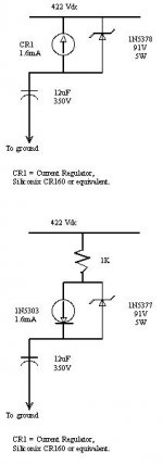

As for the resistors in parallel with the CRD can (Siliconix CR-160 or equivalent), my SA5.1 has a resistor in series with it (before the CRD, assuming I traced the circuit out correctly), but nothing other than the 1N5378 91V zener in parallel with the CRD. Not shown on the schematic I have (which is an SA5, not 5.1 schematic).
I attached a diagram I had done of this at one point, as well as a pic of what this section in mine looked like.

Pars, Thanks for the info. I looked at the Mills 5W at Partsconnexion. Couldn't find the values, though can likely mix and match. Will keep looking. Meantime I did order some stocking stuffers for my lads. Nothing like some silver hook-up wire to wake up to Christmas morning. At the same time I ordered some of the 1/2 watt Holco resistors. Found a 49K9 and 24K which should at least be better than what I have in there now.
