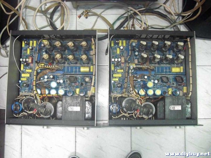

counterpoint sa4 otl

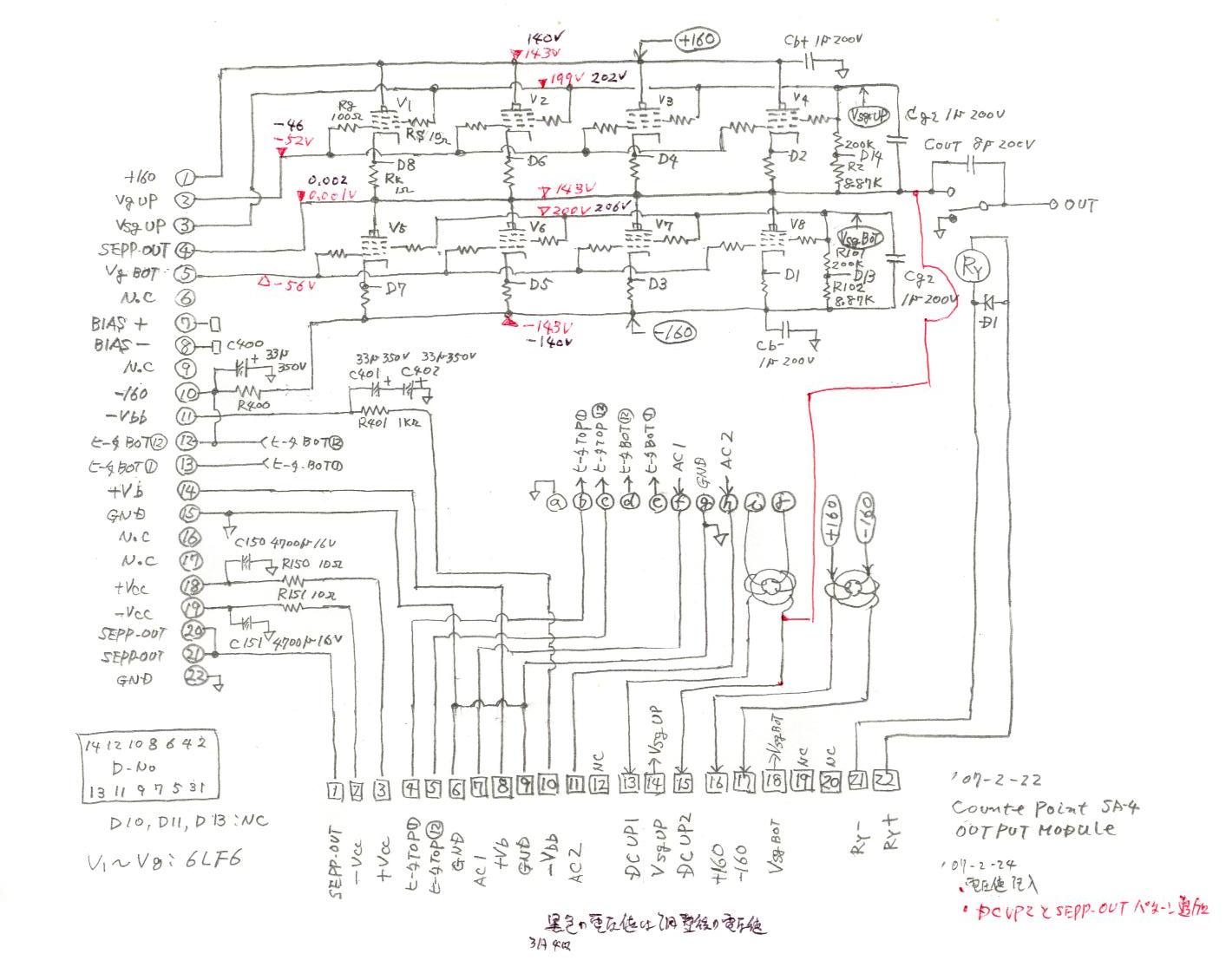

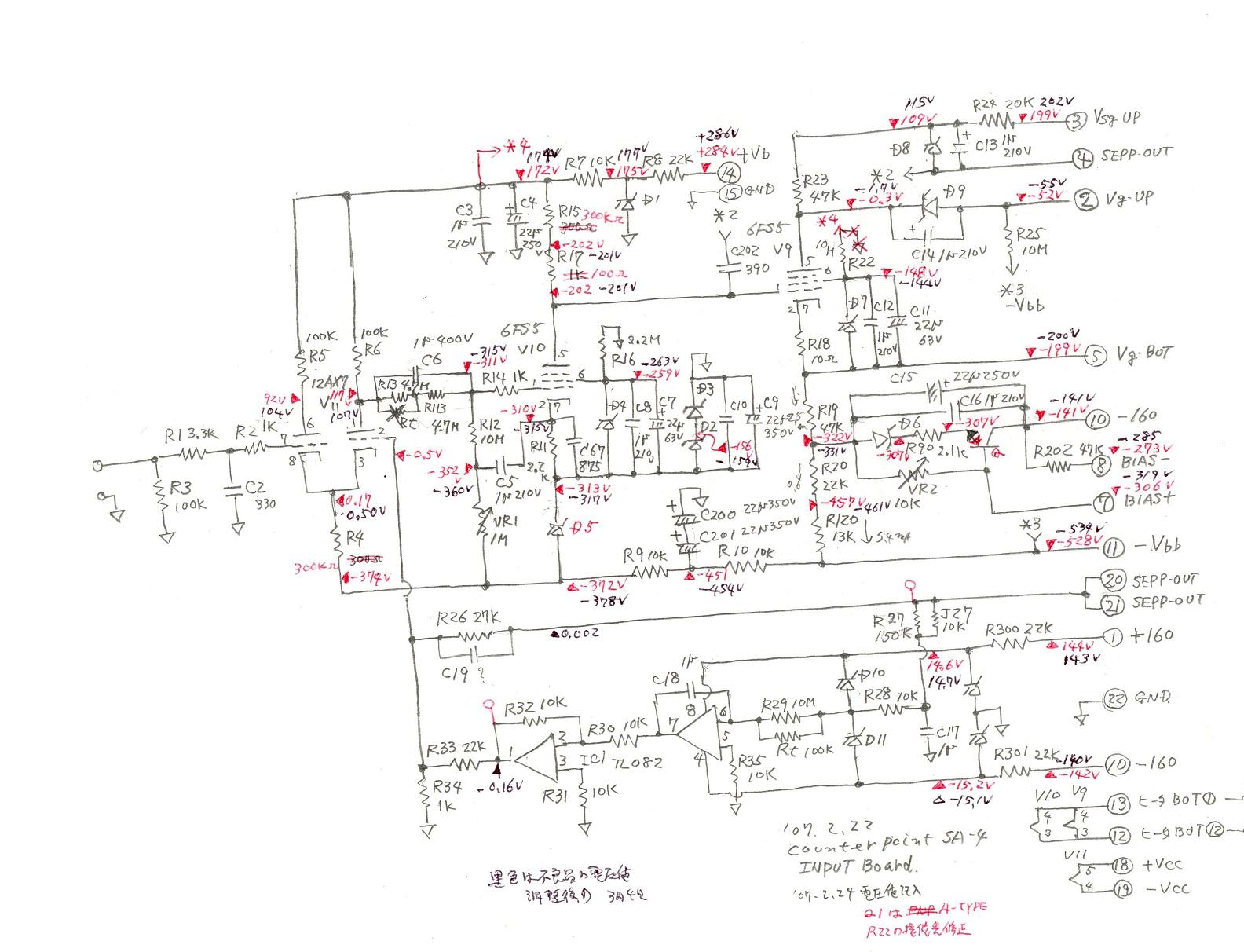

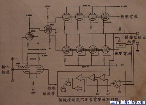

If the relay timer tripped maybe to look into what causes it to trip: too high DC offset, high distortion, abnormal bias and HT etc. You have to study the sch to find out.
Prolly one o/p valve is stuffed,-As I said, Its a diabolical design IMO-A try see if still trips when you transfer output valves from one set to the other.
---A DC Coupled OTL--What kind of crack were they smoking!! Seems to use a Transistorised Servo--To keep it from self-destructing.....
6FS5 remote cutoff guided grid RF tubes for the front end????????????
No equalization of gain for the top and bottom output tube banks????????????
Uhh, is this some 3rd world country design or something???????? Scrap box challenge?????
I would say that a TOTAL RE-DESIGN is callled for, DO NOT repair.
Woops, I just noticed that it DOES have a bootstrapped splitter for gain equalization (V9 plate load). Looking a little better now. The 6FS5 for the V9 splitter is OK (low screen current and gm degenerated). But V10 has got to be non-linear.
