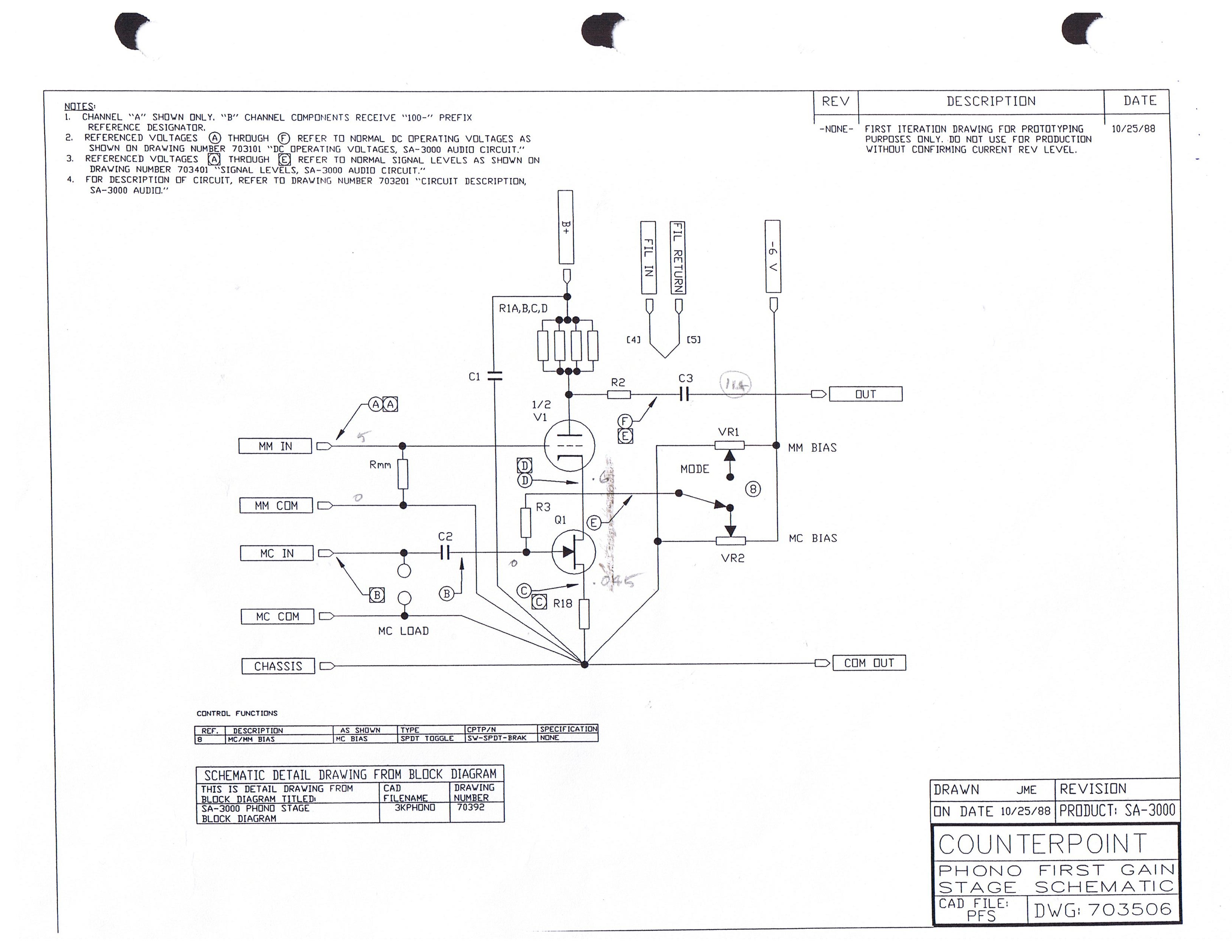

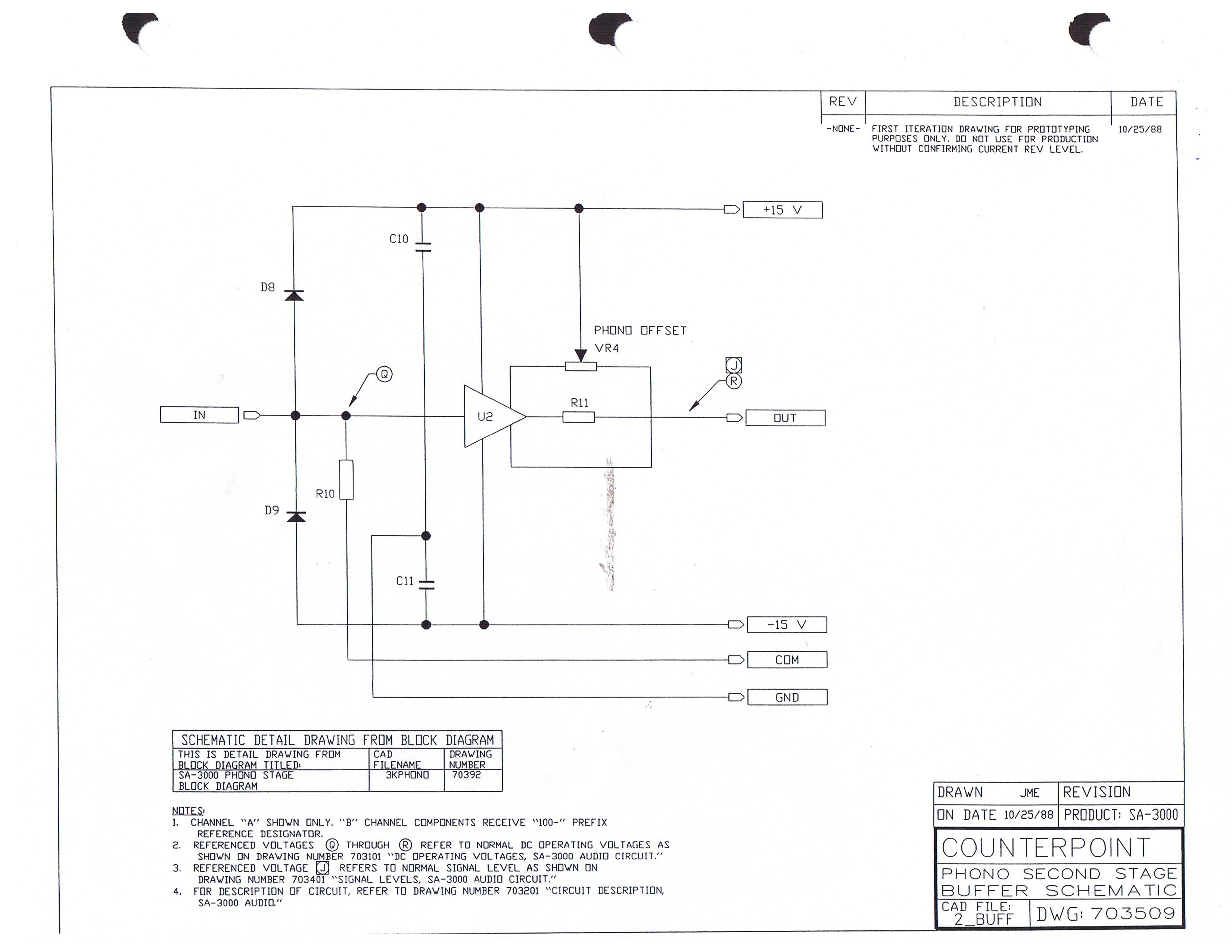

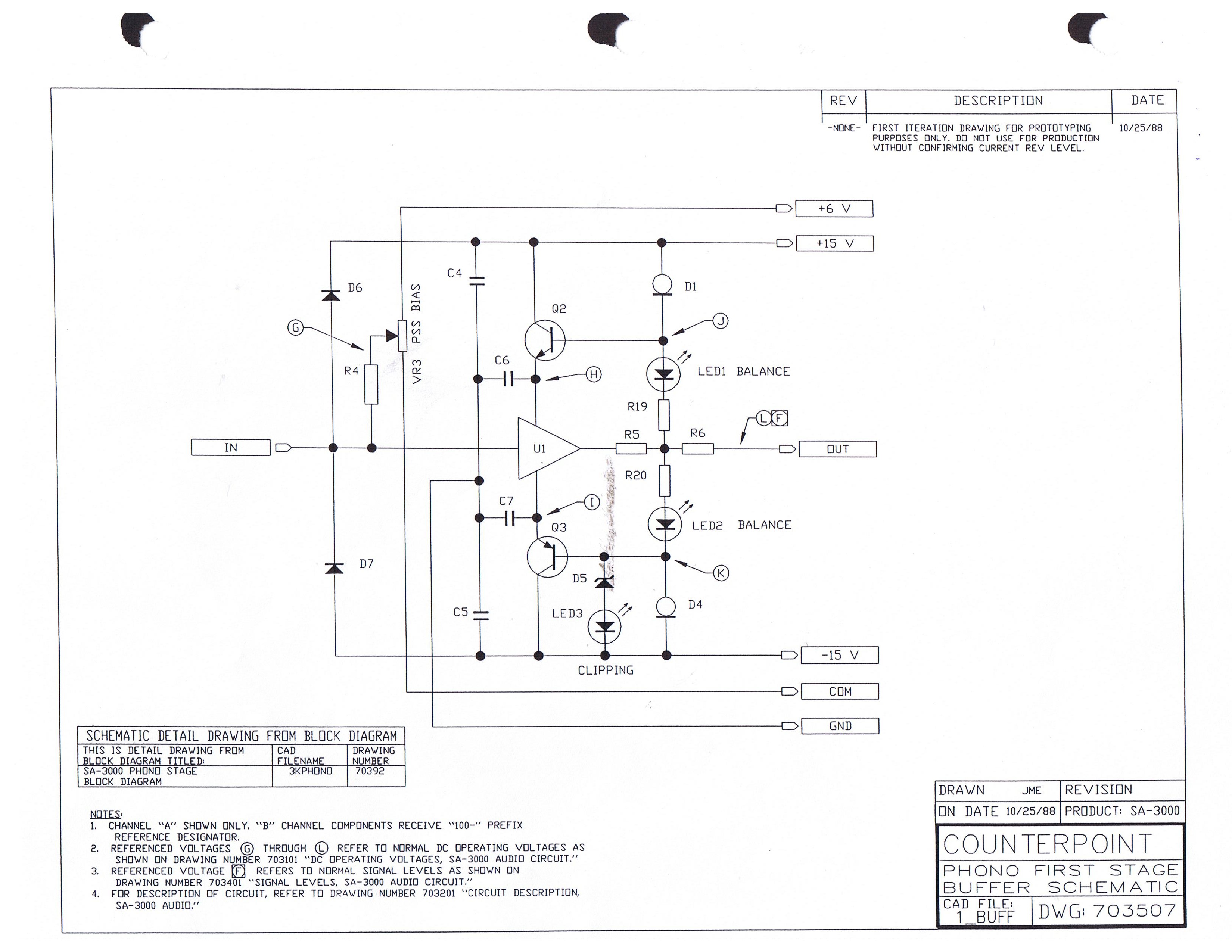

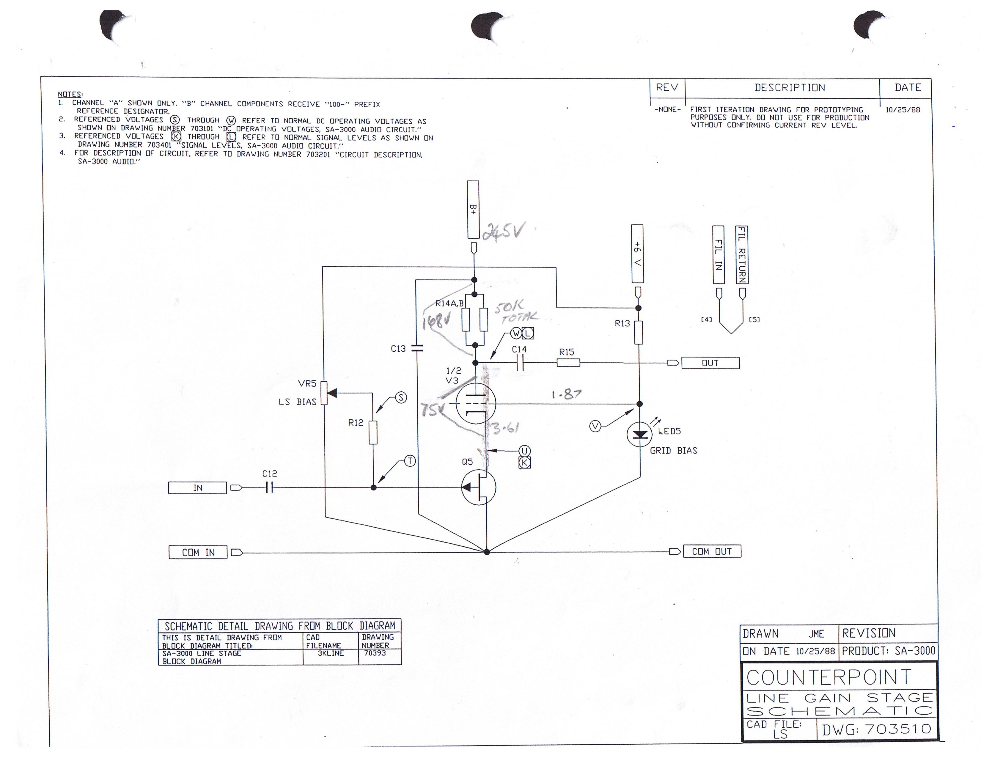

I'm looking for the service manual for the Counterpoint SA-3000 Preamp. I know the designer used to sell it, but he has since closed up show.
The particular problem I'm having is that the IREF LED, LED503, is not lit, which indicates the high voltage section is not functioning. In addition, the 555 timer that switches the relay is not turning activating. These things worked before a recap, so I suspect I lifted a pad, but I need to know where.
Got some stuff but this is all
Cheeres George
