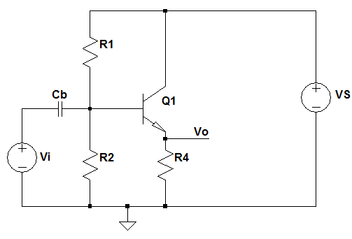

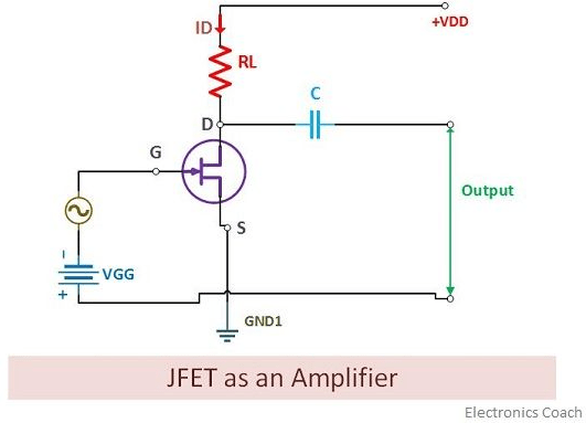

I found examples of these two types of inputs used in amps, the JFet circuit will look something like:
The BJT circuit will look something like:
The section of the schematic for the Aragon and Hafler amps that most closely resembles either one of the above:
So without actually understanding the details of how the circuits are different, it looks like what my amps use is the BJT circuit. Perhaps I still don't have enough knowledge to make that determination. So I might have a bad match for the Counterpoint SA-1000. It sounds pretty darned OK to me, so maybe my ears aren't as good as I thought. I have never compared the two different amp circuits. I apologize for littering the forum with beginner questions, but I really appreciate the time taken to respond and information!
