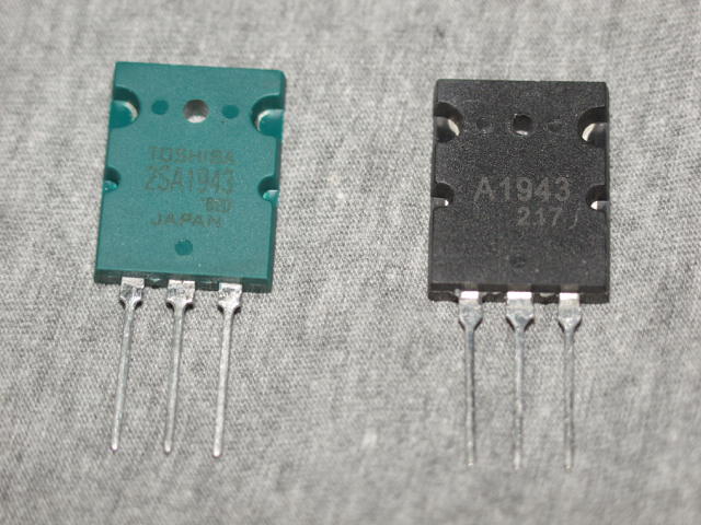

counterfiet sa1943's ??
OK I think the one on the right is a Fake.
Good one readings for EB:
With black probe on E: 4.37 nF
With red probe on E: 11.37 nF
Fake one readings:
With black probe on E: 1.66 nF
With red probe on E: 2.05 nF
Me also thinks that putting the red probe on the E (for an NPN device) simulates the readings for EB that you got... kind of.
i.e. the one on the right with large font seems to be fake, Also look at the mounting hole, it is smaller for the fake one. What do you think Eva?

With these values I'm sure the second device is a fake
The first device is probably genuine but I can't guarantee it. We would need to measure a device of the same model known to be genuine to find out its typical capacitances
Maybe somebody reading this has some genuine 2SC5359, a capacitance meter and some patience to measure them 🙂
In the other hand, your meter is forward/reverse biasing the junctions depending of the polarity you use to measure. This explains this huge difference [4 vs 11nF] since reverse biasing a juction reduces its capacitance and forward biasing it increases capacitance and starts conduction when 0.5V are reached. The real zero-bias capacitance value will be between these two values you have obtained, maybe 8nF. [With my meter, I get the same measurement independently of polarity]

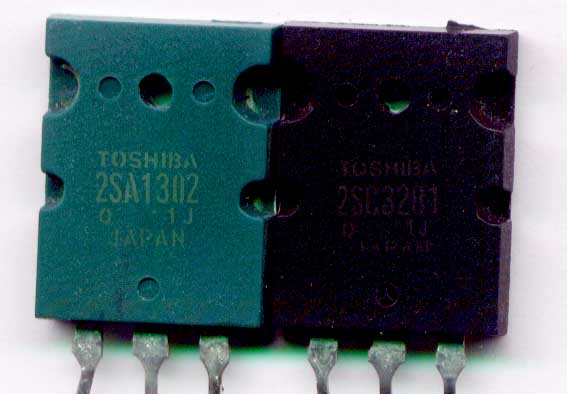

Eva, you're simply amazing😎 I took you up on your offer, I happened to be lucky enough to have a fake and an original 2SA1302 laying around and I did measure the capacitance, per your post.
The original 2SA1302 measures
1.36nF from collector to emitter and;
1.77nF from collector to base.
The fake measures;
0.43nF from collector to emitter and;
0.52nF from collector to base.
I don't know how accurate my DMM is but nonetheless, there's a wide difference here. HMMMMMM:scratch:
It's not a critical reference for measuring transistors, but it sounds like it will get you in the ballpark.
I do have the fake available for any of you that would like to test it (blow it up, put it out of it's misery) and post the results, then:smash: it!😉 . Oh, please post photos. I can have it shipped to you at no cost.
Thanks Eva for your information, that'll at least get us in whether we have bad transistors or not!🙂 🙂 🙂

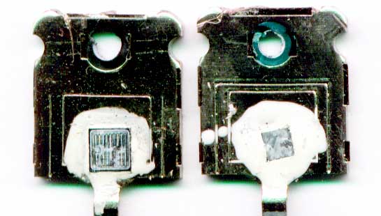

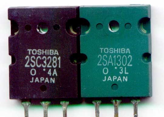

Do you like fake 2SC3281 and 2SA1302?
There are thousands of different fake variants since production of the original devices by toshiba stopped 5 years ago or so ...
All the 2SC3281 and 2SA1302 sold today are fakes. Yours are also both fakes...
Look at these of my fake 2SC3281 and 2SA1302 collection...
The PNP uses the die of something like a 40W TO-220 and the NPN may be a 75W TO-220. The original devices are rated at 150W so try to figure out the size of the die used on the genuine devices

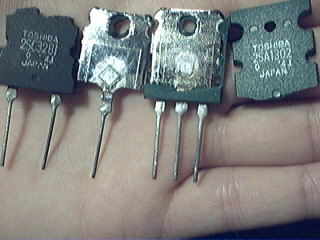

As request here is the picture of the suspect device.
The one on the left is what I usually received. The one on the right the suspect. Also I had others with the same text as on the left but in a black package
This device looks more like a no-brand clone than to a fake. It may be not as bad as fakes
Could you measure C-B and E-B capacitances of both devices?
Masuring some Hfe and Vbe data would also be useful for comparing
Opening the case of a genuine and a clone to see what's inside would also be useful, but I'm aware that transistors cost money 🙂

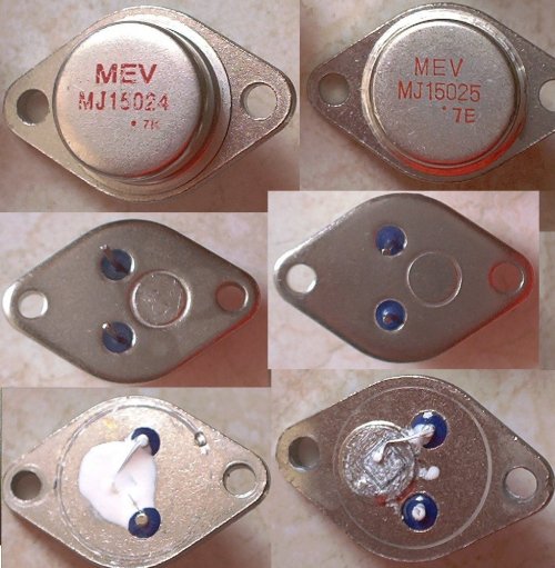

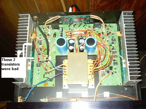

More MEV transistors!
I was unlucky enough to have purchased a bunch of MJ15024/MJ15025 transistors with the MEV markings. As soon as any significant power was applied to them they failed, taking out drivers as well.😡
As soon as I started using genuine ON Semi parts the problems ceased.
Here are pics of the MEV parts:
