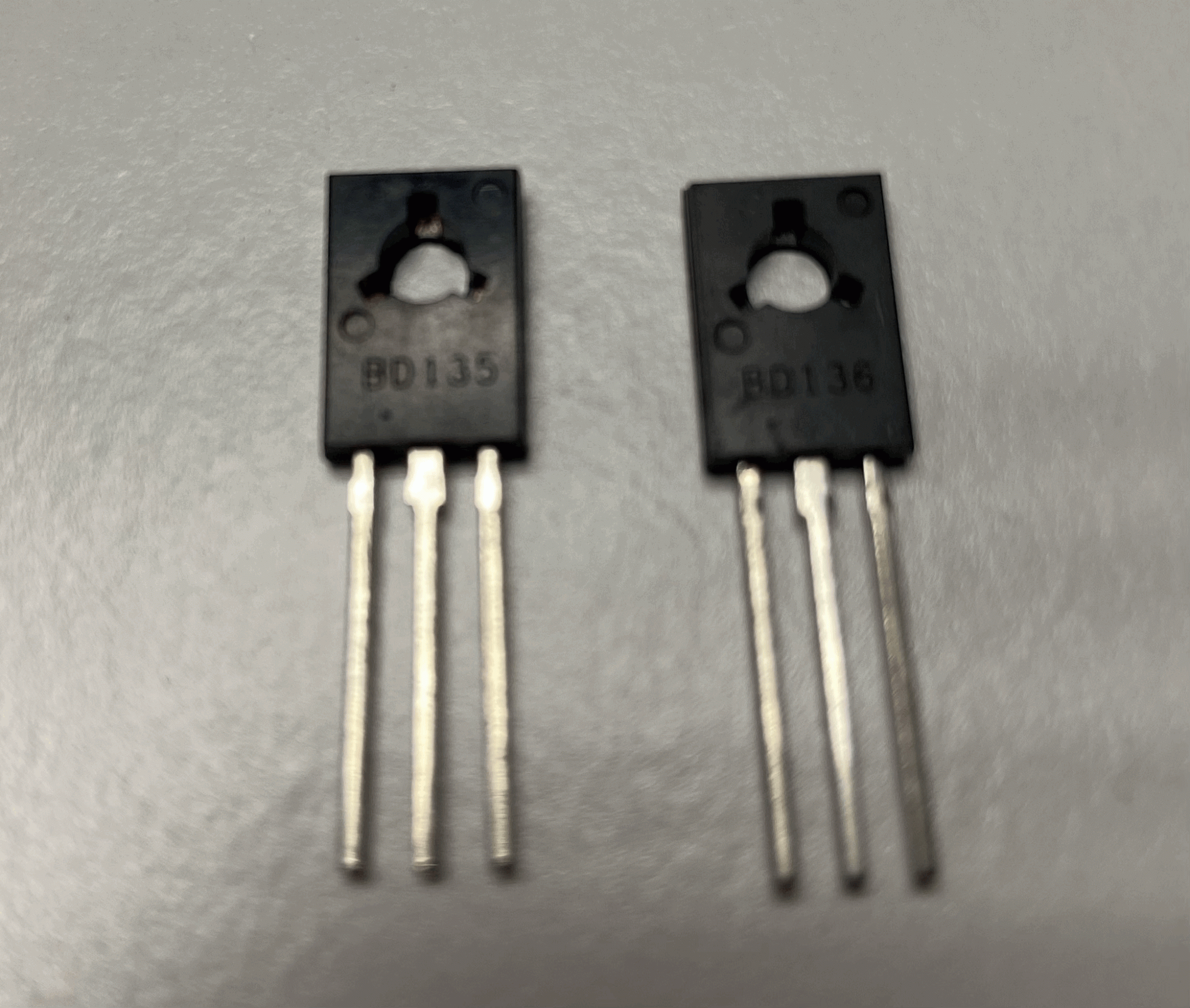

I don't know; they're in two small plastic bags lacking any product description. Sorry for the lousy photo, but they look the same (other than the "5" and "6").
Regards.

What makes real BD13x special is a high fT (typically over 100 MHz, but no spec) and the fact that beta holds up well at Vce under a volt. If you don’t have those characteristics, it is not a “real” one. In the application, neither may matter. But when those characteristics are called for, it is nice to know if your batch is real. Or at least a good copy - they are NOT really all that difficult to make so it is possible.

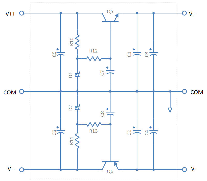

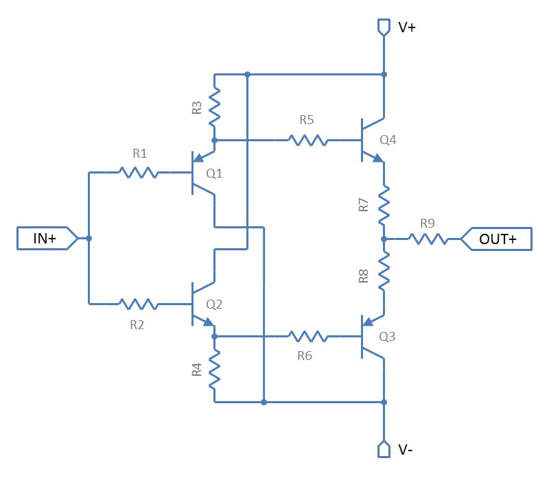

Richard Murdey's B-board and "Z-reg" schematics are attached, and here is a link to the B-board web page: https://phonoclone.com/diy-bb.html
What I'm hearing from you folks is that there is a decent chance these transistors will work in my low-demand application regardless of whether they are real or counterfeit, provided gain and Vbe are in the right range. I can do those tests and will revert with the results.

The application seems real light.
Any transistor will stand 12V rails 😉
Not sure about idle current though, outputs are getting "1 diode" bias, but would expect a few mA tops,transistors are not even heatsinked.
If anything, the regulated supply ones are doing a harder job, since they will pass all the current thebuffer needs, and drop +V rails (which may very well be the main power amp ones) minus 12V.
Those might need heatsinking, I would add a couple small ones, if anything for peace of mind.
The diamond buffer is generally well behaved, as long as there is emitter degeneration (R7 and 8). Q1 and 4 should be in thermal contact, as should Q2 and 3. The only issues with the supply is if it’s output caps get too big. Reverse protection diodes are a good idea (backwards across collector-emitter) any time caps are used.
