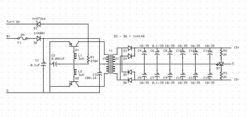

punchpeanut Member Joined 2003 2003-11-12 3:45 pm #1 2003-11-12 3:45 pm #1 Could you tell me what transistors Q1 and Q2 should be in this schematic? It's for 12V processor. In the original schematic I based this on they are not listed. I would appreciate any help. Attachments oeq ps sch.jpg 36.1 KB · Views: 289 djk R.I.P Joined 2001 2003-11-12 7:53 pm #2 2003-11-12 7:53 pm #2 D44VH10 or D44H11 ON Semiconductor punchpeanut Member Joined 2003 2003-11-12 8:35 pm #3 2003-11-12 8:35 pm #3 Thanks so much, that's all I needed. Status Not open for further replies. Share: Facebook X (Twitter) LinkedIn Reddit Pinterest Tumblr WhatsApp Email Link
