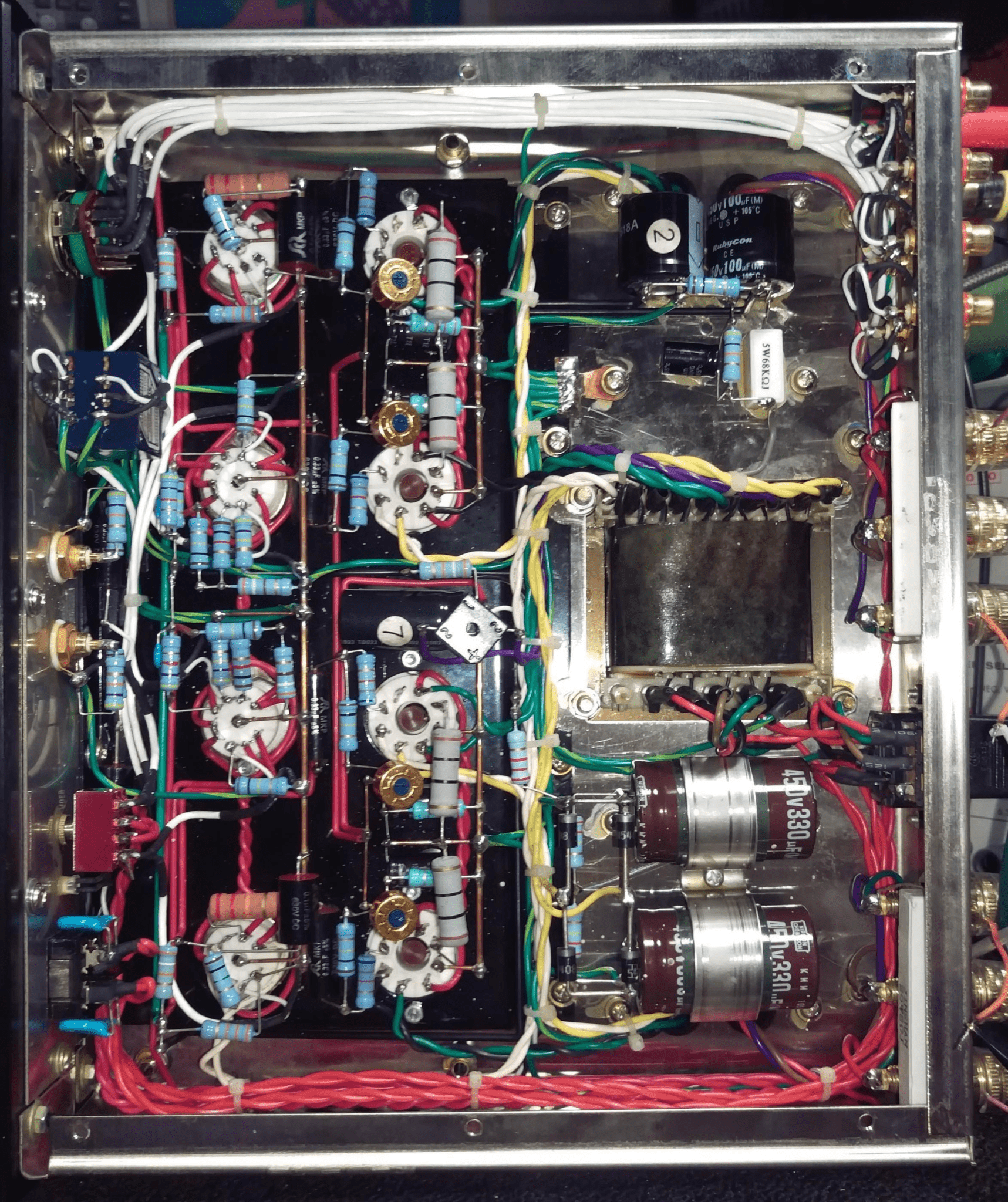

Au contraire, of all the parts I replaced on 'this' vintage iron chest of a boat anchor(Audio Innovations 500 - Serial 50532), the power supply caps were in mint condition and I shall repurpose them or sell them or trade them. I had to make room for a choke to replace that RS Components 47 ohm resistor or I would never have touched these caps. Keeping tradition I replaced them with Kemet ALAs. Kemet bought BHC after all...Replacing the electrolytic caps in the power supply is likely a must.

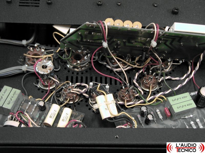

The designers and builders of this vacuum tube-integrated amplifier were at war with each other. After working on this thing on and off for a year I got to know it very well. 'They' spent too much budget on some things and not enough money in other areas. Things fit perfectly together with German precision and some of it was pushed into the enclosure with a boot from a person's foot. In summary, the AI Series 500 is an oddity, an interesting piece and a special collectible contribution to the component world of audio.
The circuits inside are tried, true and tested. Good old-fashioned vacuum tube audio with a bit of silicon. The build quality was/is excellent but it is too much for the iron chassis. The iron box is outstanding yet it is wired like a clam and you must get it open like shucking an oyster. It is profoundly ridiculous but really neat. Everything I touched on it felt like a paradox as though production costs were fighting design goals. I know that can be true with everything manufactured but I truly got a sense of that Ying & Yang in the AI 500. Listen, the cat is out of the bag when brochures and press material have wonky grammar and spelling mistakes coming out of the UK no less. Outlandish. Did the Queen know? Good Lord! Ha

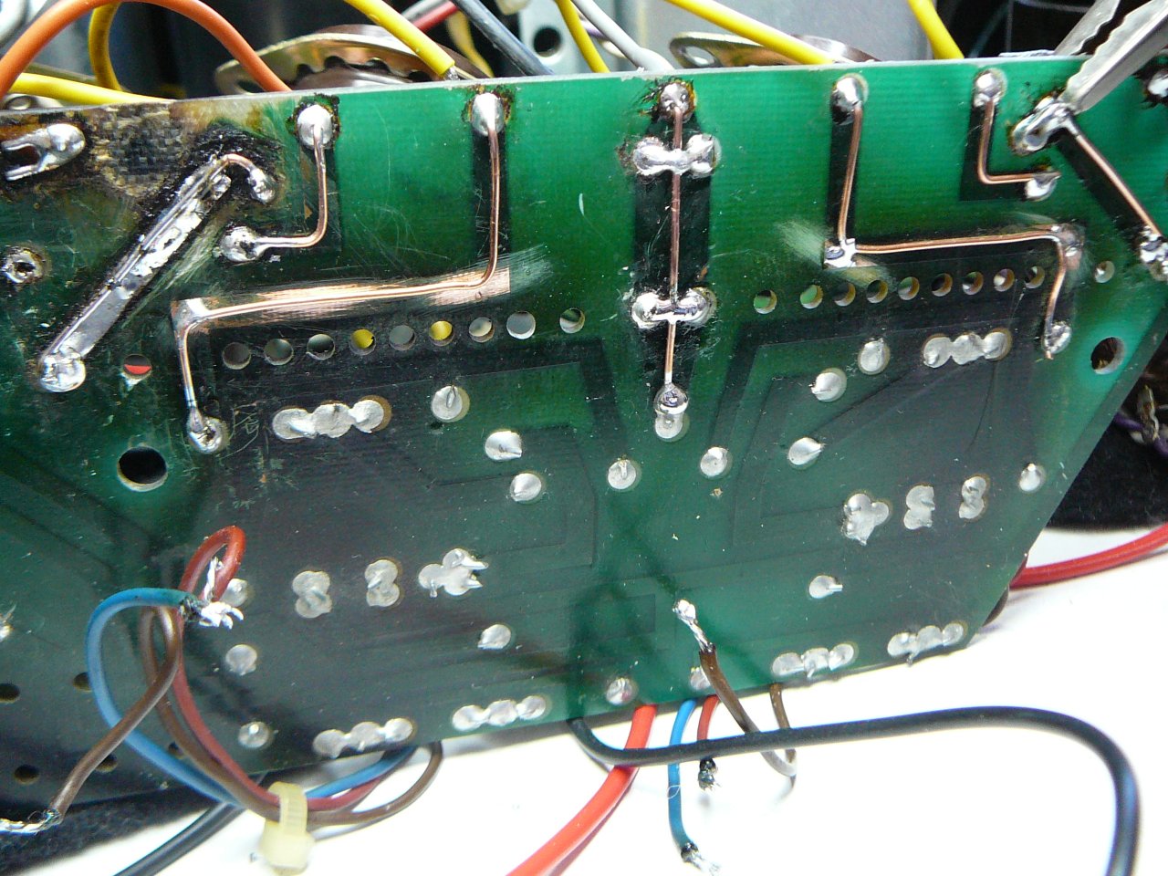

The silver-traced circuit boards are a wonder to behold. Apply your solder iron and watch the trails vaporize in front of your eyes. I have never seen anything like it in my life. Strike one or two for me and it was a mighty blow. I got over it with my own fashionable PCBs.

I pulled the main resistor from the power supply and added a Hammond choke 157R. New power supply caps. New silicon bridge.

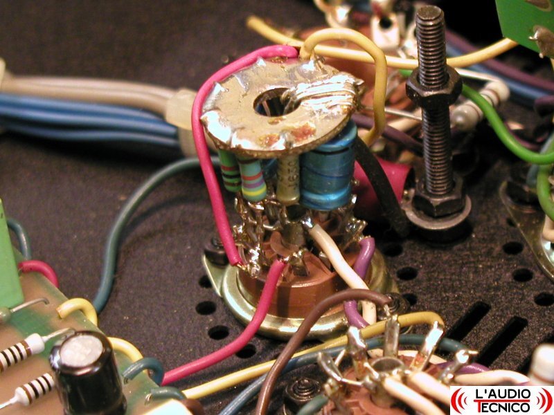

The valves driving the EL34 outputs had a weird factory mod/compromise where 22k 2watt resistors were replaced with 1 watt 47k's in parallel. They are the hard-working plate resistors on those valves. Neither solution would be ideal in my estimates so ditching the circuit board I built a new one with Riedon PF2470 resistors and I fitted them with M.2 Hard Drive heat sinks that fit perfectly and cooled those devils down. They are also 22K and not 47k divided by 2. I guess they can handle 5 to 10 watts no problem with the low profile heats sinks I used. There is clearly a minimum of 4 watts of pure heat dissipation going on there. That has got to be the number one problem with the AI 500 in North America for serial numbers close 50532, 3 PCB build with 4, 8, 16 ohm speaker taps. The circuit board was scorched from those resistors even though Audio Innovations knew this and added ceramic stand-offs. Hot, hot, hot.

I added mains side pie-like-filter resistors to the primary side of the power supply transformer. Something you could only get away with on a small to medium valve project. Low ohmic value and high-watt resistors kept it friendly, only dissipating a few watts of pure heat. They ended up getting their own heat sink to keep them far under spec. This augmentation was a massive correction to the B+ and heaters on the other side of that iron. The output transformers do all the heavy lifting in a setup like this, so I was fortunate that way. You could drop that thing entirely and get a similar power transformer in the chassis. 100% doable at a cost but doable.
