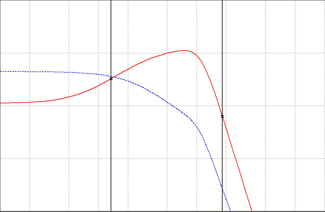

i don't know....but i think is a strange schematics
the midwoofer is 13cm and the wf is 22cm, why they must work together ?, is a nonsense
could you simulate this filter, so we can understand if it is wrong or not
thank you Jacques!
please answer to my following questions :
- what I see in the photo is the simulation of the crossover?
- if yes, what represent the two curves ?
- what software do you used for that simulation ?
- why in the graph there isn't frequency and db scales ?
You're welcome. I won't call it a simulation of YOUR crossover - let's say it's an illustrative simulation of this type of crossover with more or less sensible component values. I might as well have drawn it with a pencil. There are no values because it's qualitative, not quantitative. I didn't have any actual component values so it would have been misleading to include values on the axes. I simply used an electronic circuit simulator (5spice) with your crossover topology loaded by 8 Ohm resistors to come up with the graphs. The blue trace is the woofer and the red the midwoofer, if that is what they are. Stevebogus and adason have hit the nail on the head. C6 IS connected across both woofer terminals. The only reason for my response was to show that there's nothing wrong or unusual about the circuit. A "real" crossover simulation would be more involved and would require component and driver data, and more software resources than I have at my disposal. Or at least a lumped driver model or two. (I'm not overly fond of crossovers and loath to go into this too deeply. Those who work with crossovers all the time would be able to simulate this blindfolded, with their hands and feet tied behind them. Or to point you to appropriate software.) There's a thread on this site http://www.diyaudio.com/forums/multi-way/259865-xsim-free-crossover-designer-new-post.html treating a basic crossover simulator which can be downloaded easily and be used for your needs. In fact, there's a host of such programs. One simply picks one's poison.

Here the manufacturer has described the functions of the crossover. The woofer/midwoofer are probably not working together at the lowest frequencies, but that is not handled by the crossover. The midwoofer cannot provide much response in the lowest octaves due to the natural 2nd-order rolloff of a speaker below its resonance frequency. My guess is the designer placed it in a subenclosure which shaped the rolloff to the desired frequency and Q. Because of this no additional electrical rolloff is needed in the crossover. The woofer augments the response below the midwoofer rolloff point. As the manufacturer hints, R3 limits the SPL of the woofer so that it does not dominate the midwoofer in the range where both are working together.
I still suspect that the crossover schematic is not quite correctly reproduced. Possibly intentionally, to prevent someone from attempting to copy it without knowing what they are doing.

B) the Low pass network works on the midwoofer-woofer series both. The C6 applies a double slope on the 8" WF
For all drivers the acoustic crossover slope is the 4th. The zobel network before the mid woofer is used to tune the relative acoustic phase (with the tweeter) at 45 degrees.
