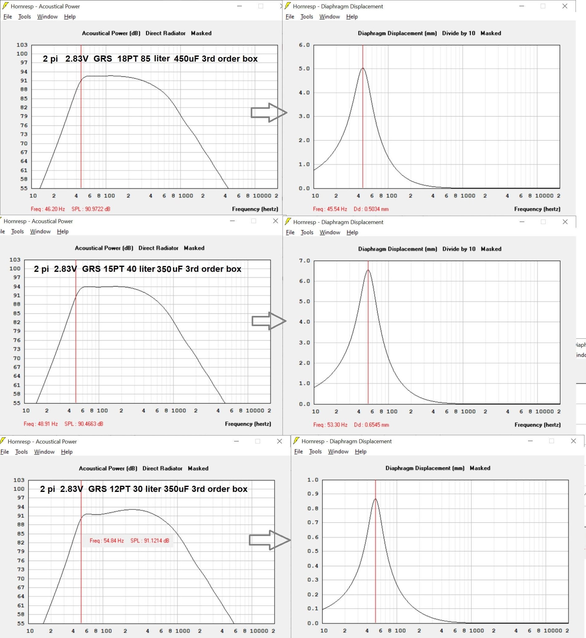

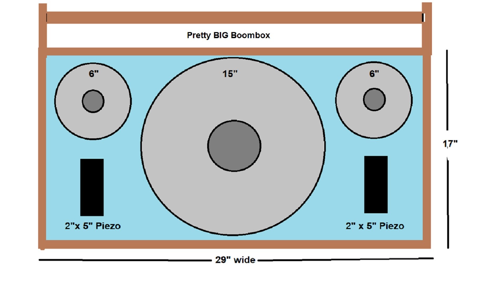

I'd like a big clunky low distortion/ reasonably high spl capable 2.1 boombox centered around my GRS 12PT. A 30 liter 3rd order closed box would do the "point one". I'm looking (if sufficient money comes) at the 16 ohm Eminence Alphalite 6B to reach to 200Hz (again probably cap assisted) plus a tweeter. I know it will be stupid large - perhaps "stupid" period but am having health issues and want to be entertained, It would be run by a $40 Kinter 3118 2.1 amp and a phone. The Kinter has good SQ but its tone controls offer no boost.
A more practical solution due to such close channel spacing with 2.1 in one cabinet would build a MONO boombox.
Here's "1 watt" 2pi for 30 liter with 325uF
Alphalite 6B is a 16 ohm driver - helpful to get closer to the woofer's sensitivty. Kinter's "sub" channel says 180Hz lowpass (might be 6dB/oct ?) plus 6B weighs only 1kg. Here's 1.5 liter with a cap.
So with these drivers I'm up to needing 33 liters air-space.

You can make a big 'sound bar' type thing , with the sub at middle, and main speakers near the end, tweeters at extreme ends.

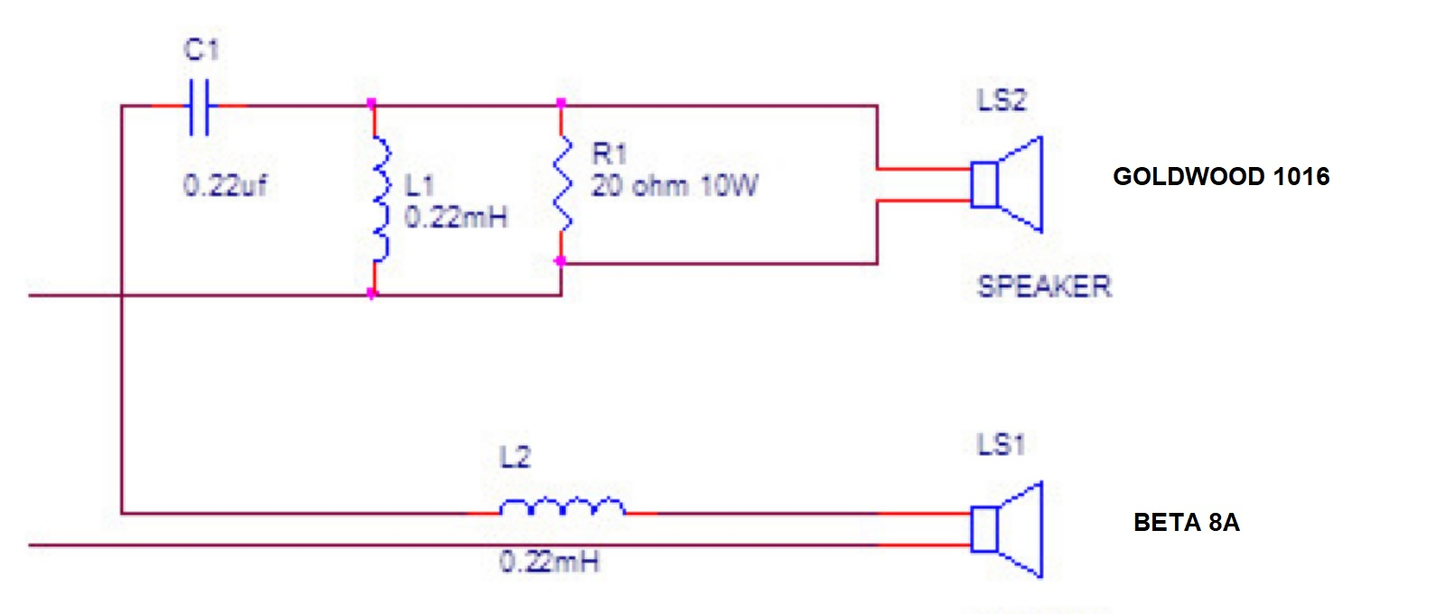

Thanks for the reminder and links- 'll have to put a shunt R across the amp - what value would you suggest ? It'll have a piezo but with 20ohm shunt R. I'd assume the Kinter would be something like Dayton's DTA-100A as to reaction to different loads. At very near 75 years of age - I won' t hear the top end effects.
I could have a small resistance between the piezo's highpass and the KSN1016 (which IIRC acts like a 0.16uFcap in the Motorola device) - normally I use 56-62R in that spot.

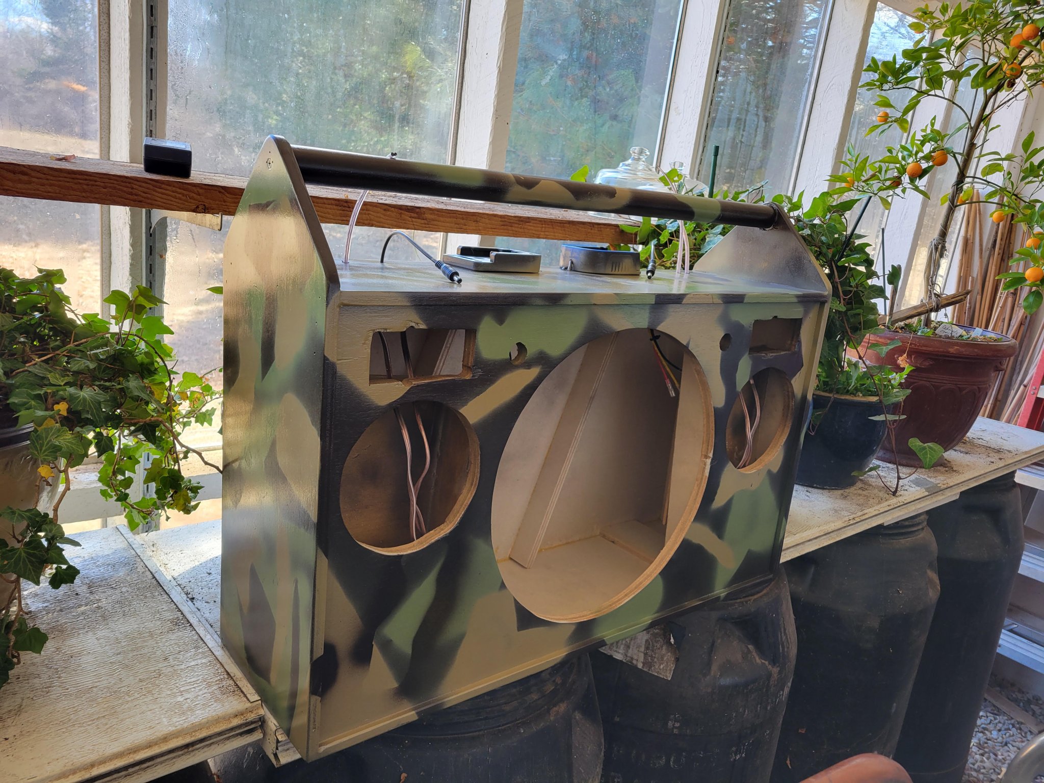

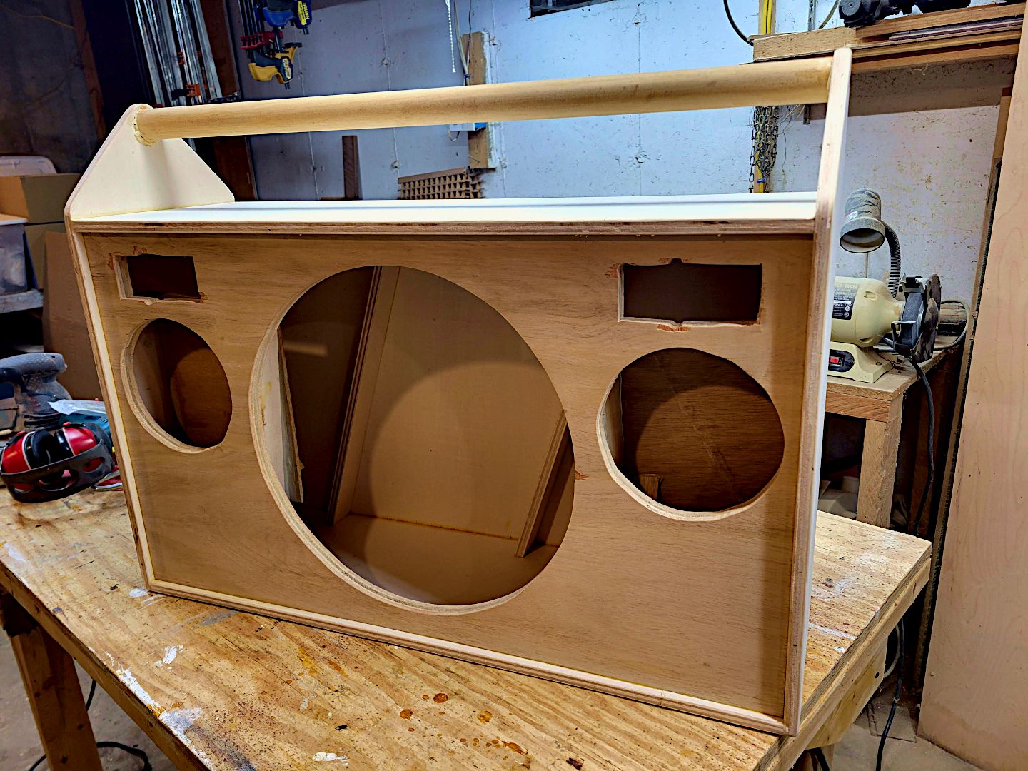

will do - might be some time - my friend will make the cabinet - the basic box using 1/2"ply will be about 29" x 17" x 9.25" external (not including a handle.)
How much power would you say a 3118 amp running from a 20V battery would deliver into the nominal 16 ohm load of the Alphalite 6B?
- could wire it as a mono boombox - pad the paralleled mids - would need to find a mono 3116 amp in a case - ii would be nice to find one with Baxandall type tone controls --Amazon shows a barebones 3116 in a case sans power supply for $30
