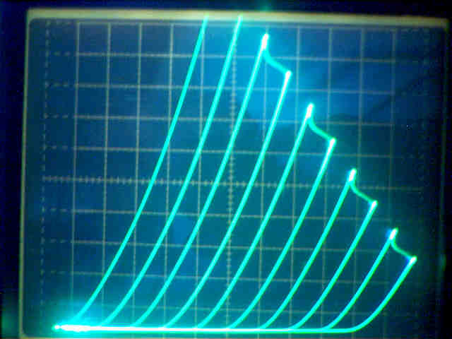

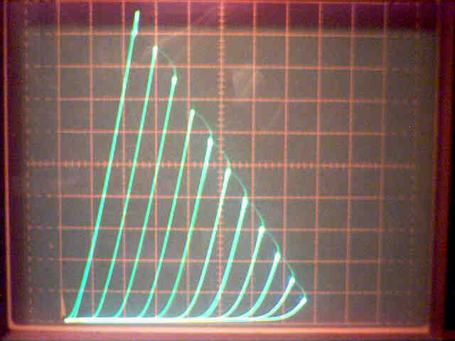

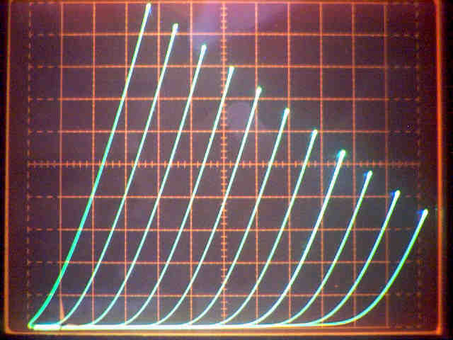

An idea comes to mind after taking a look at these somewhat ficticious "triode" curves (1st image attached). If some scaling factor, related to plate voltage, were to scale the curvatures in such a way as to make them concentric curves, then any load line would see constant spacing. This could be achieved by a small variation in Mu (increasing) with increasing plate voltage. Some tubes, not too often, display this type of effect on their data sheets. This would need a fortuitous matched coherence with the 3/2 power law's variation of Mu downward (with increasing Vp) to compensate. No idea though how it is designed in or how it just happens. 2nd curve set is the 1E7G for comparison.

If the curves are evenly spaced, horizontally, (i.e., constant mu) which is very nearly the case for those lovely curves that have been shown, then it does not matter if the load line is sloping! The only requirement is that you keep the operating point above the low-current area, where the curves really start to, well, curve.
You're remarkably dismissive of such obvious linearity, for someone who messes with tubes...
(Remember, only a theoretical triode follows Child's law. Real triodes only vaguely obey it, so it is entirely possible to get a near-perfect linear triode, if you're lucky)
OK, so what would be a good use for this nice triode strapped 1E7G?
I am rather slow in the ways of toobs, so asking the old hands here.
Well, the 1E7G triode configured would seem somewhat limited in application.
The parallel configured triode giving:
3 Watt plate diss. (possibly 4 W if the two 0.5 W screen watts ratings can be included)
135 Volts Max. Vp
Mu 10
gm around 3000 uMho in useable range (4 to 15 mA)
Rp around 3.3K Ohm
2 Volt filament (Yuk!) Well use 3 of them, then 6.3 V, Ehh..., no, that won't work. Hummmm..... Have to use a DC filament.
Could be a nice input tube for an amplifier, or a line stage.
That 6E5P looks interesting too. Driver stage for an amp.

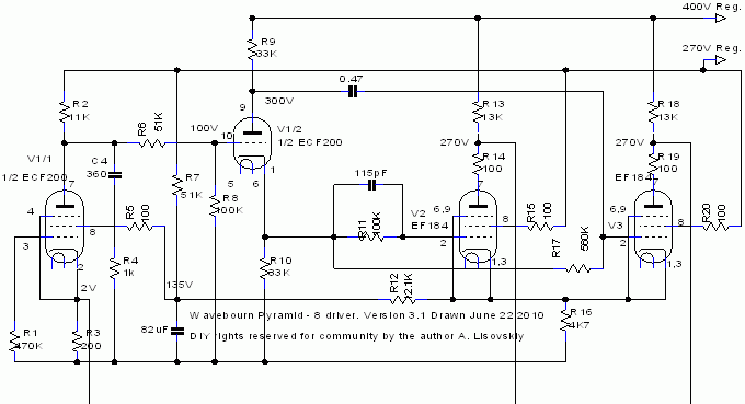

Hmmm, you know I just recently saw a schematic someone posted where the global feedback was inserted at the input stage screen grid, instead of the usual cathode insertion.
May be it was a VLF feedback, i.e.servo?
I've seen your servo design before. Nice approach. But what I'm thinking of was posted by some Newbie as a bunch of schematics they had found on the internet. They wanted opinions on which to build. (within the last few months) I remember an odd one had the global feedback to the input tube screen grid. Likely to give the P-P design some SE sound character. It was not well liked by the commenters though, due to the non-standard approach. I thought maybe I had made a copy of it, but I can't find it if I did. Should have.

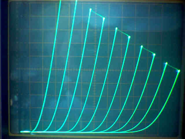

OK, its my turn. This is not quite as linear as the triodes shown here, but it isn't a little wimpy tube either. Look at the scales. I have no problem getting 75 watts out of a pair. The distortion is low without any feedback at all.

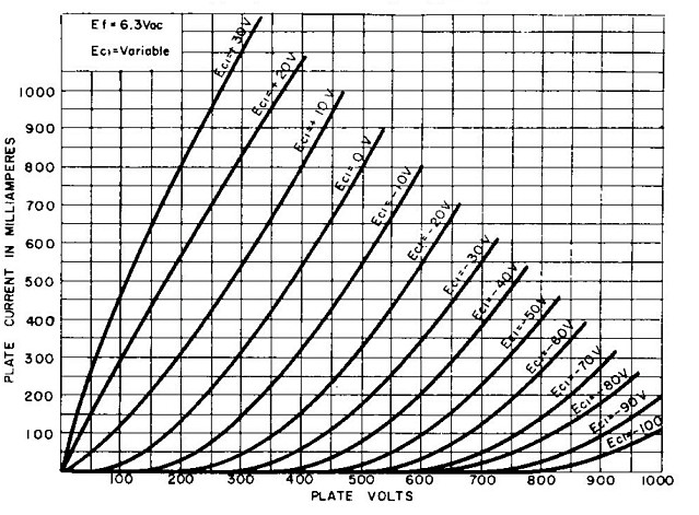

In my mechanical engineering world one of my biggest pet peaves is a shinny sales brochure and slick salesman that touts his product as the ultimate green and sustainable product on the market. My view of this is that I do not want to offer my client more than I can deliver.
Now to the linearity of triodes. When there were only tubes, linearity was not a topic, the goal was to minimize distortion. We did not even spend much time speaking of even vs. odd order distortion. Now we should resist the propensity to compare tubes to SS. They are of different worlds and different times.
Lets breakout triodes into manageable chunks that we can talk about; signal voltage amplifiers, power amplifiers and everything else.
Power triodes and triode strapped pentodes, my example here is the recently much touted as being the secret best contender, EL156. This tube will idle at an operating point of 50 watts and if we are lucky produce 9+ watts at 5% nonlinear distortion. That 9+ watts is near 20% of the the Class A idle power. This is no different than any other triode for the last 80 years. Am I dismissive? My challenge is to see the exceptions!

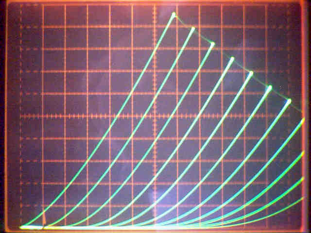

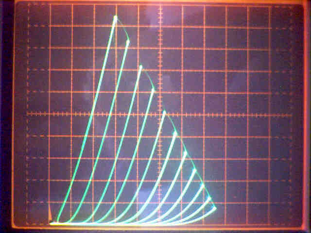

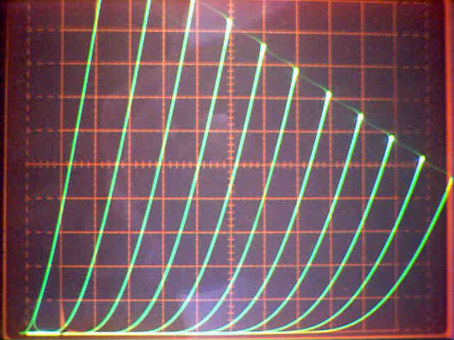

Out of curiosity, I traced an RCA 6SN7 to see how it compares.
a) 6SN7 2 mA/div, 20V/div, 1.2V/step this is same scale as the 1E7G plot
b) 6SN7 2 mA/div, 50V/div, 2V/step
c) 1E7G in triode
d) 12HL7 in triode
e) 38HE7 in triode
f) 6HJ5 in triode
I thought the 6SN7 would look a bit better than this.

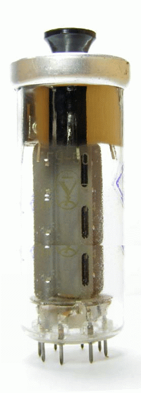

38HE7 is a contender with Georges unknown tube. It was on sale recently for $0.33 each for a box full, still on sale at $1.00. At least it should get the title for the cheapest quality power triode. Should be good for about 15 Watts if the damper diode in the bottle is not used. (filament for pentode only across pins 10,12 21V) It has a Mu of only 4.2 and gm of 8800 uMho at 60 mA.
Looks like George's tube has a Mu of 10 and gm of 15,000 uMho at 300 mA. (or 12,500 gm at 200 mA or 10,000 uMho at 100 mA or about 8400 at 60 mA calc'd)
note: the 12HE7 does not always have the pin 10 tap for pentode filament only use. 38HE7 does seem to.
