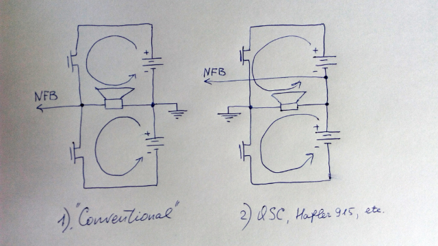

Michael Chua said:
Since it doesn't improve the PS efficiency, what are the advantages of doing it this way. We have a situation where the PS caps are in series with the load and like you said earlier, it doesn't block DC if any mosfets fail? Would it not be better to revert back to the convention PS and have the output from the source and ref the 0V back to the PS.
The power supply cap's aren't any more in series with the load than for the standard connection, see attached picture - all three are equivalent. The local feedback through the parallelled resistor+cap essentially makes the circuit a current controlled source follower.
Michael Chua said:Yes, I'm clear about that. However, I don't see them as big advantages.
You could reverse the question: What are the advantages of doing it the "normal" way? The advantages and disadvantages of each are pretty small.
Michael Chua said:
We can easily get gain in the power stage with the addition of a pair of drivers. Even though I prefer to drive mosfets directly with the VAS, in this instance, I would rather have drivers because driving the power mosfets directly from the VAS requires quite a bit of "juice". If the VAS don't have enough current, the amp will slew limit early.
One of the advantages of the circuit is that the driver stage is powered from lower voltage. Say we want 100mA of VAS standing current to be able to drive the gates nicely:
* In the conventional circuit VAS power supply voltage would need to be +-(88 + 12) = +-100V for the same rail efficiency. Being able to provide 10V to the gates even when near the rail. VAS dissipation: 0.1A * 200V = 20W
* In the grounded source circuit: supply voltage can be as low as +-15V for the vas. That would give 3W of VAS losses at the same current.
Almost a 10 time improvement in VAS power dissipation for the same standing current. The VAS can use cheaper and faster transistors thanks to the lower voltage and power dissipation.

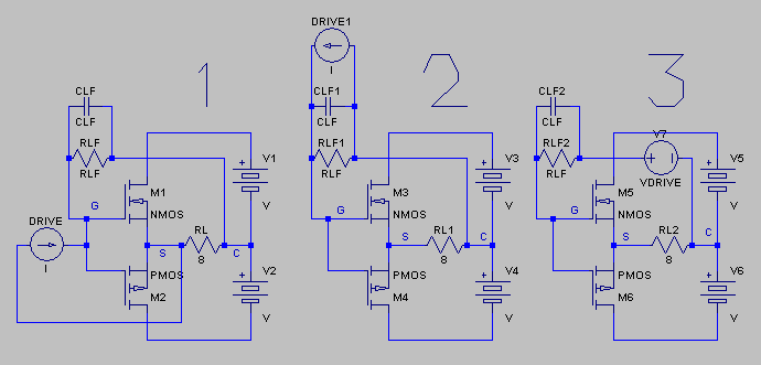

Michael Chua said:
I understand that in order to have Gain in the current stage, the mosfets are arranged as common source. Output will therefore be at Drain.
It's not really applicable to this output stage as it is a transresistance amplifier - current in, voltage out. Though, it can be seen if the source is transformed into it's equivalent voltage source, it's more like a common drain amplifier (follower) than common source.

Michael Chua said:
There is one other point that I am puzzled. In the P9505, there are only 4 pairs of lateral mosfets. I assume they are 2SK1058 and 2SJ162 running at +/-84V rails. Is this not a bit too demanding on the mosfets?
That seems to be common practice with lateral fets. Hafler used 3 pairs on +-90V in one of their models for instance. Also, the improved thermal transfer without mica will help.
But the biggest reason it's possible is that music has low average power. I think it was Eva that successfully used 2 pairs of Sanken 2SC3264 on +-90V driving 4 ohms - which might seem to be way too little. And it is if you want to be able to get sinewawe out at the worst case output level for power dissipation. But music is pretty different.
In this case it's even less demanding than that though. The laterals say 400W 10ms, only 33% less although power rating is half. And there's two times as many. 1600W 10ms pulse SOA instead of 1200W for the 2 2SC3264.
And then there's the negative current temperature coefficient and the (parasitic?) internal overtemperature protection at ~200 degrees C which makes the laterals almost impossible to destroy as long as gate current is limited.

Hi Struth,
I'd like to elaborate this point a bit more if you don't mind.
Let's look at the push-pull OPS from "fundamental" point of view. It fact, output devices control the way, the current from PSU flows through the load.
All the rest of the amplifier circuit provides the required voltage gain and the means of driving the output devices.
The closer PSU to ideal one (constant V, unlimited "I", zero impedance) - the better. No doubt.
Now - please see the picture. In fact, the only difference between (1) "conventional" OPS arrangement and (2) the one, utilised in QSC, Hafler 915 and some other amps, is the grounding point and the point where we take NFB from (opposite sides of the load).
What I'd like to say - your comments with regards to PSU issues (transformers, filtering caps) are true for both cases.
Some people also claim the 2-nd option never performs as good as the 1-st one. I disagree with that because of the considerations mentioned above. No principal difference.
What do you think?
Valery

Hi Forr,
Good example
However, the word "audiophile" in the article looks like a certain exaggeration 😉 Seems too "class B" to me.
Here is the other one from Linear Audio with properly biased lateral FETs:
https://linearaudio.net/sites/linearaudio.net/files/May 28-Figure 9 - Full Amp.pdf
Valery
Has anybody tried it ?
I tried similar but much simpler solution, the link to pdf with scheme: http://www.diyaudio.com/forums/solid-state/57892-tcj-evolve-simply-good-amps-idea-2.html#post654105
Well, combination of these two - the one mentioned by Forr and Pawel's one - would form a very decent amplifier. I would also add a bias spreader - it's more or less ok to run as is at +/-15V rails, but at +/-25...50V, for example, thermal feedback is a must, if we are talking about IRFPs (laterals - a different story).
