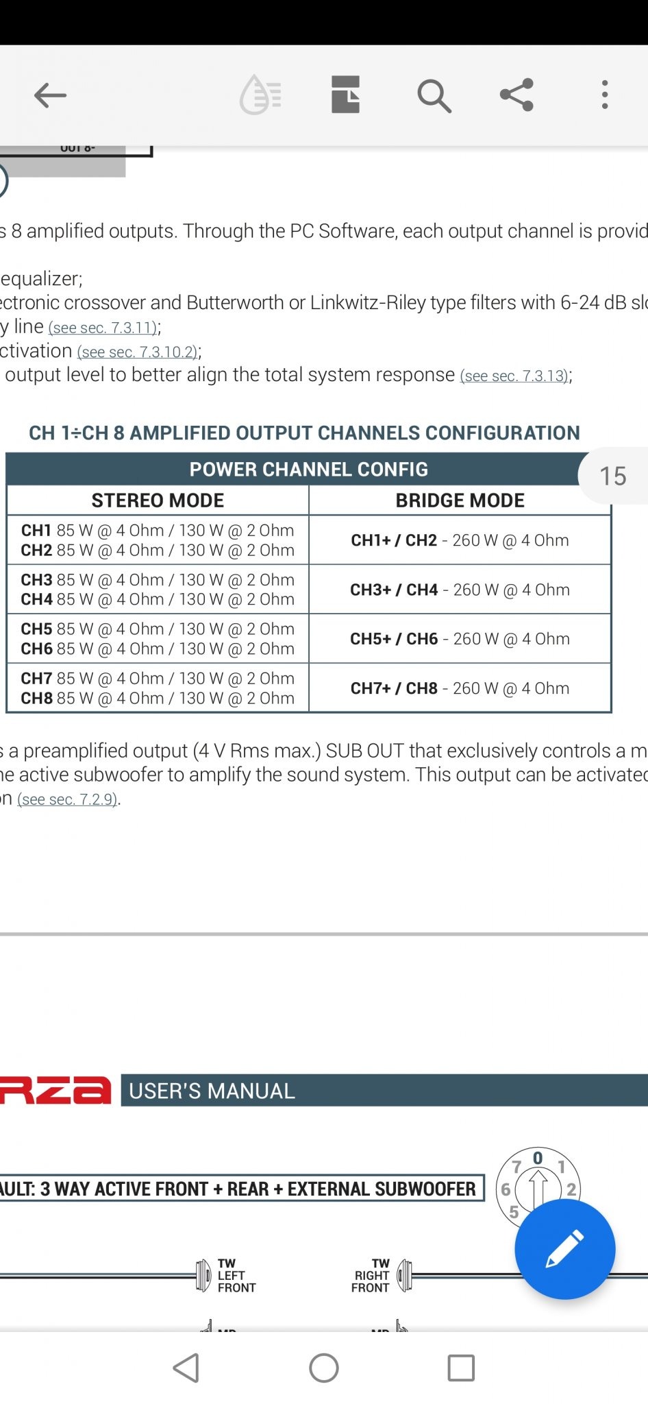

Which terminals are not used for bridging?
Those are the only terminals that you will test here. Check resistance between those terminals.

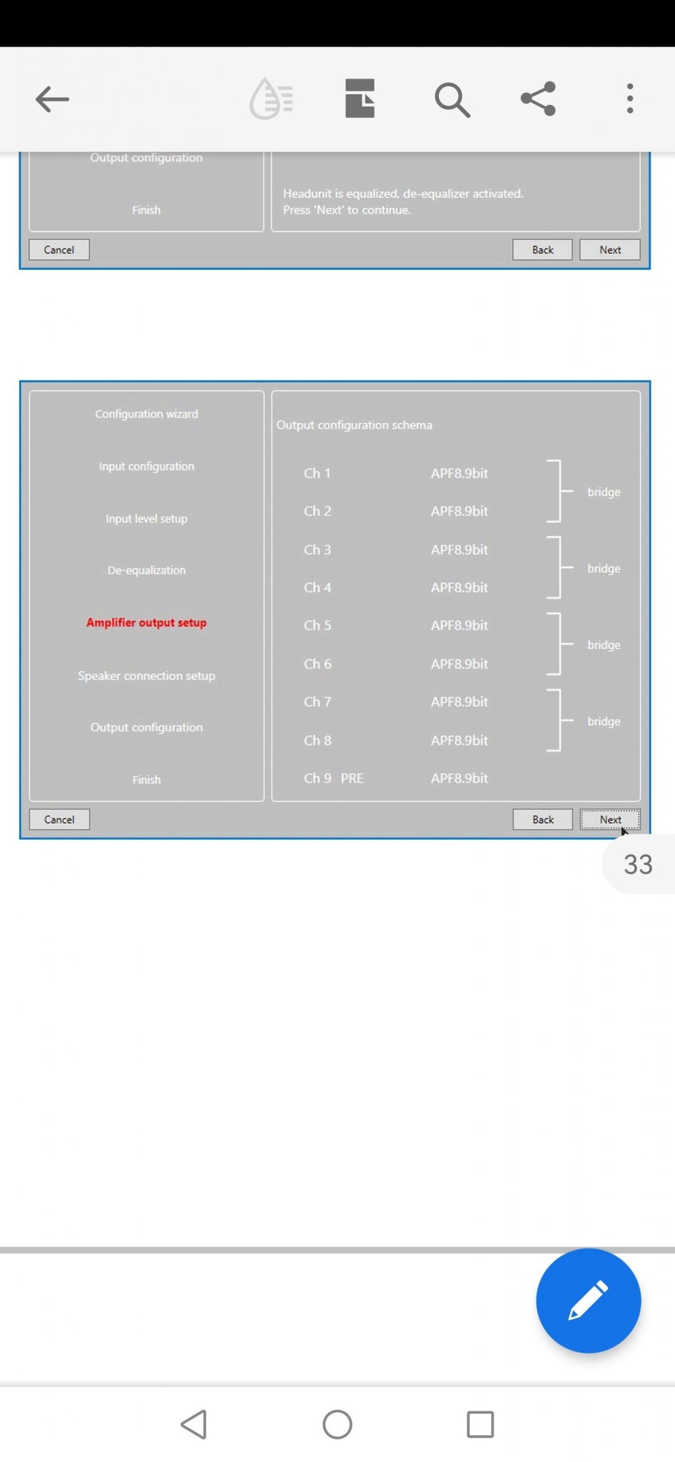

Hi Perry I haven't bridged any channels yet but will some be bridged? This is from the manual?

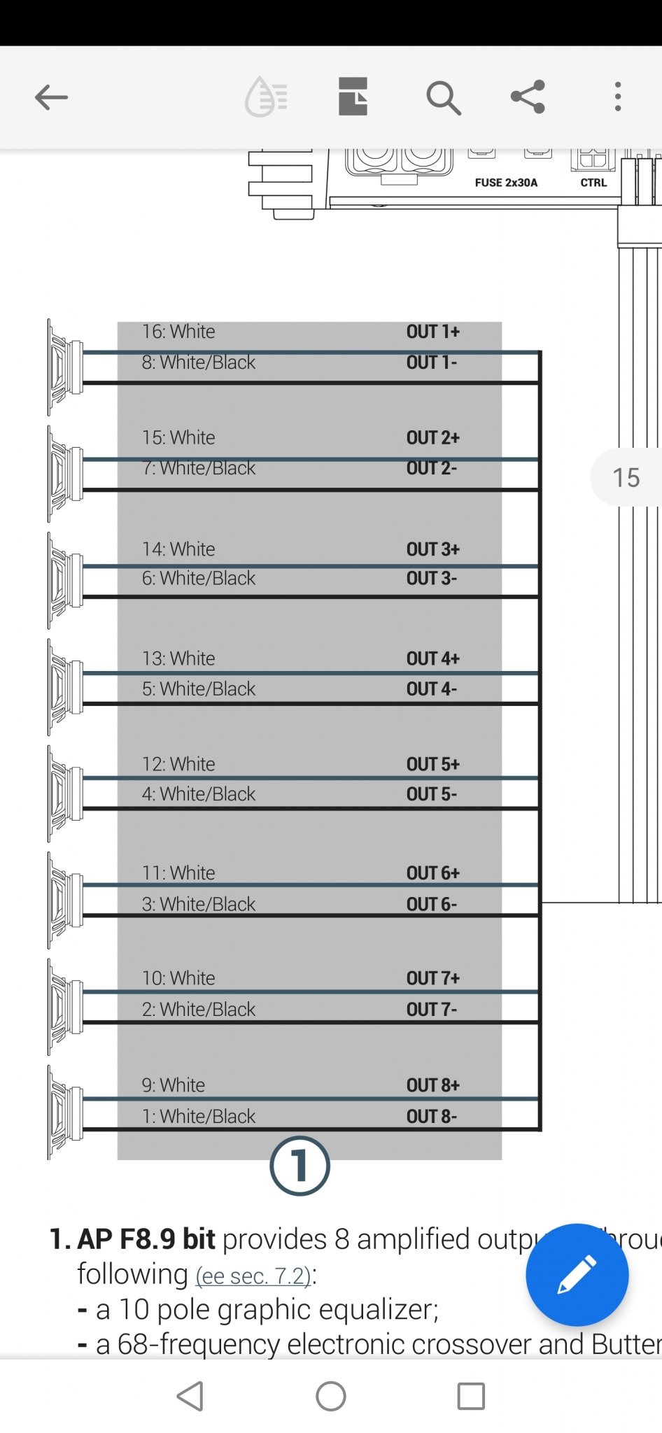

Hi Perry so before I check between the pos and neg, I check between each neg and neg?
Therefore 1 to 2, 1 to 3, 1 to 4, 1 to 5, 1 to 6 and then 2 to 1, 2 to 3, 2 to 4, 2 to 5, 2 to 6 and so on? All the way up to 6 to 5? That's a lot of combinations! 😩
For whatever row is negative on the speaker plug, just check to see if all of them are directly connected.
It would be VERY unlikely to do any damage with the meter on ohms and the amp not connected to anything.
