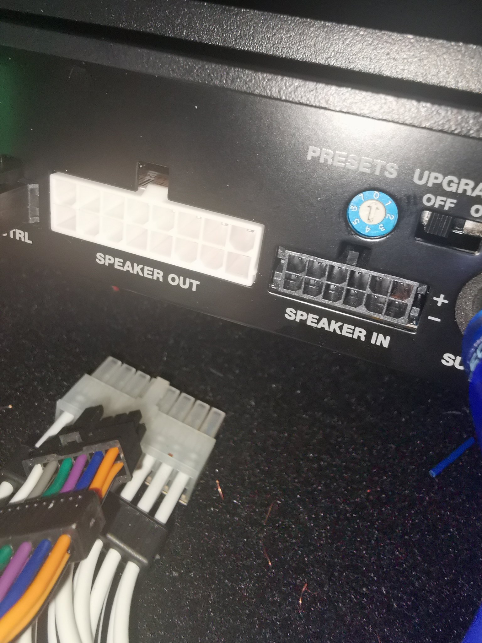

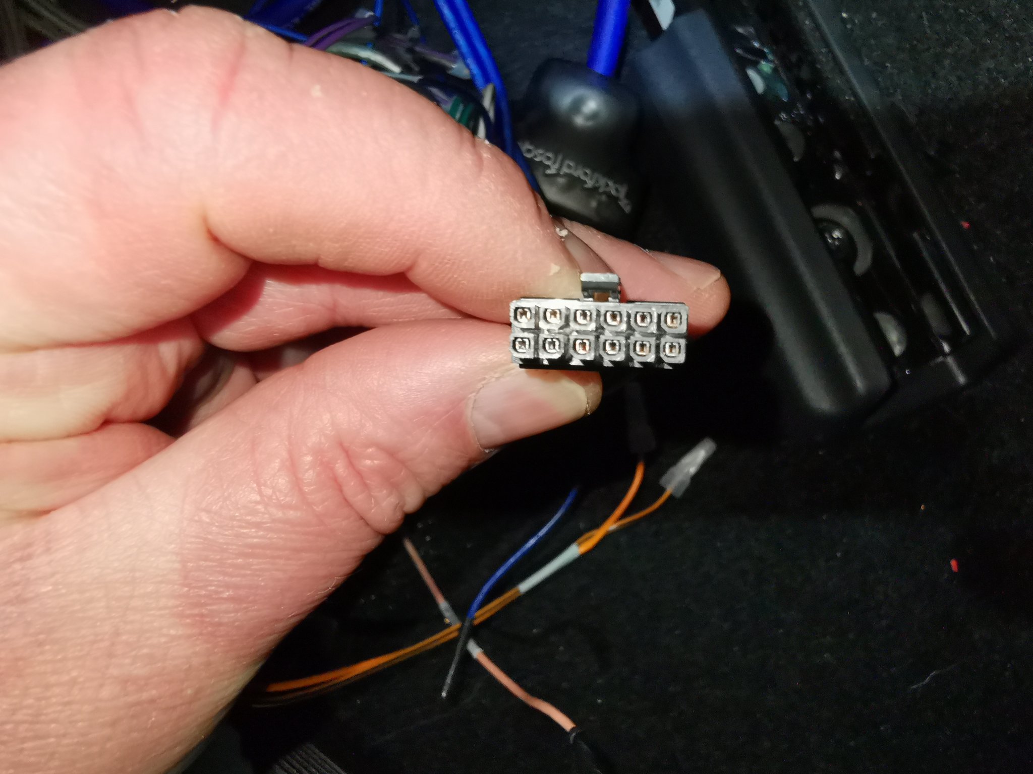

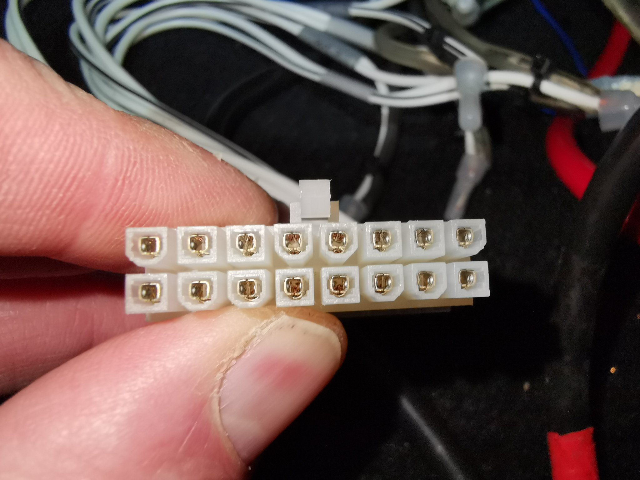

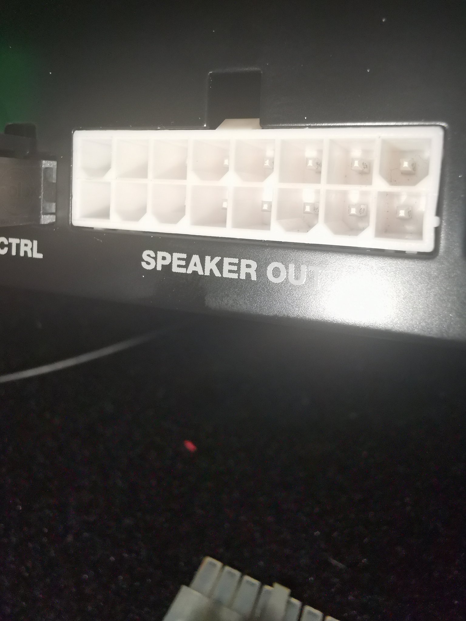

There are some (not many) inputs to amplifiers that are essentially ground. If you connect the output of the OEM amp to an input that's essentially ground, the OEM amplifier could be damaged. That's the reason for the tests above.

You're tapping off of the speaker output of the OEM head unit. In some amps, the speaker level input has grounded terminals. This is rare but has happened. I'm trying to confirm that your amp/DSP has no grounded inputs.

Post a photo of the nylon connectors (looking into them) on the amp/DSP.
Hi mate please note I've tapped off the speaker output of the oem 'amplifier' not the 'headunit' as my car has a seperate oem amp in the passenger side footwell (Honda Civic 2019).
Please see attached photos showing the speaker input and output plugs at the dsp/amp end.
