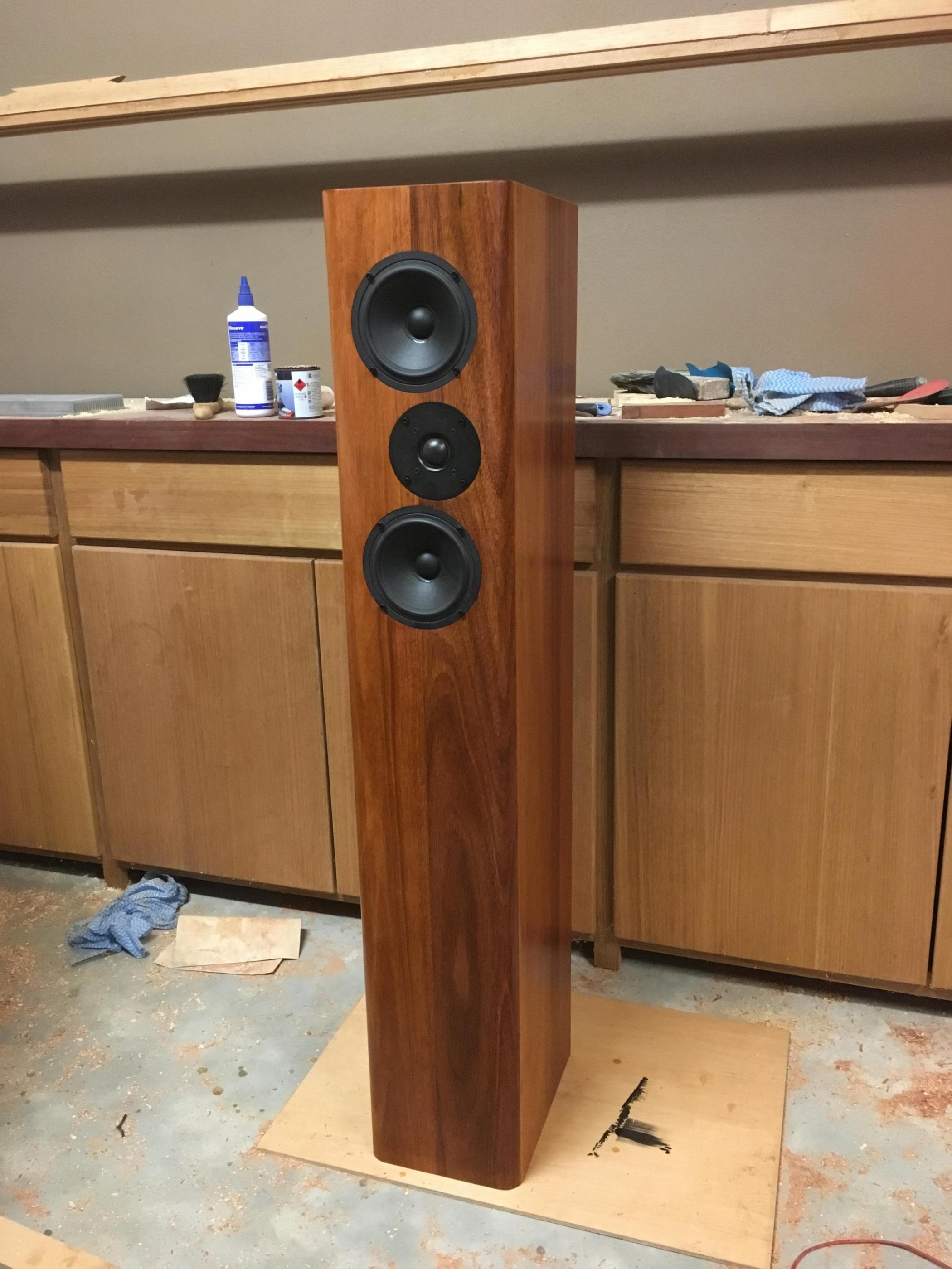

Suzyj, that is an object of beauty.
Wonderful.
