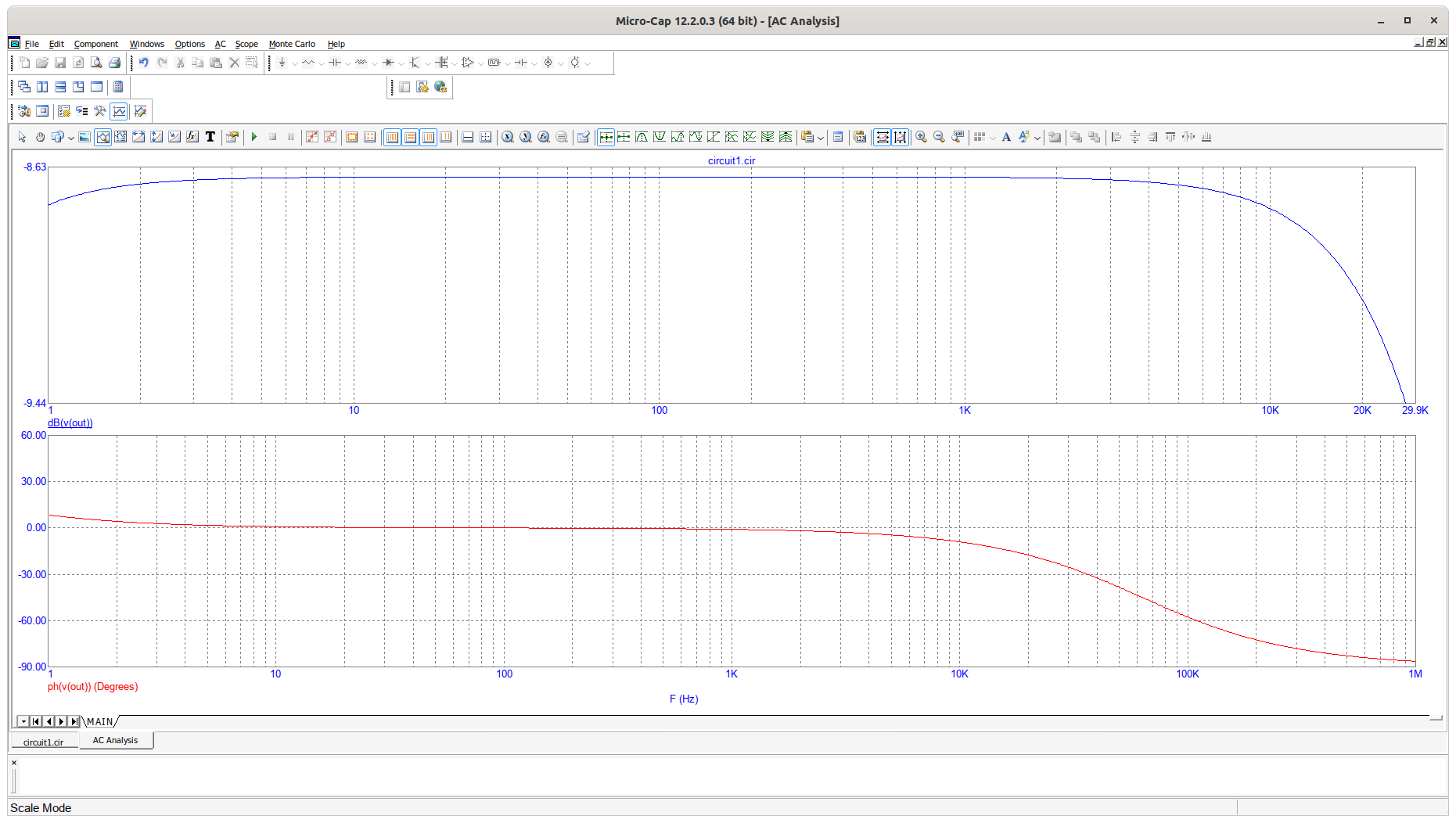

Just tested input filter alone in sim - looks like it has smaller impact , not 3db . So drop at hf must be then complex ,not only C31 related , probably after line inputs jacks filters present too ,before volume control .

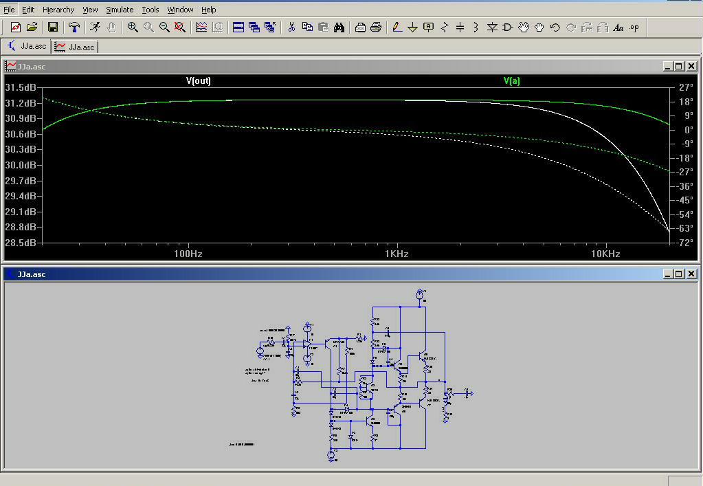

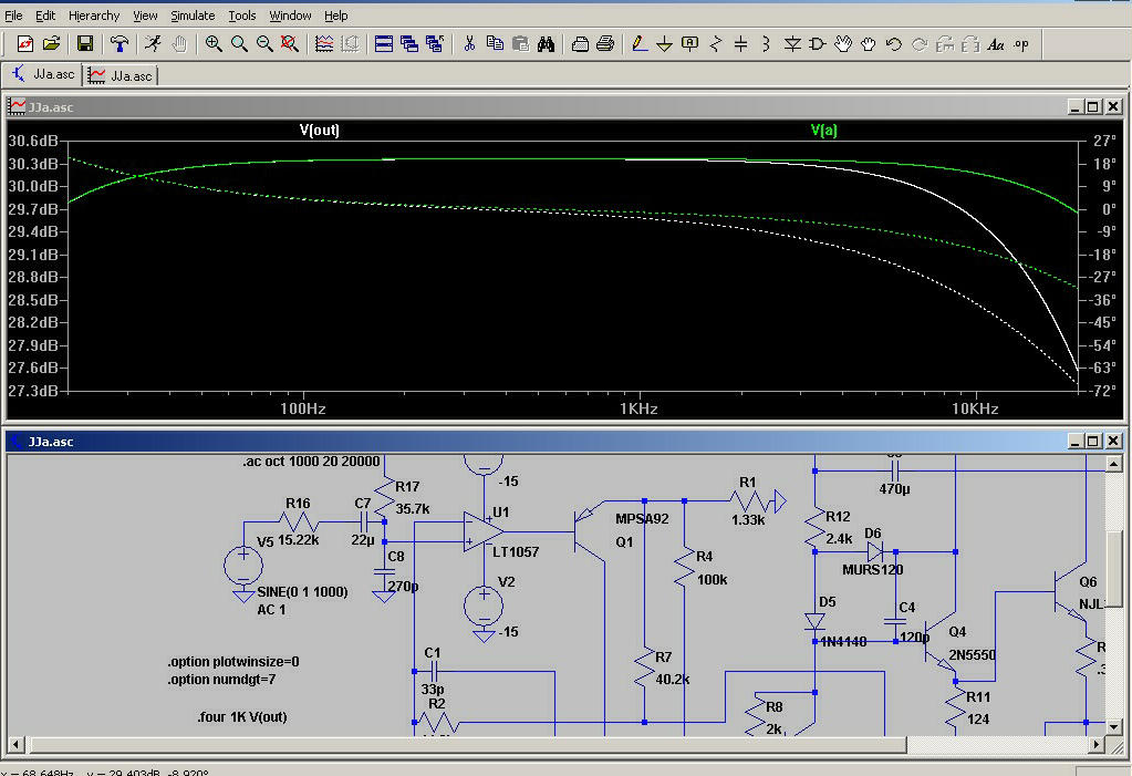

I made a simulation of the circuit using parts that
I had models for and only saw a .5 db drop at the output
before the inductor. I had to make the output inductor
50 uH before I could get a 3 db drop at 20 KHZ.
Output inductors are not usually that big!

So what numbers do we have now for 1khz , 10khz , 20 khz drop ? I don't see 20k point in picture .
But anyway its higher drop than just input filter in my sim test ,probably 33pf feedback capacitor has negative effect on frequency response .
