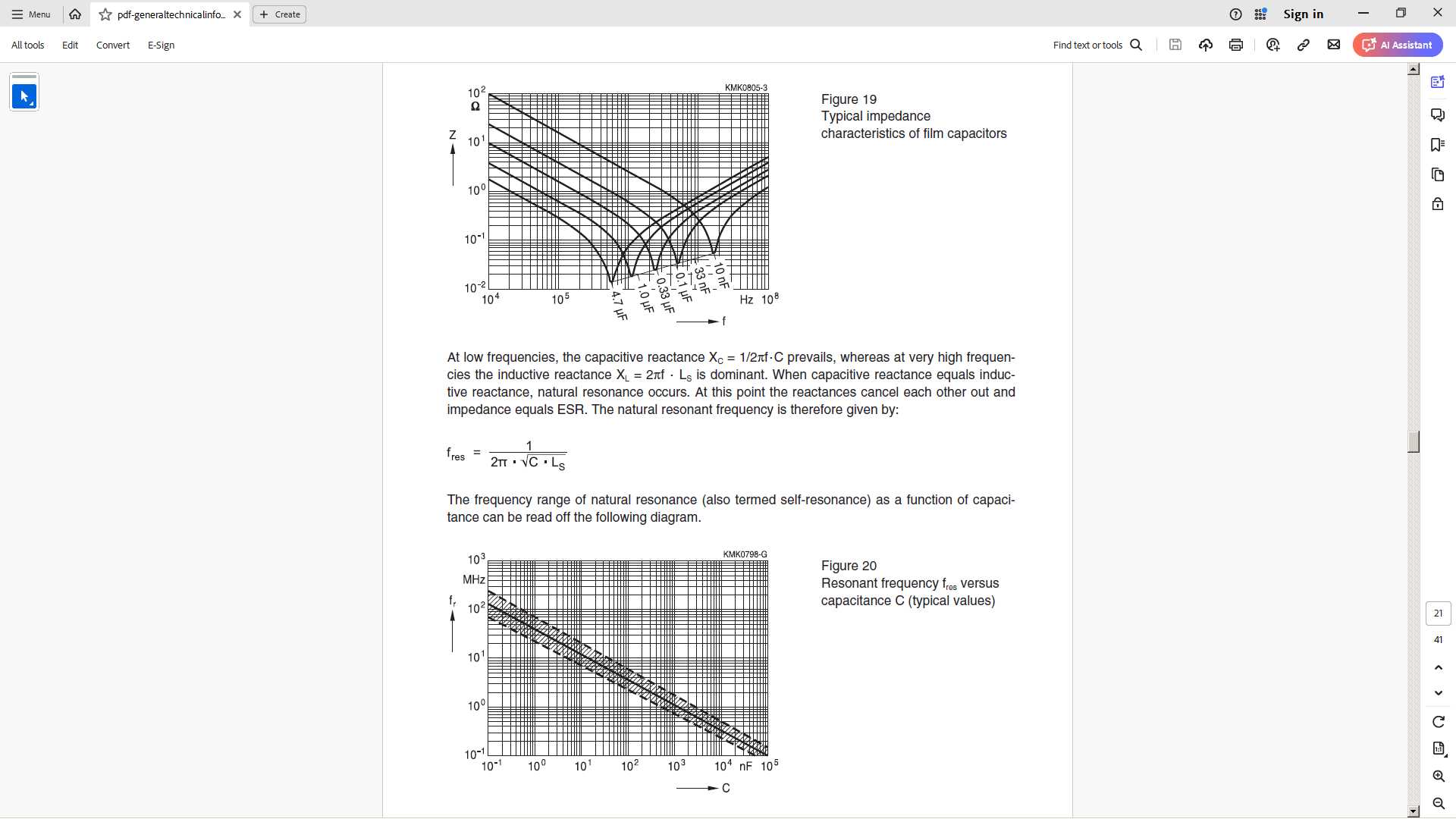

Using two or more staggered in value capacitors is a common engineering method to reduce the effect of self inductance in larger wound capacitors like seen in the pictures.I suspect simulator "designed" circuit by somebody who has no clue but just "threw some values in"
So if simulator answer was, say, "2.0024 uF" he obediently paralleled 2uF cap with a 0.0024 uF one"
Or something to that effect.
Fine in Simulator World, unrealistic in the Real World where "parts tolerance" is ... ummm .... "Reality".
As the data I attached shows the frequency of self resonance is affected by capacitor value.
Using spaced values of capacitors in parallel can be affective in reducing the effects of self inductance in the large film capacitors and provide reductions in possible phase shifts at high frequencies.
One could debate and disagree if this design is using the technique effectively however it seems the likely reason for the staggered values.
