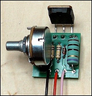

I’m thinking of installing a VVR from Ampmaker into my Vox AC4TV as I’d like to get some dirtier sounds at lower volumes. I’m not very experienced with electronics but I recently resoldered the connections on my telecaster selector switch, opening the thing up along the way, so I reckon I could put the VVR kit together without any problems. But I’m not sure if a novice like me would be able to install it in the amp itself.
I’m fairly technically minded and can follow instructions but I can’t read a circuit diagram, as yet. So I’d like to ask for advice from anyone out there who might have carried out this mod.
- How many steps are involved in the installation? I can only see three cables coming off the VVR kit - does it simply require three wires to be soldered in somewhere?
- Does anyone by any chance have something that approximates a step-by-step guide to installing this VVR with photos of the circuit board rather than a diagram?
- Is it possible to install the VVR and retain the AC4TV’s existing ‘attenuator’?

It is three wires that you splice two of the wires into the circuit, the third goes to ground. Look at the schematic (learning experience here) there is a power transformer below the EL84 tube, there are two resistors R14, R17, in series (in line) with Q2, Q3. They join together at that dot. Next to it is the filter capacitor 100uF with its own dot (the dots are a connection point). What you would ideally want is to insert the VVR two wires in between these two points.

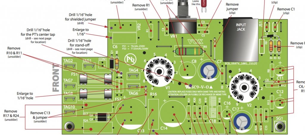

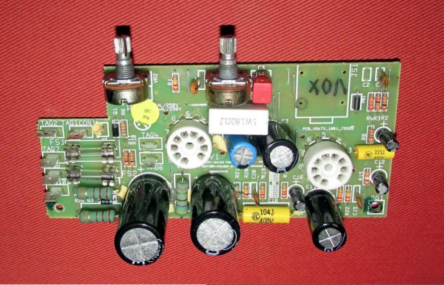

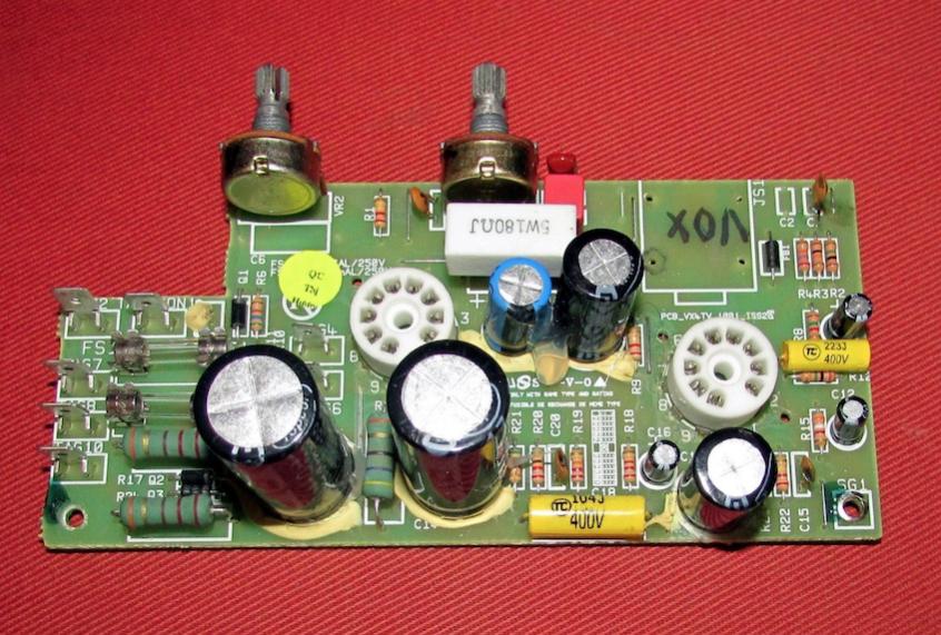

Here is the board, it is an Ebay ad so I don't know how long it will be up, save it if you can. (Anybody know how to past it permanently in this site?) On the lower left corner are the two resistors and two diodes. The resistors are the green things with the colored bands on them, the two diodes are black and have a bans on one side. Ideally you want to put the one wire where these two diodes join and to one side of the capacitor, the next part to the right of it.

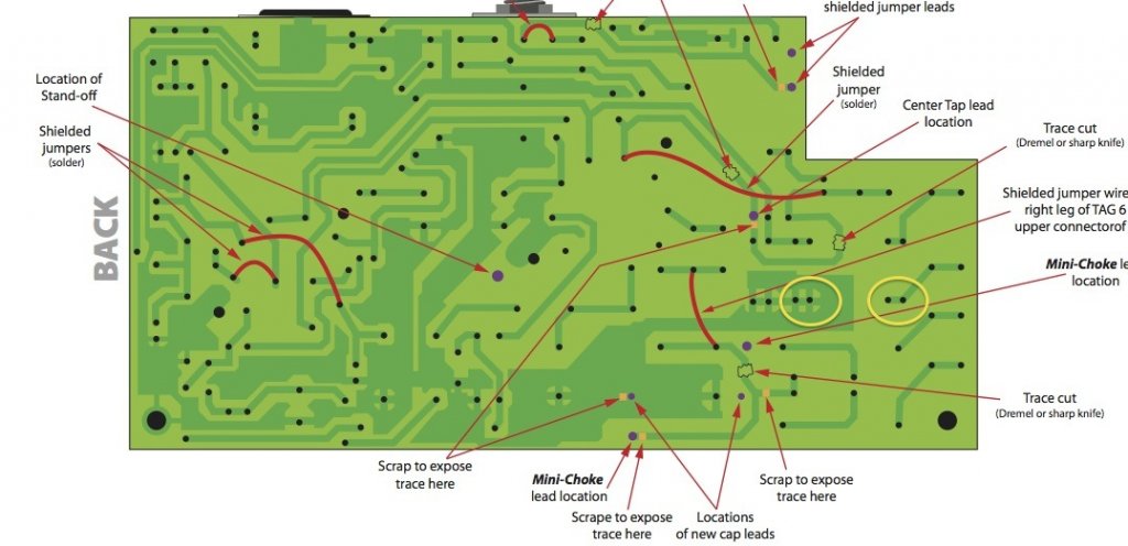

The problem is the it would require some surgery, cutting the trace between the diodes and the capacitor. Not too friendly a layout even for a tech. There is another option, not one usually done. Back to the schematic above, Between the 1000 uF capacitor and the 33 uF capacitor is a 470 ohm resistor. In the picture below it is in between the two capacitors under the tube socket. You could unsolder one end of the resistor, put one of the wires in the hole and solder the other wire to the resistor. The ground wire to a ground point again. The resistor should be supported rather than hanging from one lead so maybe a dab of silicone to the board could do. The end with the wire soldered to it should be insulated with a piece of heat shrink tubing.
What the VVR does in this position is that it does not attenuate the whole amp but does do the EL84 screen and the preamp. Lowering the screen voltage makes the tube less sensitive and you end up turning the preamp more. I don't know if you would get the same sound as having the VVR in the first position, I have never tried it myself. Just throwing up ideas and hope others decide to weigh in.

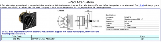

L-Pad - I've just been reading about replacing the AC4TV attenuator with an L-Pad. I think I could get a 8ohm 15w mono L-Pad for about £10 and this would be a straight swap. (possibly it wouldn't fit in the same space and I'd have to locate it somewhere else on the chassis)

After weighing up the options, taking into account the cost of an amp tech to install a circuit and the cost of an amp tech to fix my amp after I've tried to install a circuit, I've decided to go down the L-Pad solution.
I'm going to buy a Carl's Custom Speaker Soak or a TubeJuice Speaker Soak or, failing that, I'm going to buy a 15w 8ohn L-Pad, put it in a stomp box and connect between the amp and the speaker. I know, for many ears, this won't make for the perfect tone but I'm only just getting into playing the guitar again after many years away so I'm sure it'll be enough for me.
