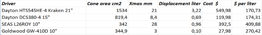

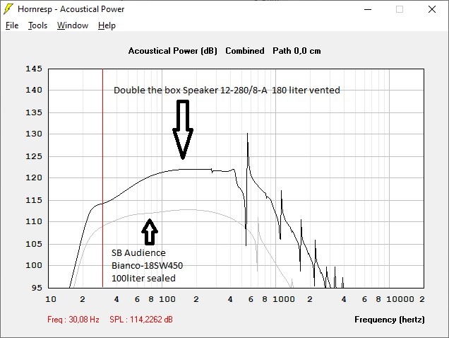

That is a good idea, though it would take some work to incorporate and sort those suitable for vented and those that are better suited for closed boxes.Why not create a simple spreadsheet like this?
I really like closed boxes, but vented enclosures have their advantages, when battling for output vs cost cheaper lower xmax drivers in a vented enclosure may beat a higher xmax driver easily.
In this example the cheap double 12" outperforms the higher xmax 18" by a fair amount, I estimate cost of enclosure to be similar because the 18" would require more heavy materials and bracing since the energy has no way to escape. Amplifier costs would be about the same.
Edit:
I had to use EQ to get more low frequency output and pad down a significant hump from the 18" centered around 60-70Hz somewhere, gentle sloping is okay, big hump is a no-no.
It could be nice to have something like that ( spreadsheet).
Isn't it what Patrick Bateman did around 2015? He came to conclusion Alpine 15" was best buy at that time iirc.
I'm ready to help with that but i think we should define how to display the info/ have a template.
I like the idea to have sealed/vented (even other options) but i think it's not going to be easy: a linkwitz transform could make almost any driver suitable for sealed ( with limitations of course...).
