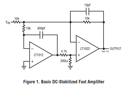

Can you give us an example of how you implemented composite op-amps in Scaler and apparently the ADC-iso? Maybe I'll cobble up an active filter with a composite op-amp one of these days.

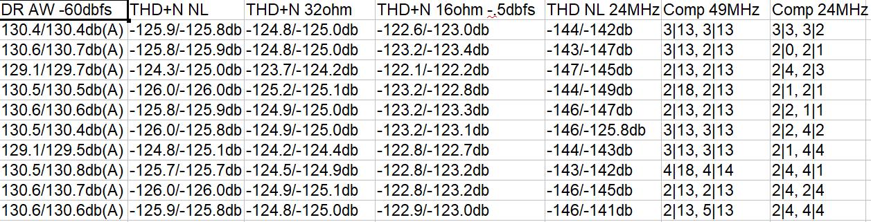

Last weekend I tested the first production panel with 10pcs 9039S PCBA. Each DAC was tested with a Windows PC USB3 port + 2m good fully featured USB2 cable for close to real-life conditions. 16ohm loaded(Cosmos Load-board has 16.1ohm yet) results would be better with a shorter cable + powerbank and so on(see Archimago's review). Cosmos APU LNA 34db for the DR test, Cosmos APU notch +6db for the THD+N tests, and THD test used APU notch 0db.
32/96 DR AVG = 130.32db(A), No load 32/96 0dbfs THD+N AVG -125.66db, 32ohm loaded 32/96 0dbfs AVG THD+N -124.77db, 16ohm loaded 32/96 -.5dbfs AVG THD+N -122.935db. Interestingly, for the kind of Sine_gen mode(MCLK = 24MHz 1db higher noise but less harmonics) THD compensation coefficients are nearly zero(between 0 and 4), and all samples have at least one channel with all harmonics <-150db!

About composite, are you referring to the PDF in post 1 of the link? That is only accessible if one registers in the Russian forum. Can you explain how it differs from classic composite?
capslock You are damn right ;) 9038Q2M of course, thank you for the correction, actually, I decided to post that txt on the 9039S product page..
PS: the composite looks like this: -IN of 1st and 2nd opamp are tied together, Output of the 1st opamp goes through the R/C voltage divider(but not R/R as a classic one to get extra Aol in audio band) to the +IN of the 2nd opamp.

Not quite what I would make from Ivan's description. Below is my interpretation. The low pass instead of the resistive divider used in the old National Semiconductor app note and the Neurochrome is a neat idea (though the Brainstorm works without any resisitive divider: https://zelfbouwaudio.nl/forum/viewtopic.php?t=22898&sid=70857f49bf17df243f8e7d84720d994e). I am pretty sure U1 needs a C or a series RC to provide local feedback (dotted line).
With the two op amps sharing the - input and hence the feedback, U2 essentially becomes a unity buffer. If it weren't for the capacitive divider, it would need to be unity gain stable, or in other words, if U2 is unity gain stable, maybe you can get rid of the capacitive divider?
I don't really see the advantage of having the two share the feedback network and jump through hoops to make the thing stable. Why not give U1 its own feedback set at somewhat lower than the overall feedback?
They are not sharing the feedback. The master OpAmp increases the error voltage gain for the slave OpAmp, as seen between its input pins of the latter. In both circuits.
In your circuit, the slave's -IN connected to the main feedback divider just means that the master's output follows the input voltage (+ the small correction voltage on top). If that -IN were grounded, the master's output also is kept at ground (+ correction voltage). Doesn't make much of a difference.
Master = U1, slave= U2? If so, and if gain = 20, the LF output of the master will be 20x input + some error. The slave's output will also be 20x input + a smaller error. What both cuircuits?
yes, like this.
