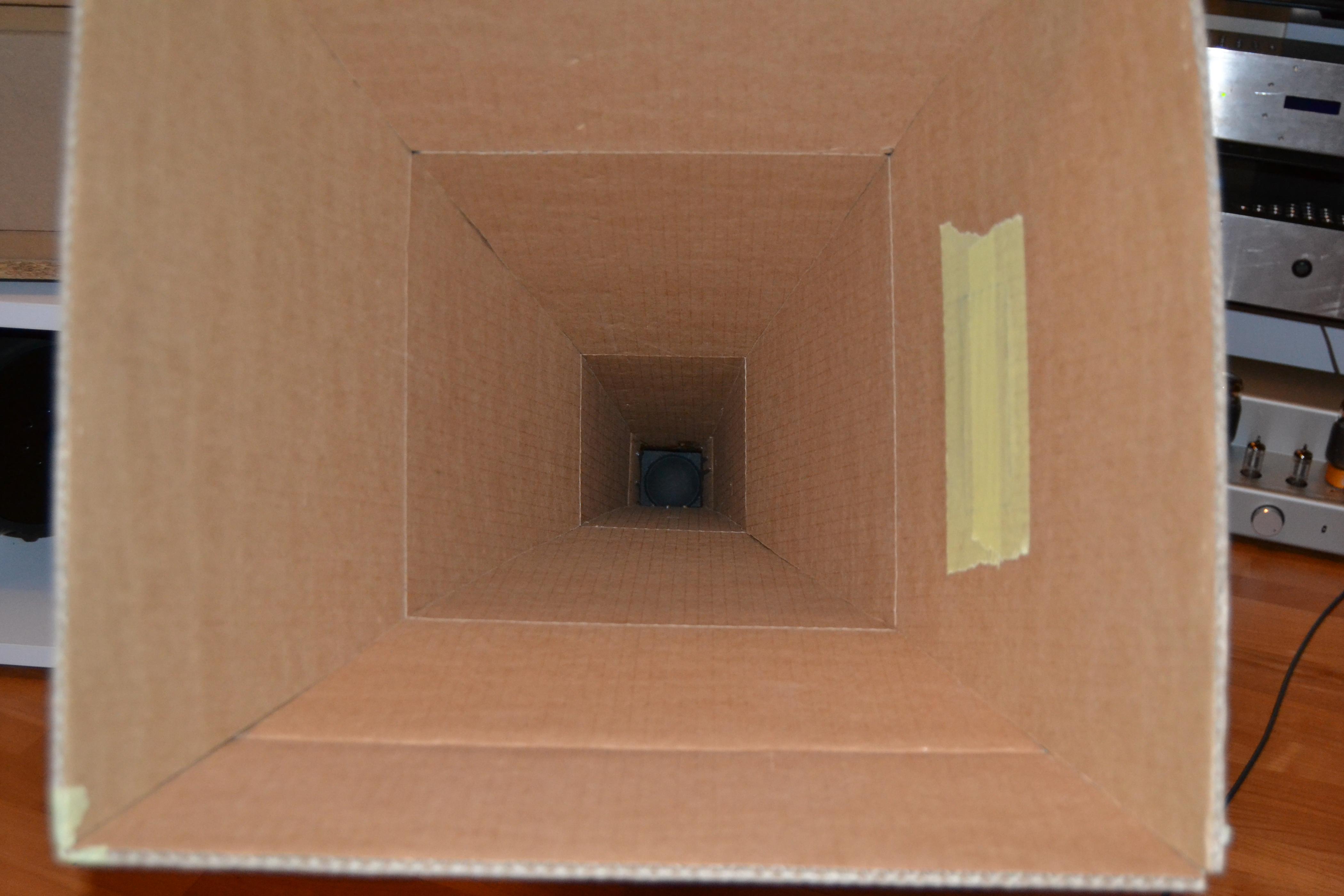

I used an old plasmascreen box to make midbasshorns.
Looks great, but what is it? I have never heard of midbasshorns before. Sorry. What are you going to cover it with? Lots of speakers out there made of cardboard, but nothing that looks like wood.
There were some pyramid shaped speakers someone made...
They are horns reproducing the frequency range from upper bass to lower mid.
In my case from 150Hz to 600Hz, with an 8 inch driver.
Further information about the original design can be found on John's pages.
135 hz Mid Bass Horn - The Paper Horn by Inlow Sound
Although my version really does have only the horn profile in common with John's design.
Not really of much relevance to your thread other than it being made from cardboard ofcourse.
Or maybe you can make a horn for your driver? 🙂
The dustcap of the driver can be seen at the beginning of the horn in the attached picture

I could not figure out how the horn works: I associate a horn with the awful bullhorn hand held speaker, with its headache - inducing resonances.
Apparently this need not be so, and for a small space, maybe a folding of the horn will work.
Wikipedia explains it quite well here:
So you are creating a sort of an large speaker diaphragm made entirely out of an air column, these seem ideal for the low power amps that I am using and hope to continue using, I can even get a hand built tube amp made for about $100, so all things are considered.

An acoustic horn converts large pressure variations with a small displacement area into a low pressure variation with a large displacement area and vice versa. It does this through the gradual, often exponential increase of the cross sectional area of the horn.
Yes for low wattage power amps, horns are very useful, this is basically why they were invinted, back when watts were far between.
I am no expert but your conclusions are valid.
Horns can be designed free of annoying resonances and with the right driver can deliver low distortion dynamic sound.
They can increase the drivers coupling to the air and control directivity of the speaker
There are horns that load the front of the driver and there are those who load the rear of the driver, they are quite different, some take advantage of both.

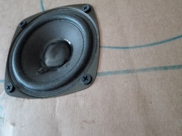

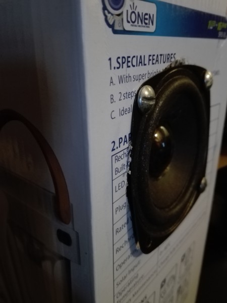

Cardboard box is not suitable
The thin walled cardboard box, while sounding fine, was simply not strong enough or stiff enough to mount the speaker without the front panel bending as shown in photo.
I will have to use a thicker corrugated cardboard box, testing the mounting of the speaker first since this is a weak point of installations so far.

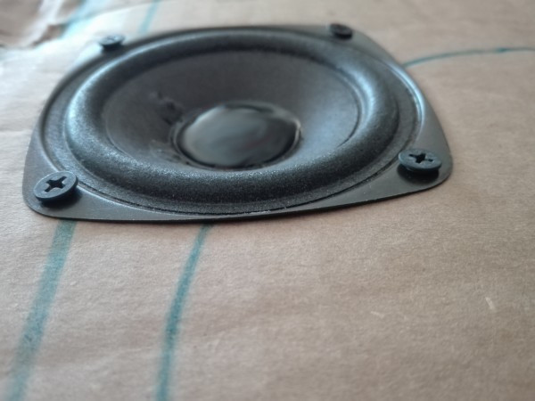

Use triple ply corrugated cardboard for baffle. Add thick squares of triple ply after screws go. Use hot melt glue for quick assembly. Can add thick ply baffle to thin ply box. Or foam core box.
Better
Much better as seen here, this is "double wall" corrugated cardboard. I will use proper bolts instead of the wood screws, but this arrangement is much more secure. I need to seal the gaps though, maybe white glue will do it.

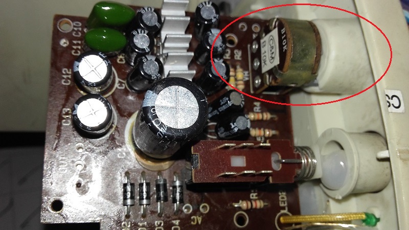

Better with TEA2025 2 W per channel
Better with the TEA2025, adequate power, full volume was not needed. Should be better after complete sealing and internal damping as well as adding extra panels to the inside.
Picture of 2025 board from an earlier post:

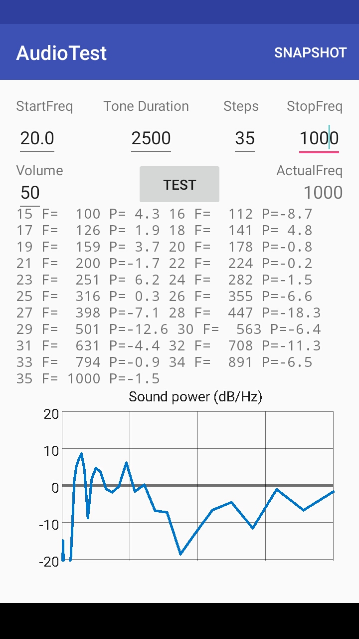

Latest testing showed some distortion at all levels, 60 -70 dB sound levels. I will be going for a crossover after all, common crossover frequency is 4000 Hz though I remember from earlier testing years ago I settled at a 470 uF capacitor for the best sound. This site suggests

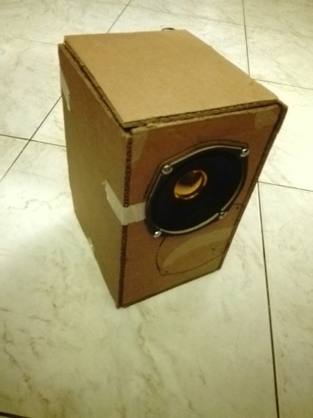

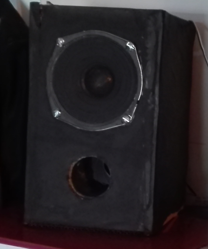

Completed
The speaker has been completed, painted with black paint on the front panel, and covered with black paper on the sides. Ordinary poster color like paint was used.
It sounds good sometimes, sometimes distorted, which has to do with the speaker wires and tiny USB amplifier. All in all, I have had some very good listening sessions and have heard musical sounds never heard before on tracks I have heard before.
Completing the other side.

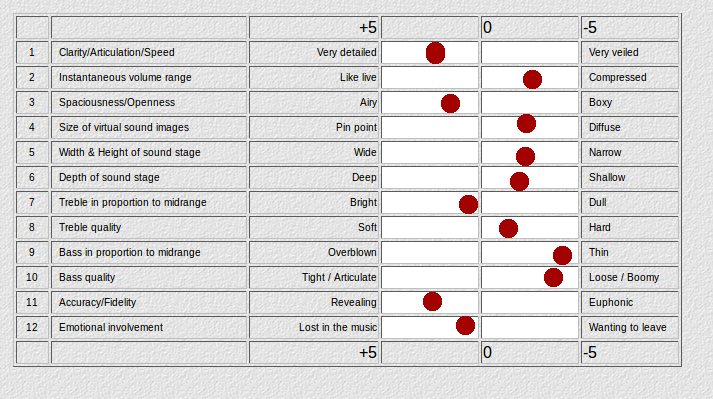

How do they sound? With streaming audio from a subscription service, (Yonder, iTunes, Wynk..) they sound good. On the Linkwitz scale:
I had a great listening session yesterday, very enjoyable, especially light rock.
One problem with these speakers, not a problem with the speakers themselves actually, is that different recordings require different tone settings to play back with the correct tonal balance, and tone controls I do not have. For example Peter Gabriel's "SO" comes across nicely but Sade's "Promise" (both CDs) even though it is a CD, sounds a little more subdued.
One option then is to make the speakers a little bright to compensate for the varied recordings and to use tone controls.
The other option is to go two-way: testing with a tweeter showed much better reproduction of highs, needs toning down a bit, but two way seems the way to go, at least at my budget levels.
