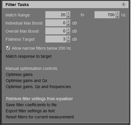

I proceeded a bit today. Found several posts on the AV Nirvana forum on this subject, as well as some more or less informative youtube tutorials. This is what I learned so far:
And I set the max boost level to 0 dB (default after installation was 9 dB).
Results: naturalness is back. Excess harshness in sibilants and violins is mostly gone. Some harshness remains, though, it's obviously a property of these Tannoy tweeters.
Balance is fine mostly, it appears to be that limiting the filters to 700 Hz max still shows positive impact.
I'll perform new measurement runs tomorrow with varying mic placement and then report back. Also I will generate several more filter files with varying upper frequency limits, let's say 350 Hz, 700 Hz, and 1400 Hz.
Still looking forward for any advice by more experienced users.
- Limit digital room correction to 500 - 700 Hz maximum frequency. Everything above that range should be done by physical means like absorbers or diffusors.
- Do not allow any filter boost.
- Perform several measurement runs per channel, with slight variations in microphone placement in all 3 dimensions.
