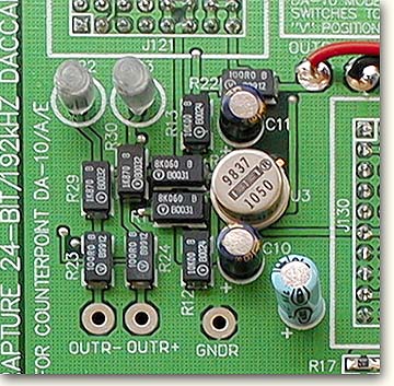

Vishay SMT
Vishay SMT as used by Michael Elliot at Altavista Audio, a man with excellent taste in components for audio.
H.H.

Your picture shows one flavor of the Vishays; there is also another style that's more bare-bones and looks more like a standard SMT resistor though larger in size than the usual 1206
