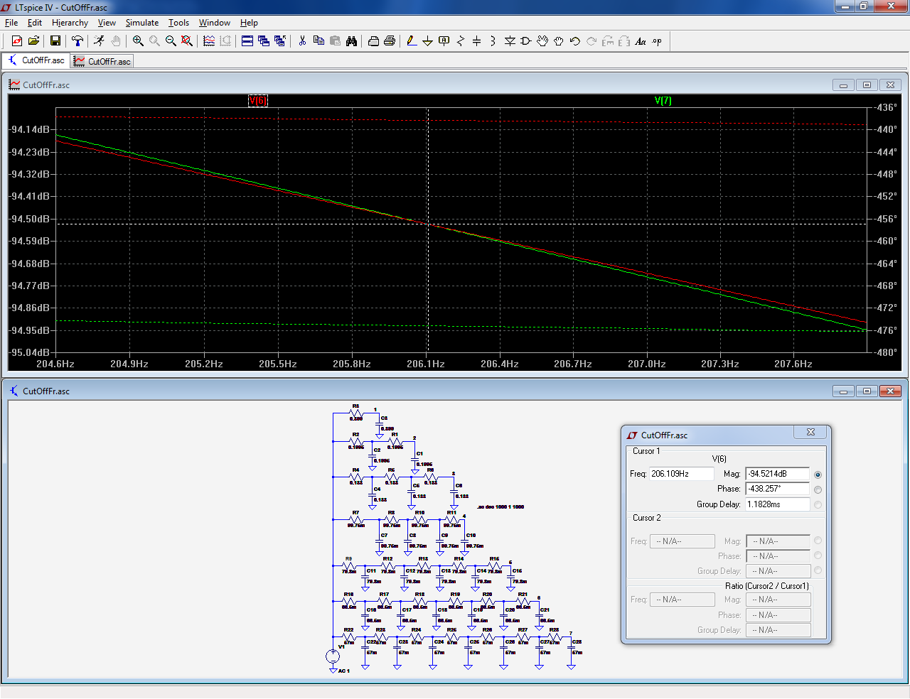

Using simulation, I derived the "switch frequencies" for a number of poles up to 7 by looking at the intercept frequencies for poles n and n+1.
The frequencies are normalized to 1Hz: the cut off frequency for the total aggregated R and C is 1Hz.
The first intercept is 12Hz: if the frequency to be filtered is above 12Hz, it becomes interesting to split the total in two cells.
Here are the results:
n=2 12Hz
n=3 32.68Hz
n=4 62.72Hz
n=5 101.66Hz
n=6 149.4Hz
n=7 206.1Hz
So far, I have been unable to find the "law" hiding behind these figures. With some imagination, the ratio between the the first and second step could be e, but other than that, I cannot find anything consistent.

Those numbers look like a quadratic in n. Hang on.
Yeah, dead on correlation 0.999.
f=4.48n^2 - 1.48n - 3.05

Congratulations!
Now, your next mission (if you accept it) is to find the meaning of the coefficients in the equation: since it is normalized to 1Hz, they are certainly not some random figures: they have to be related to Π, e or something similar
