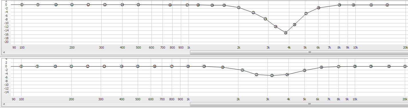

Here's an example of EQ I have to apply to make my 3 ways listenable on bright / forward recordings.
The top example applied to R.E.M's greatest hits works well
The 2nd example - one of the BBC dip flavours works well on a variety of 80s compressed rock and pop.
The images were taken from Equalizer APO (on windows). This great piece of software allows you to run and combine multiple equalizers (fixed or variable bands) and also notch filters (fixed or varying Q):
Equalizer APO download | SourceForge.net
Highly recommend this if you want to isolate problematic frequencies or source material.
The Q notch filter is great as you can dial up or down the frequency as you play a problematic track to "Centre" on the frequency of most annoyance.
