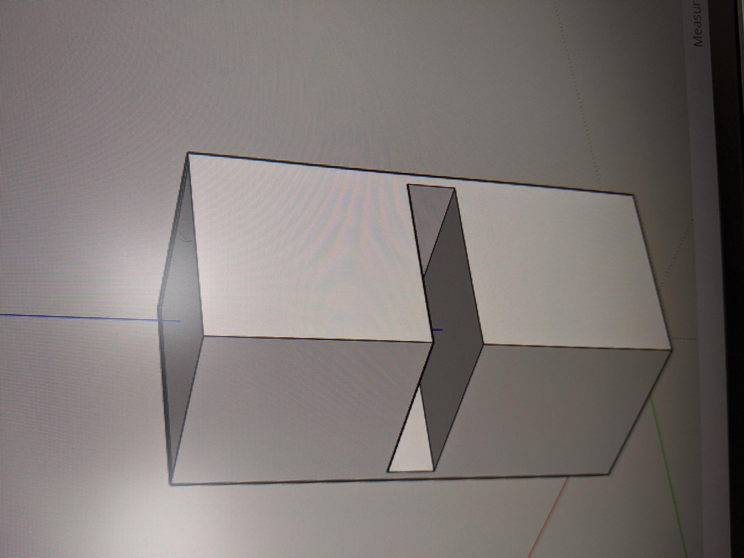

Corner loaded PPSL Plenum ?
Is there any reason this sort of Plenum (enclosed by 2 sides rather than. 3) would not work ?
Would it be superior / inferior to a conventional plenum ?
Sorry for the impromptu screen grab pic

1)Is there any reason this sort of Plenum (enclosed by 2 sides rather than. 3) would not work ?
2)Would it be superior / inferior to a conventional plenum ?
1) No.
2) The resonance frequency and gain associated with the 2 sided plenum would be different from a 3 sided plenum, whether deemed superior or inferior would depend on your desired outcome.
The stiffness of the enclosure as shown would be less in the 2 sided compared to a 3 sided, generally "inferior".
The tendency to place objects on top of horizontal surfaces would generally result in the 2 sided plenum eventually becoming three sided, so I'd be inclined to design for that inevitability, and also avoid the problem of unwanted items falling/spilling into the vibrating hole by building 3 sided from the start.
1) No.
The desired position would be vertical (had to take a photo of the screen since I'm at work - and which resulted in an image rotated to landscape rather than portrait mode).
Good catch re. stiffness. I guess a brace at the front of the plenum could partly address that issue.

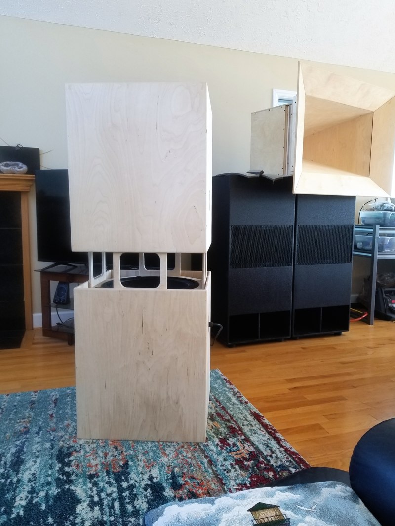

I like your idea 🙂 So much so I've been working on a similar build 😀
But mine is designed to be modular, where I can use subs singularly, then stack them for push-push, and put them in corner if additional plenum effect and corner loading is desired.
First coupler try may be a little short, since I'm trying to run both direct radiator and ports through the slot.
They sound great stacked, but I'm not getting a full +6dB coupling like I get when they are side by side.
Getting there...
I say go for it...make it where you can either rotate drivers or turn whole box upside down if you are concerned with cone sag.
