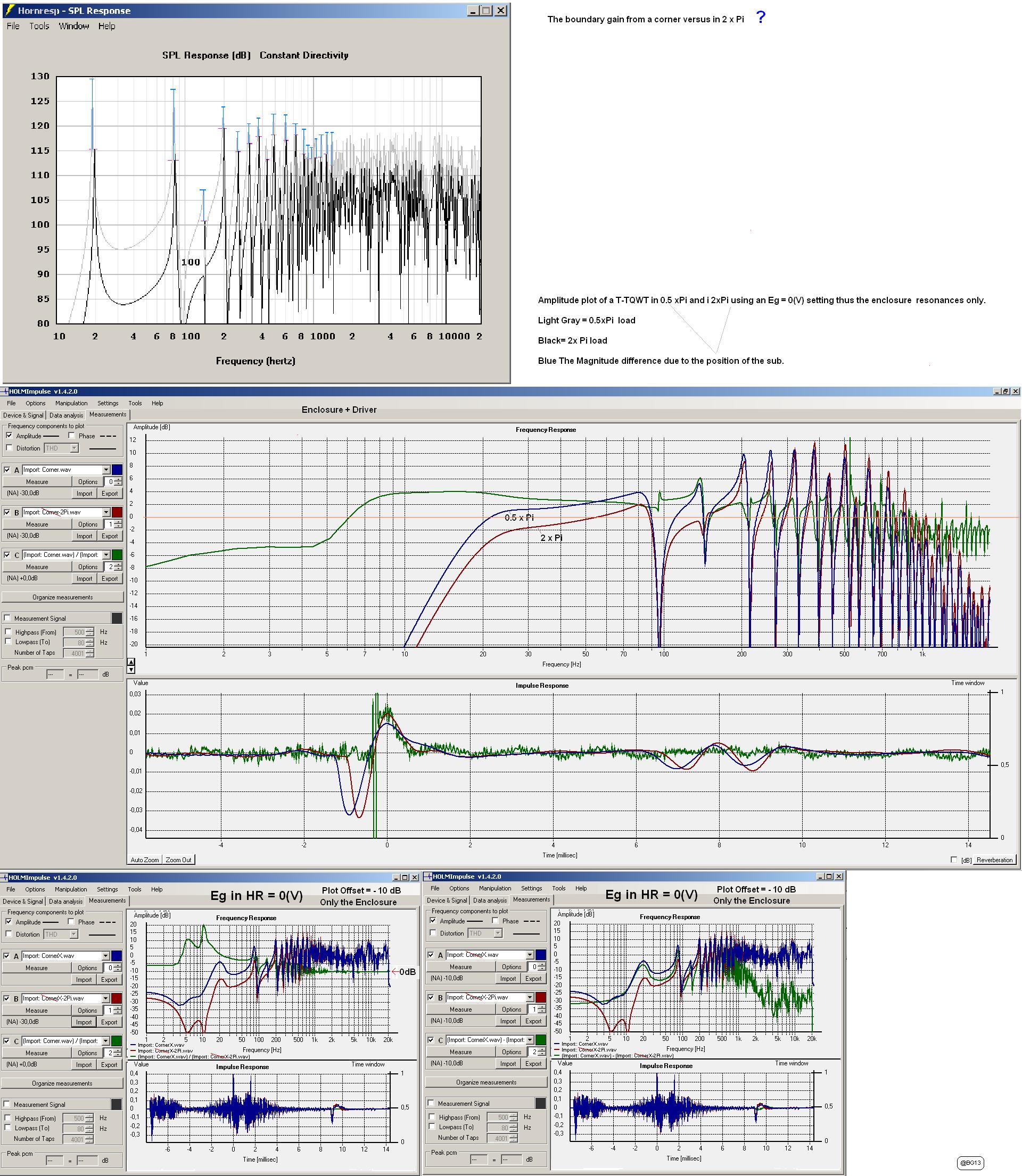

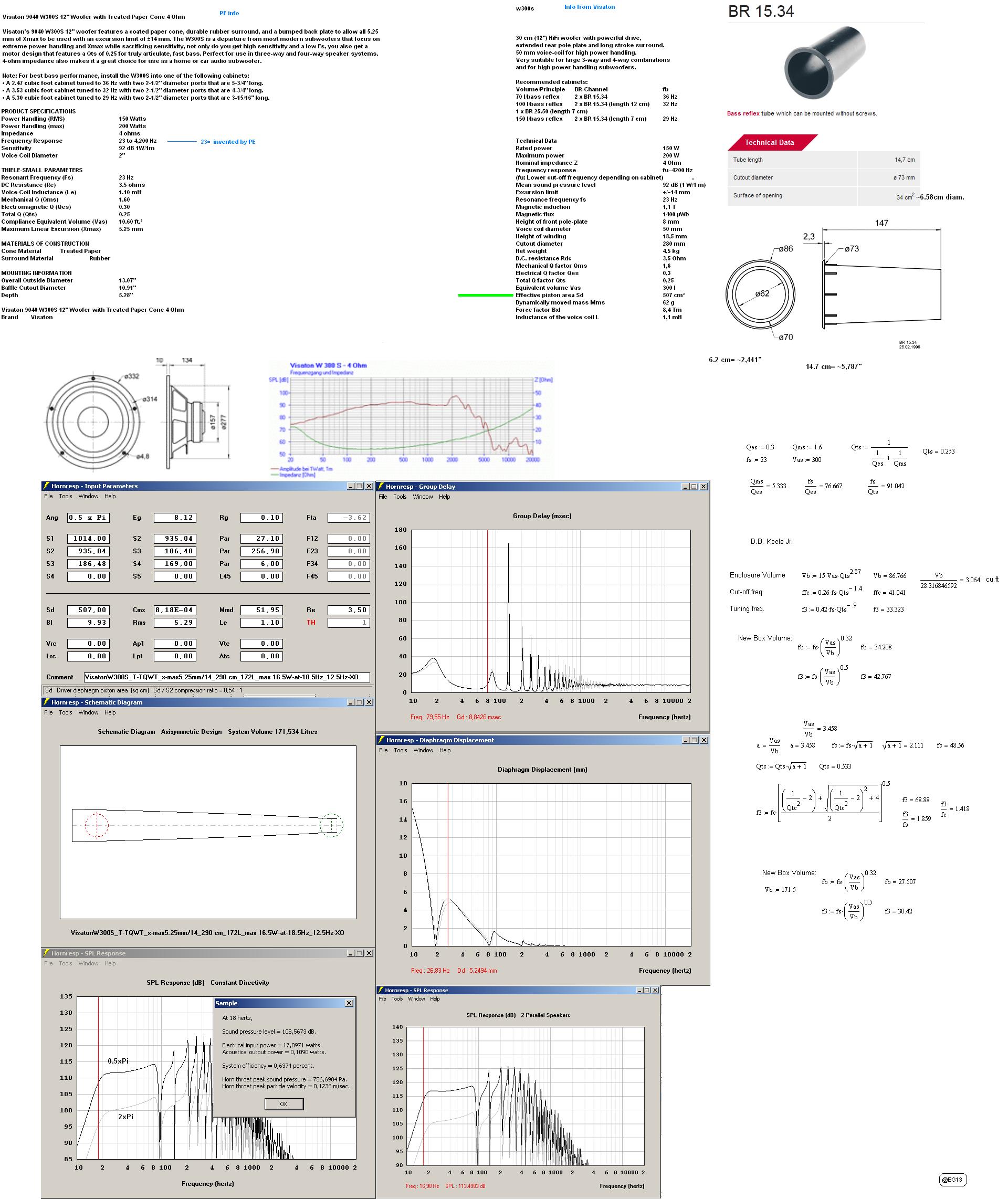

B bjorno R.I.P. Joined 2005 2013-02-11 5:52 pm #21 2013-02-11 5:52 pm #21 Hi, A suggestion almost within the Budget, if built would probably be beyond expected performance?😀 b🙂 Attachments Visaton W300S-4.jpg 483.9 KB · Views: 318 Corner gain -versus-2Pi.jpg 775 KB · Views: 297 Last edited: 2013-02-11 5:55 pm
