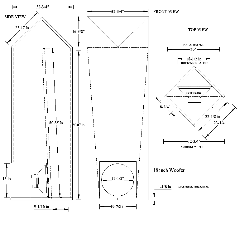

I was thinking something like this:
I need it to go from about 60Hz down, preferably with output at 15Hz. I want to use either two 25w plate amps or two 50w plate amps, even if it could handle a lot more than that just to prevent excessive SPL levels.
What should the final segment length be? The distance from the corner to the listener?
And then should the size of the mouth be the cross sectional area normal to the corner from the listening position? I would guess that it won't matter too much what it specifically is as long as it is in the ballpark because the mouth will be so large.

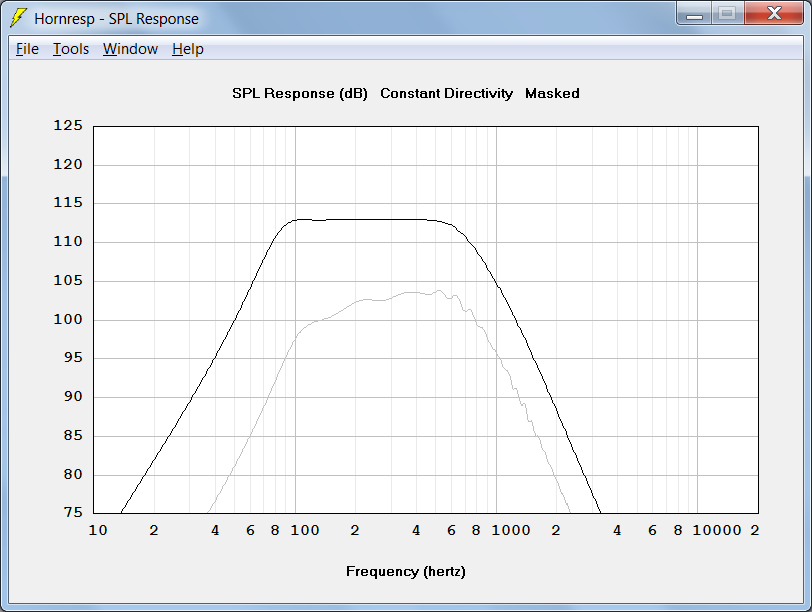

Hmmm I've used that before and I thought it pretty much just increases output over the whole range.
Hi kctess5,
Not so.
At very low frequencies there is a theoretical +6 dB improvement in SPL response each time the solid radiation angle is halved. 3 dB is due to improved acoustical loading conditions (enabling twice the power to be radiated), and the other 3 dB is due to the doubled power radiating into half the space. Going from free space to eighth space therefore gives an 18 dB increase overall.
At very high frequencies (assuming constant directivity) there is only a +3 dB enhancement - the acoustical loading conditions do not change when the solid radiation angle is halved. Going from free space to eighth space therefore gives a 9 dB increase overall.
The attached example shows the difference going from free space (4 x Pi) to eighth space (0.5 x Pi). The low frequency response is improved by 18 dB and the upper frequency response by 9 dB, as expected.
