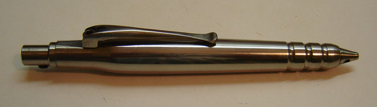

I am a bit upset about the lack of titanium though 🙂
its not as hard to work as they would like you to think especially if you machined drill stock!
I made this fatty pen from ti.
