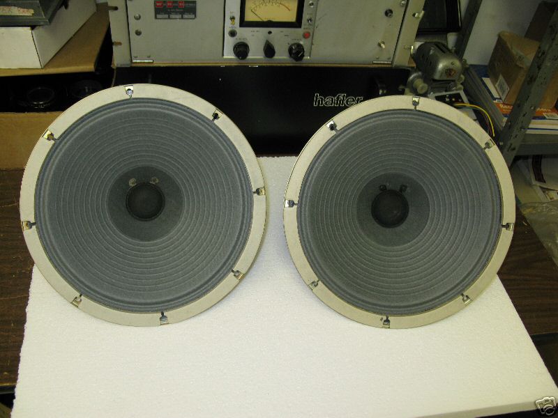

These appear to be the same inexpensive ones sold under the LaFayette and Olson brands here in the USA decades ago. If so, I don't have T/S specs, but according to my notes I wound up with a 60" high x 23.875" W x 14.75" D bottom exit TL that I fine tuned in-room by varying its gap to the floor. Driver was 24.875" down from the top. All dimensions are inside (i.d.).
From this we see can conclude that between the small magnet and my 12+ ft^3 cab that it has a high Qts, so today most DIYers would probably prefer a 3 - 4 ft wide OB if they have the room.

Hi GM, so did the floor-firing exit constitute a "port" somehow? Would it have been an MLTL? This height-adjustable bass response sounds like a unique design that would have some nice properties.
Unless I'm reading it incorrectly, the cab will have been open at the base, & simply height adjustable to provide a form of slot loading that could be adjusted to tailor things to the room.
Greets!
Right, you're creating a slotted vent. The 60" pipe by itself is good for low 50s tuning and mass loading brings it down into the 30s, which was all that was needed for 99.9% of all the available vinyl and tapes back then.

A driver like shown above is par for the course (maybe a bit above). Nice sounding, likely. Play with it!

I'm wondering if this speakers could be mounted in Onken like enclosure ?
You're welcome!
If my assumptions are correct, you could by making its size the same as mine, but then you would have to stuff it like mine and it probably wouldn't perform as good overall due to not being able to floor load fine tune it, so I don't recommend it without first measuring its specs to confirm what cab alignments it will theoretically work well in.

any updates on this driver?
I'm looking at these drivers too, and am wondering if there is any feedback on the sound? Are they nice? True ful range or do they need a tweeter?
I'm looking at them for an OB project with SE amps.
