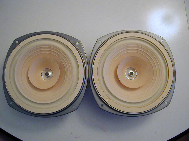

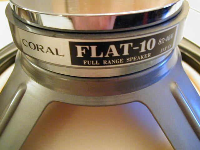

Hi everyone: I can get my grubby hands upon a pair of Coral Flat 10's for a fairly low price...and they are in sensational condition (????) however, what could I put them in?
Dave
Use the plans for the Coral Beta 10 cabinets as given in the East Marine website.. The 5-port BR cabinets works very well with the Coral Flat 10, Beta 10 and the quite rare Coral Alpha 10s as well...
Do note the highs on the Flat 10 are not as extended as the Beta 10... so you'll probably need to add a super tweeter..
