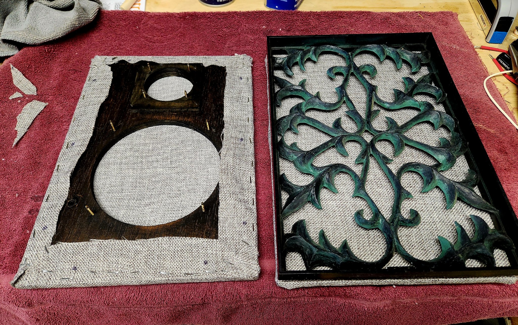

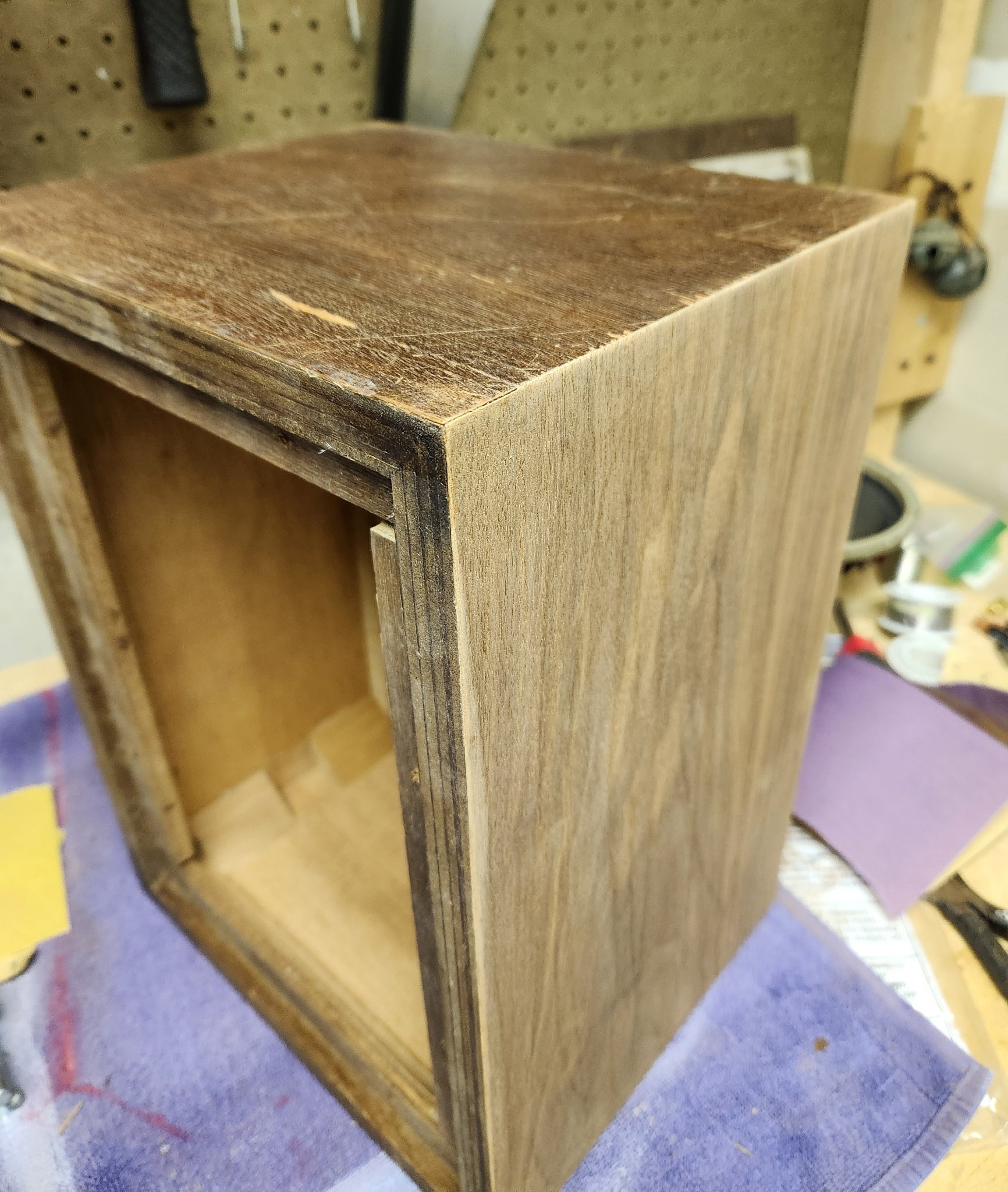

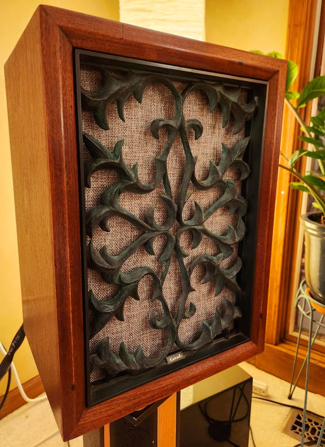

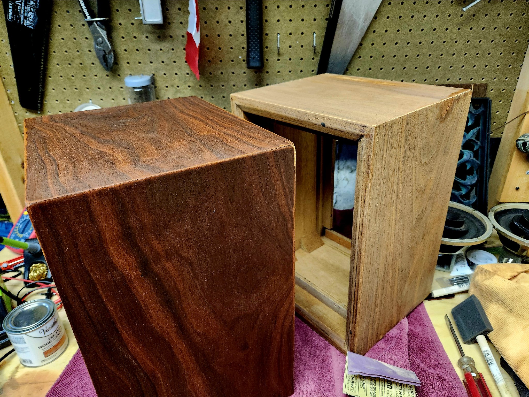

Hello everyone! Time to lazarus this thread as I've finally completed this refurb and build. Over the past two months or so I've refinished the cabinets and invested some time into basic speaker component knowhow, including continuity testing, measurements, and general familiarity.
I know members have said that these speakers are not worth the money put into them, but I did so for two reasons: one, because they are my father-in-law's and he bought them over in Vietnam back in the late 60s and it was my way of just kind of helping him preserve something that had been part of him during a difficult time. And two, it was a project that seemed fun to do and it would let me know whether I would ever want to do something like that from a kit from let's say Parts Express or other suppliers.

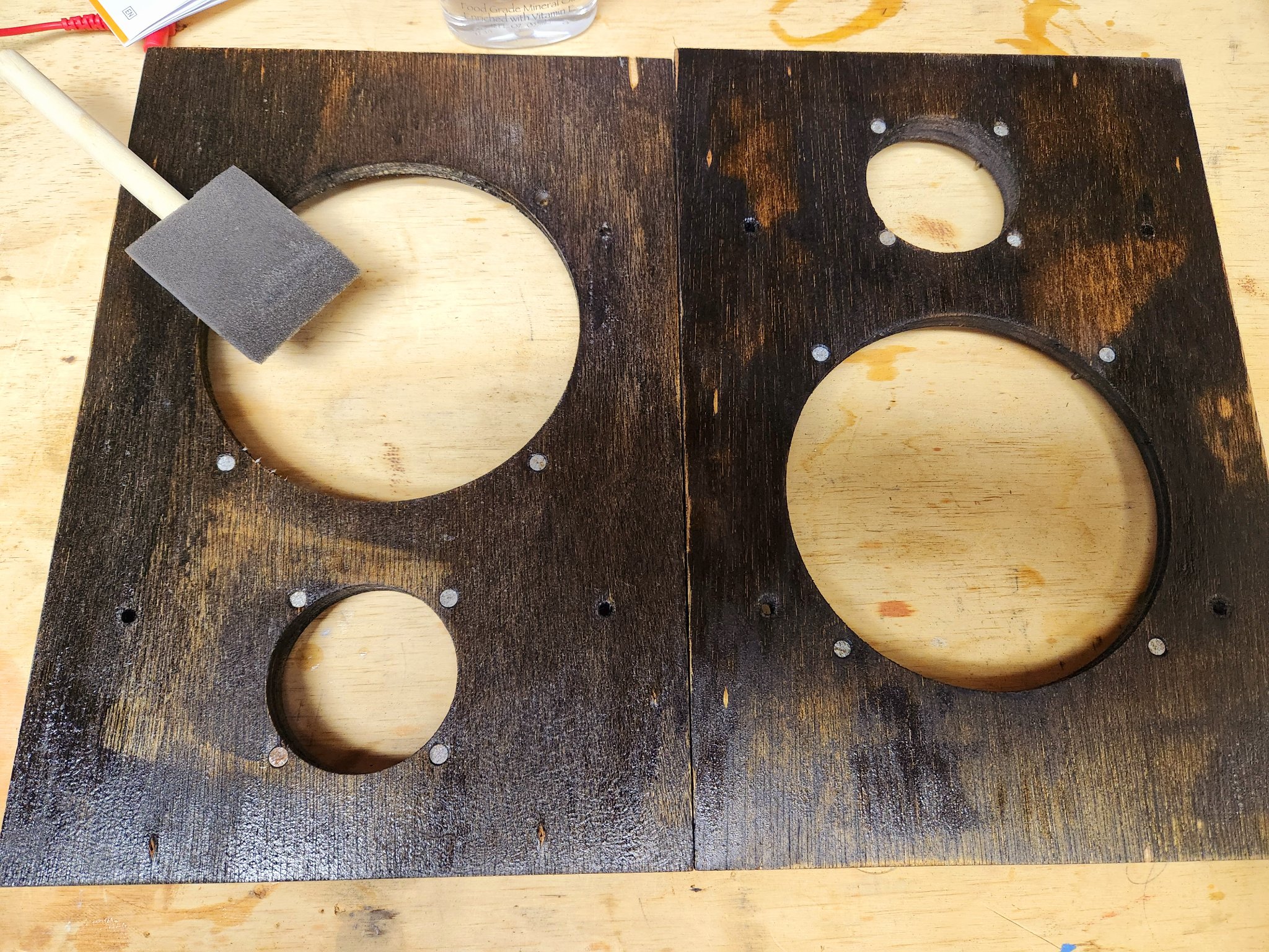

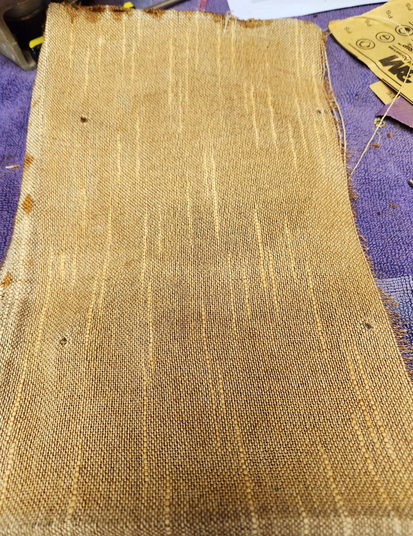

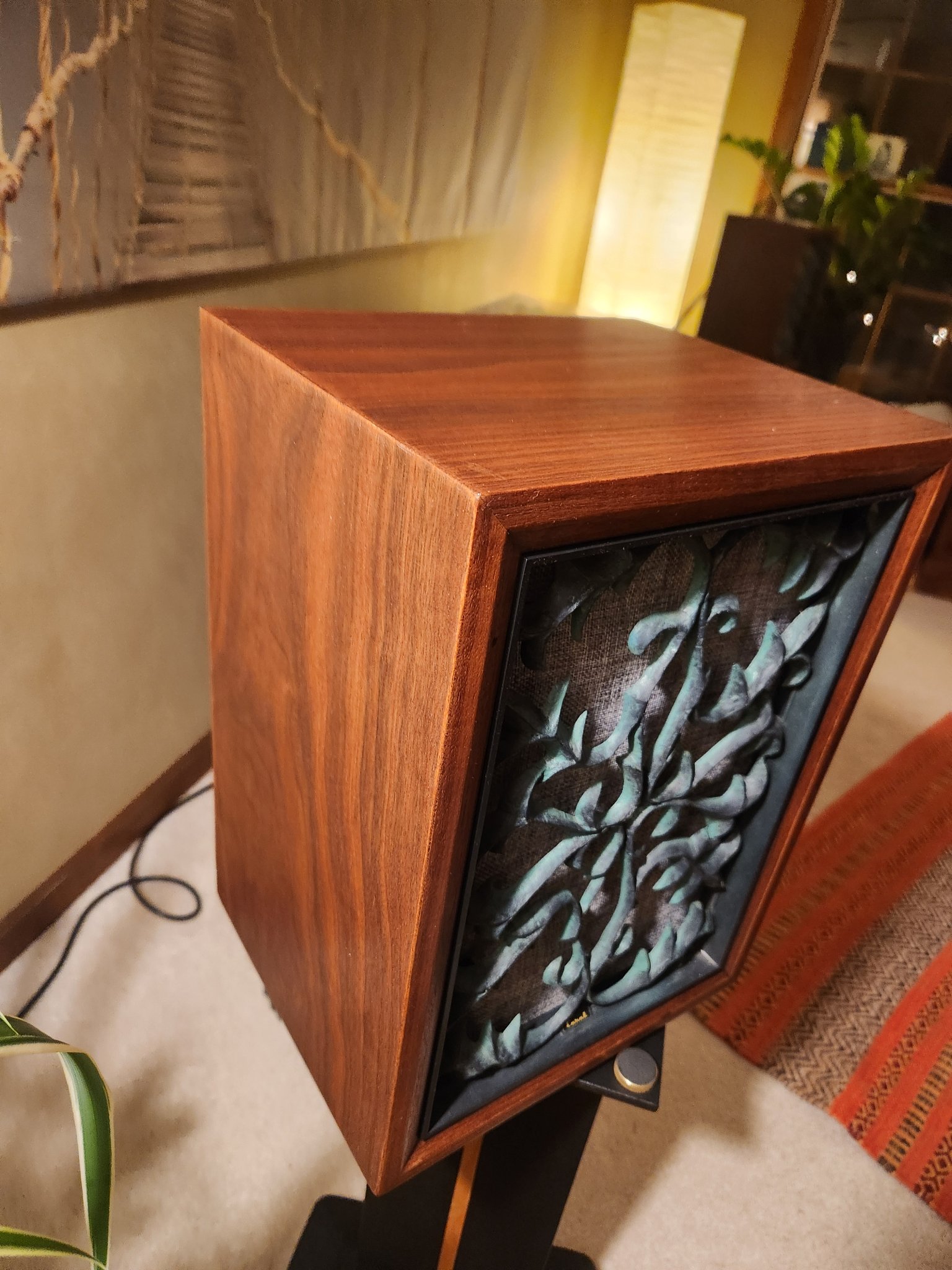

I've attached several pictures of the process including before and after of the cabinets, the baffles, and the burlap which was in dismal dried out condition.

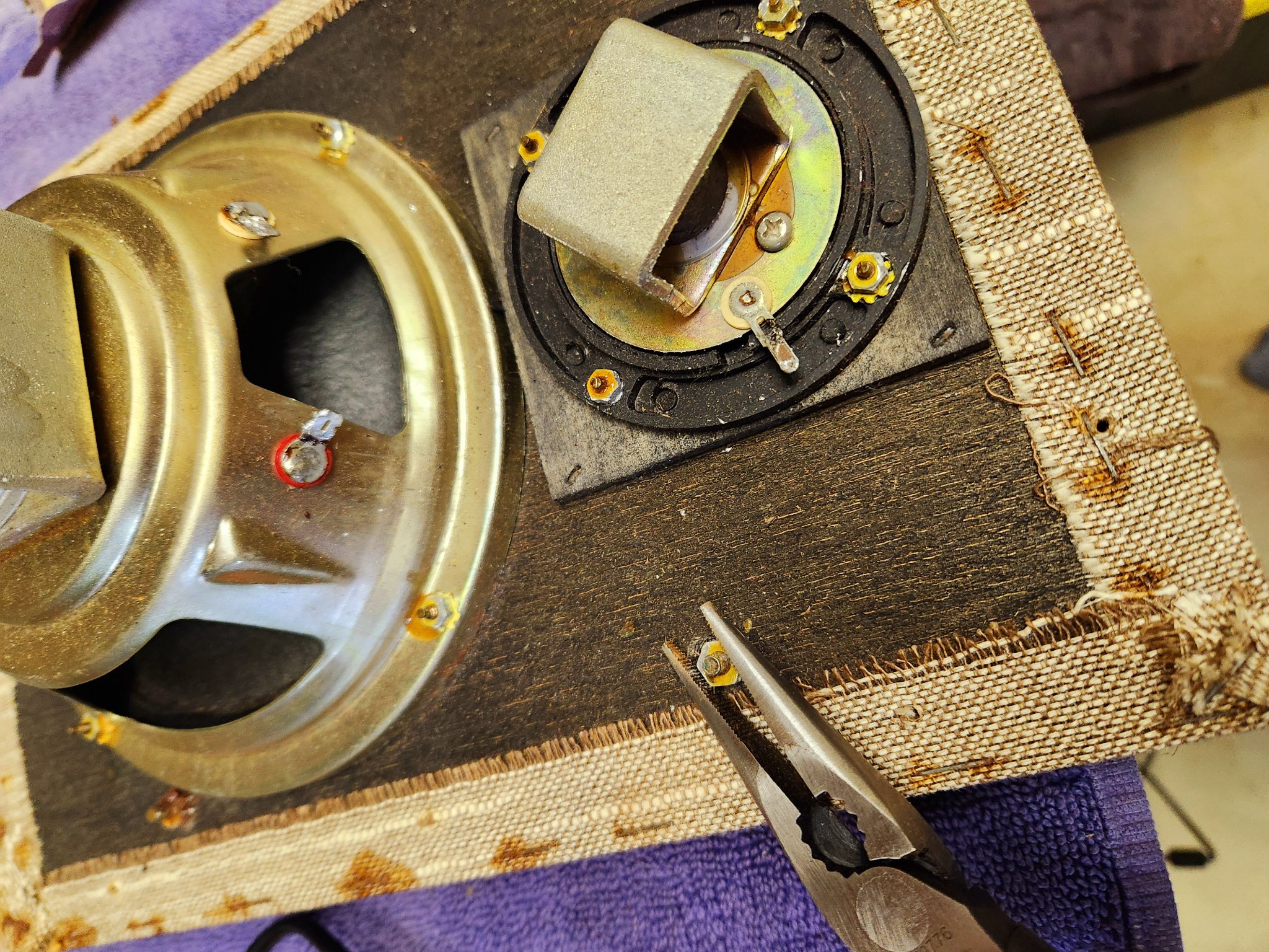

Baffles restored and oiled and with all 7323 staples removed
I cheated a bit and found another set of corals on eBay from which this seller kindly agreed to sell me the tweeters only for the same price as the speakers, which was about $40 total. The original, rear-mounted tweeters were impossible to find or anything modern like it.

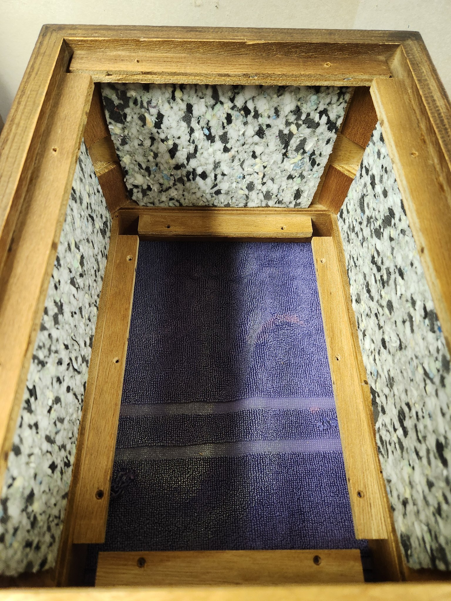

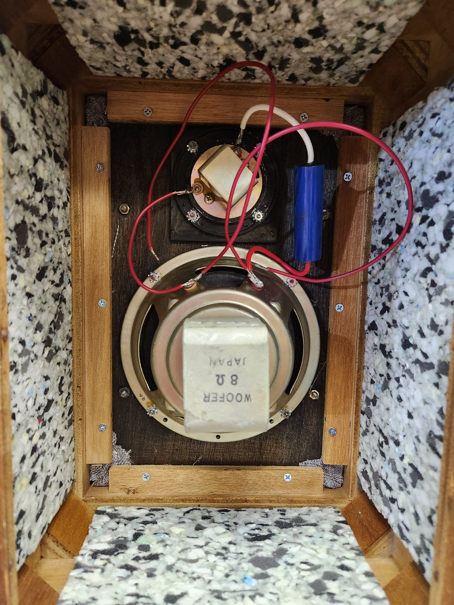

I replaced the capacitors with some new caps Parts Express recommended for upgrades. Not high end, but enough to make a difference. And since the original capacitors are now 50 years old or so it definitely made a difference. I replaced all the wiring and found out that my soldering skills are dismal but again, it was good to practice. I glued quarter inch padding to the interior sides and added about 3/4 of a pound of acoustafil to each cabinet.
Lastly, I upgraded the binding posts and was frustrated that my acoustic Zen hologram Spades were not wide enough for the posts. So I had to go through the bare wire holes with just half the spade. Interesting.

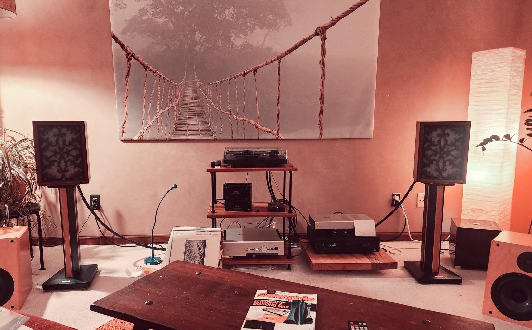

How do they sound? Well, like budget 50-year-old speakers. Especially after listening to my Reference 3A de Capos for so long. But they are clear and though a tiny bit muddy, they resolve well enough and Nick Drake sounds absolutely fantastic through them.
