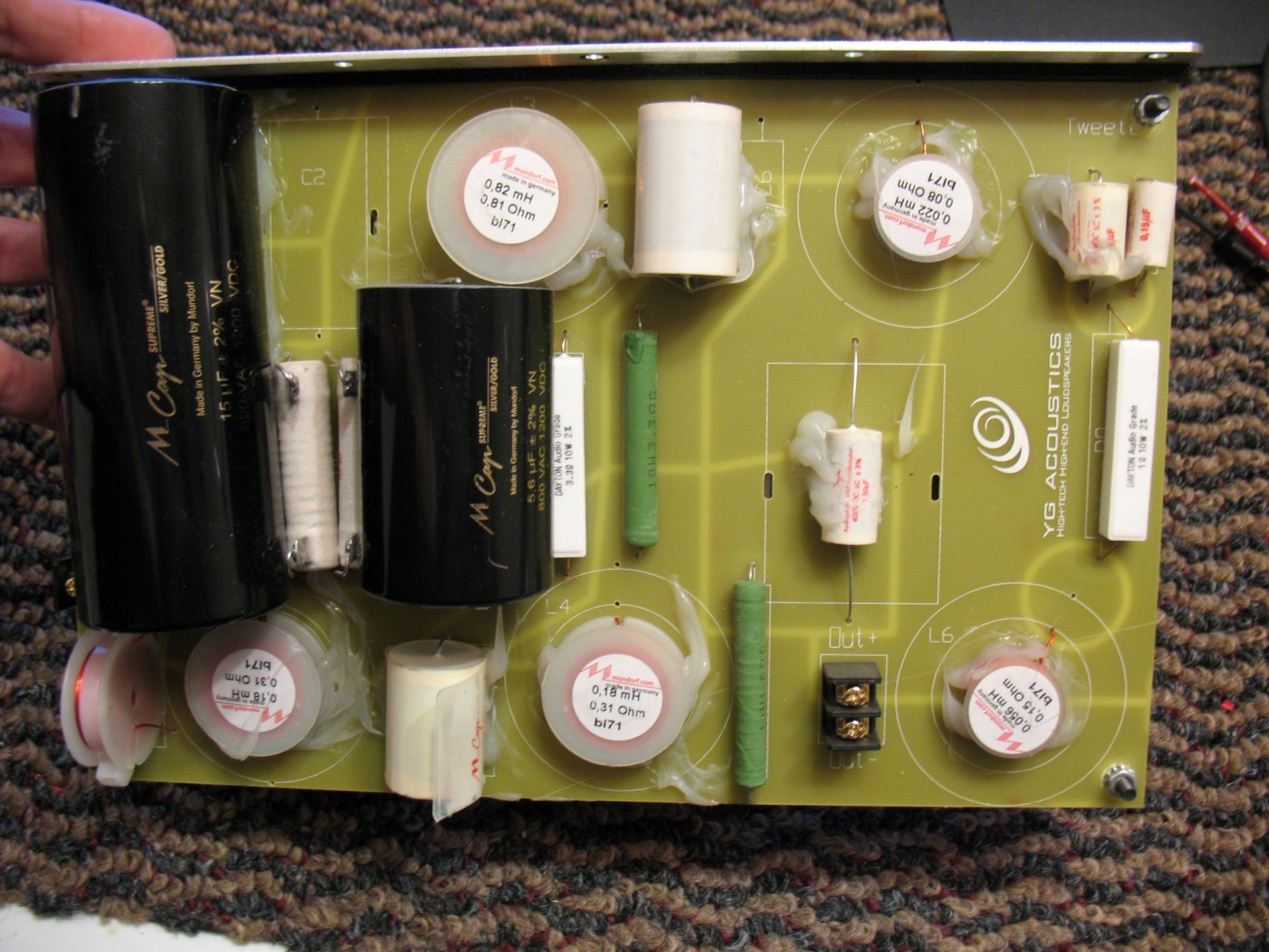

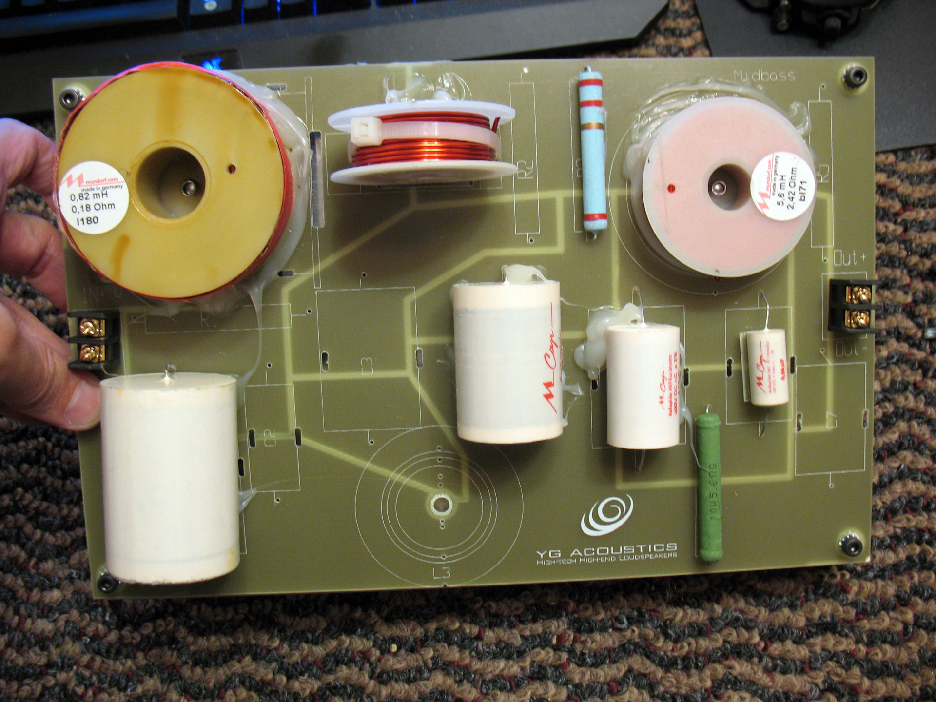

I think the crossover is a very key part of his design. As I mentioned before, its not normal. The part quality is really good and it seems to be a complex design. I think a lot of magic for these speakers is in the crossover..
The crossovers for the Sonja's and the passive bass module option for the Anat / Kipod's is amazing in its parts.
I attached pics of the mid-woof and tweeter crossovers. As I mentioned before they are separate boards and I feed them with separate amps.
