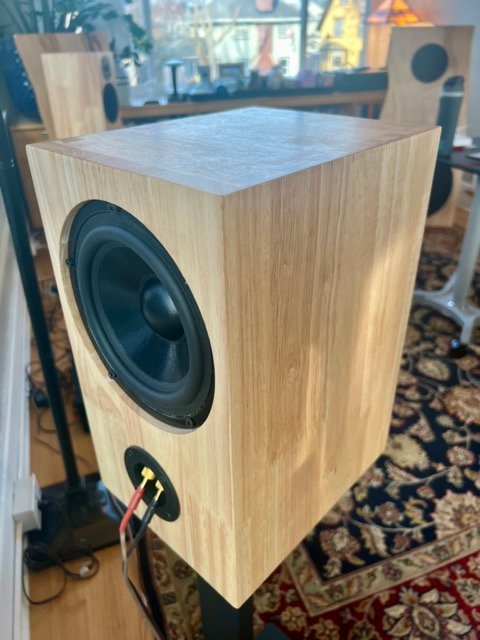

Perhaps it is irrational nostalgia, but if I can find the plans for the Accurate Sound model 7, I would like to build another pair, and so would a friend of mine. Falcon Acoustics from the UK is producing the original KEF drivers (with improved adhesives and insulation) and my workshop is a lot better than it was fifty years ago, so this is easy for me to do if I have the plans in hand.Why? I wouldn’t builkd any TL from before the time of, and modeled with a modern TL modeler by someone who knows what they are doing..
Indeed there are many designs like this. One of the best published ones from that era (available online) is B.J. Webb "A proven transmission line loudspeaker", Audio Amateur 1/1975 page 3 https://p10hifi.net/TLS/downloads/WebbTL-AA-1-75.pdfThis is not what you are asking for, but these 2 designs (Roger's Monitor and Atkins State of the Art) originally used the same speaker configuration. Both were excellent speakers. The bass of the State of the Art was clearly more extended on the low side.
However, my goal is to find the plans for the Accurate Sound model 7. These had a larger cabinet volume and a simpler divider concept to get the TL (one slanted board internally, rather than a baffle/labyrinth).
I'd be grateful for a link or citation to the work by King.Can't speak for Dave, but I'd guess the modeling he was referring to meant the work of M.J. King. Transmission theory from then to now has changed dramatically, and for the better. (This from someone who, years ago, built a trans line based on Bailey's now disproved theories using those same KEF drivers plus a Coles super tweeter.)

Although I am not familiar with the company Accurate Sound, from the picture in post 1 it looks asif - not for the first time- a smallish US speaker manufacturer basically made copies of the various 70ties British TLS designs as published in WW, Hifi News, Practical Hifi etc. etc. and sold in kit form. The early years of Speaker Builder contained comparable ad's by US "cottage industry" manufacturers.

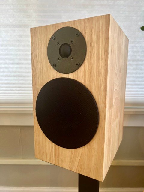

Well.... If this were my project, I'd go for an Accurate Sound Model 7 "2.0." I'd build a HornResp model incorporating Martin King's best TL practices and alter the internal cabinet geometry to cancel the "Fbx3" second resonance of the TL.
I'd see if I could lay my hands on the Tang Band W8Q-1071 12"x8" subwoofer instead of the B139; and instead of the B110 I'd use a Focal 5N401, 5N412, 5N411 or 5N412; and instead of the KEF T27 I'd pick one of SB Acoustics 21mm domes. Or if it needs to be vintage, the Audax TW025.
VItuixCad and measurements to dial in the crossover.
The end result will have a strong family resemblance, and honor the original idea, while picking up major improvements.
Most of my "nostalgia projects" have approached things this way, and I've always been extremely happy with the results.
