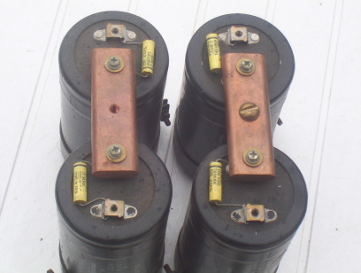

here is a pic
good thinking, i was using some of the TechSpray stuff myself to prevent tarnishing. u may still want to use a chemical-based cleaner in addition to scotchbrite, i also highly recommend a contact enhancer such as Caig Pro-Gold. applying a little squirt to the contact area before connection can go a long way to improving long-term conductivity... i find it works very well.
I thought of using .25" aluminum scraps from my chassis. The terminal bosses on computer type caps all seem to be aluminum, so using an aluminum bus bar would reduce the possibility of corrosion in that junction. I know it would move the problem to the terminals connected to it, but those are more visible and serviceable. What are your thoughts guys?

That's the question I have with using copper bars to connect Aluminum cap terminals. Seems the aluinum scraps would be better, but you still have to connect to copper wires. What would be the best way to do this?
The threaded bosses on my caps all seem to be aluminum. They're certainly not brass or copper, and I doubt that they are silver. They're too soft to be stainless, and they don't rust, and they're not magnetic, so I'm assuming they're aluminum. That's what type of metal electrolytic caps are made of, isn't it?
Dorkus, I was refering to computer grade caps with screw terminals.
I see the terminals in the above pic would seem to be folded out of tinned copper sheet, but my large Sprauge caps have solid aluminum bar thats threaded for a screw sticking out the top.
